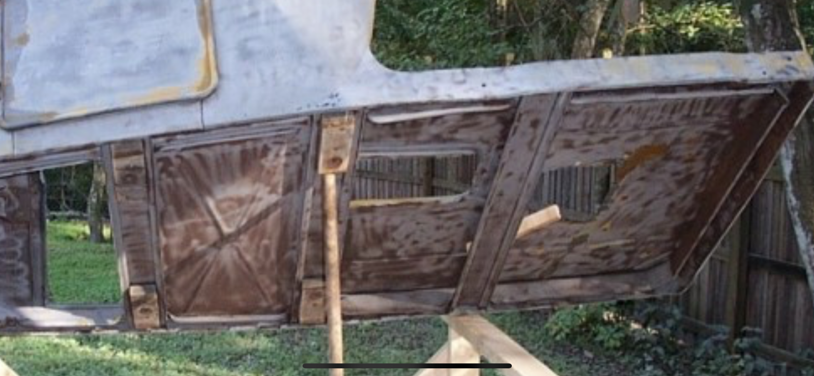

Hi All,
I’m still confused as to how the body blocks sit in the channels under my 27 touring. Does the rabbitted cutout face up or down? Do the blocks attach to the body before dropping the body? Something so simple seems confusing. I didn't take this part of the car apart so there was no photo of the originals. I’ve searched past posts and can only get a few fuzzy photos that really don’t show what I’m looking for. Your help is appreciated.

Brent,
The "notch" goes up and out to clear the rivet heads fastening the body cross members to the body frame rails.
They are held in the body with a flat head wood screw down from the top into the blocks.
Underneath the splash apron screws with washers to the blocks to secure the aprons.

Thanks all. I think I have it figured out.
I’m just still not sure how they are attached to the body so that they stay in place while we lift the body.
Are they screwed to the rails in some way?
I can’t find any holes where wood screws would attach them to the body prior to installing body in chassis.

By 27 guess perhaps no screw holes in subframe, so just insert the blocks and body bolts on the body to frame brackets will secure the blocks.
On this early 26 runabout the blocks were screwed to the subframe channels.
And use screws to secure the splash shield edges to the blocks to reduce the gaps and prevent rattle.

On the early '26 touring the blocks are screwed Into the subframe / crossmember with 1 wood screw from the top.
The screw is located just outside the body bolt hole and just inside the rivet holes.
It could easily be mistaken for a rivet hole since it is right there next to the rivets.
The screw goes into the thicker (non rabbeted) part of the block to hold it securly.
