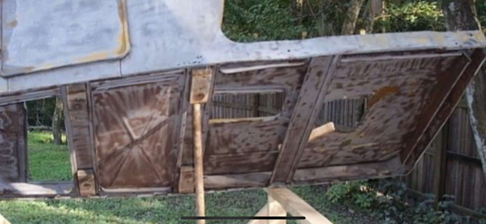

Hi All,
I’m still confused as to how the body blocks sit in the channels under my 27 touring. Does the rabbitted cutout face up or down? Do the blocks attach to the body before dropping the body? Something so simple seems confusing. I didn't take this part of the car apart so there was no photo of the originals. I’ve searched past posts and can only get a few fuzzy photos that really don’t show what I’m looking for. Your help is appreciated.
