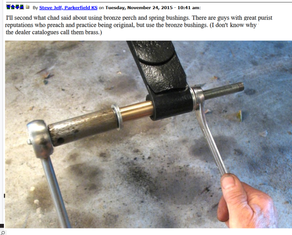

A bushing driver works nice. You may need to ream the bushing to fit the shackle. I would suggest brass, not a steel bushing.

additionally I used the steel bushings, I hear Brass or Bronze ones were original or better, Ill keep that in mind for the future.I like buying from langs but the only bronze bushings i see are some for some part of a ruckstell, Ill have to see where I can get them from in bronze, maybe the other retailers.

Make your own from an over sized bronze bushing.LittleTimmy52 wrote: ↑Wed Sep 03, 2025 7:02 pmMy rear spring bushings on one side it looks like the spring hole for the bushing is too big as the bushing went in and out with hand force, as in I can pull it out, this would defiantly spin with use, how might I stop it from spinning?
- Posts: 6874
Re: Rear spring questions
Bearing shops here carry bronze bushes to suit. i can buy one with greater wall thickness, so it can be turned down for a custom fit as John suggests. Do you intend to re-fit worn shackles? New replacements may need reaming the bushes to fit.
