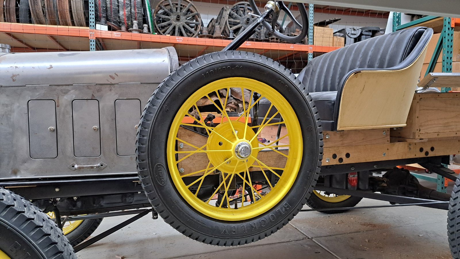

Post by Mark Chaffin » Fri Feb 28, 2025 3:08 pm
I thought I would share a couple pics of the Ranch Doodlebug build. Engine and Ruckstell are done. A huge shout out to Mr. Hank Lee for rebuilding my Zenith carburetor as I know it has been done right and also for modifying my Winfield intake manifold to ensure a proper fit. Hank is indeed an artist. Thanks Hank!

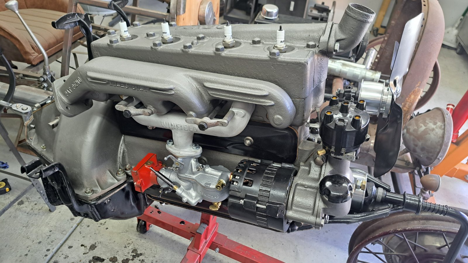

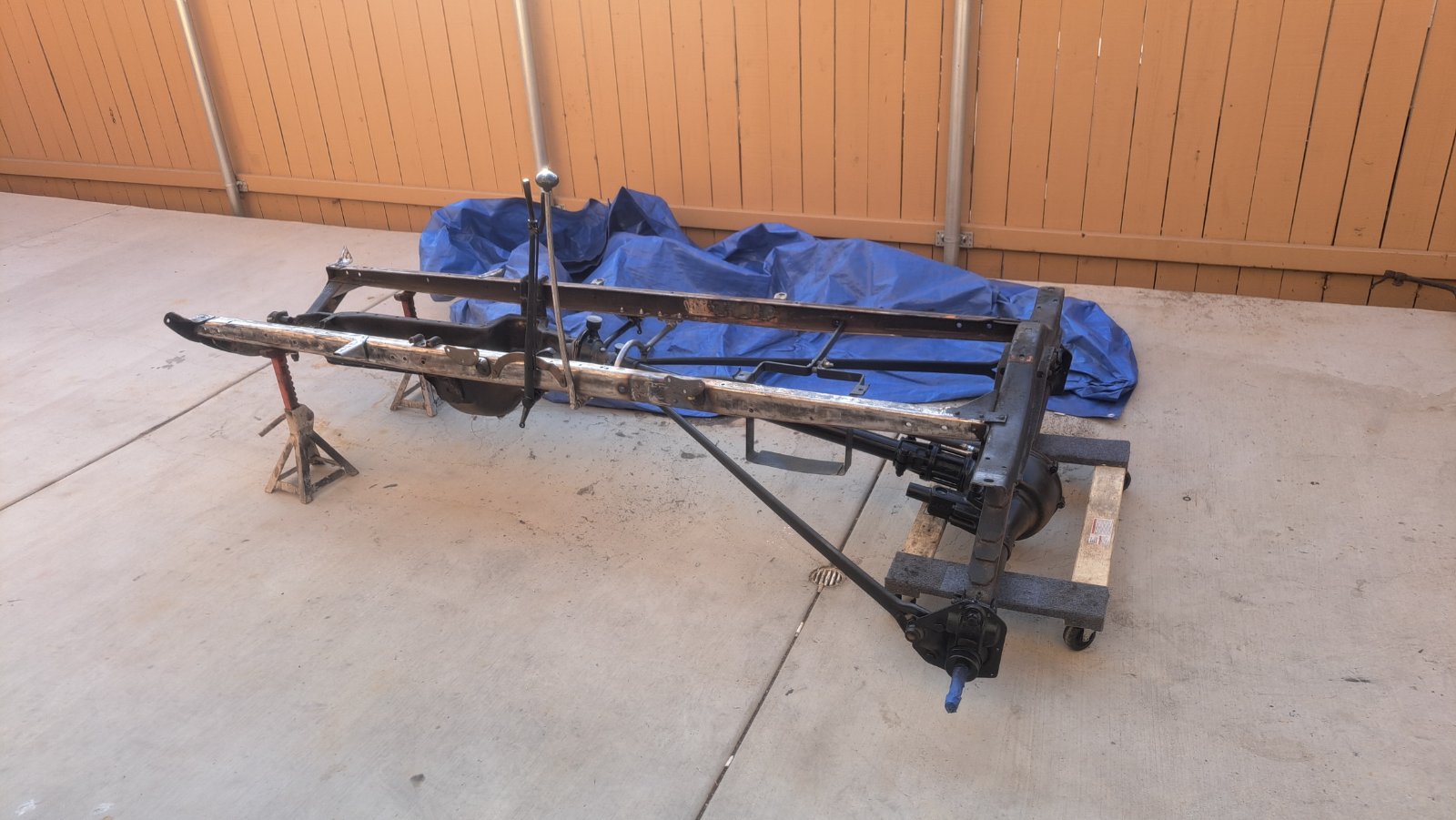

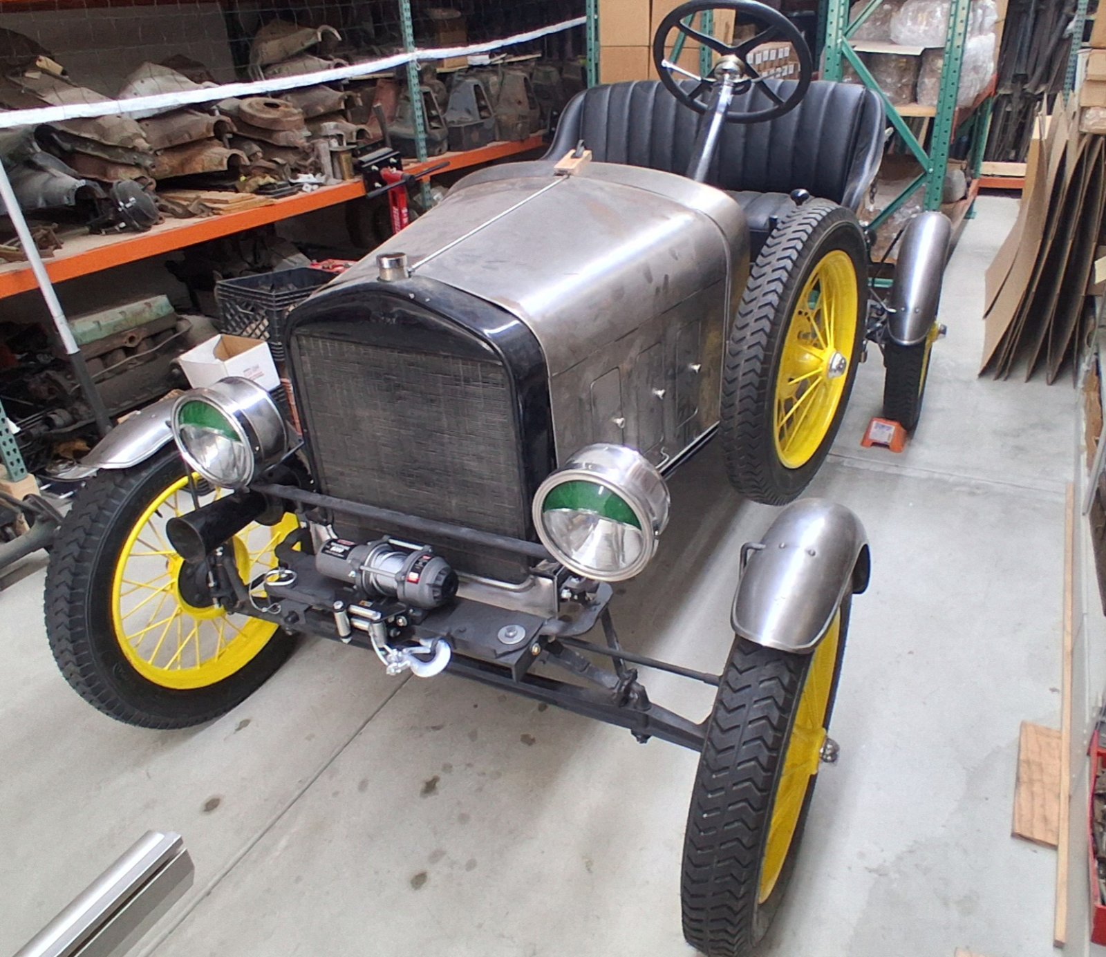

Post by Mark Chaffin » Wed Mar 12, 2025 7:38 pm
Frame shortened 12 inches as well as driveshaft.
Aussie16
Posts: 283
First Name: Warwick
Last Name: Landy
Re: Ranch Doodlebug Build

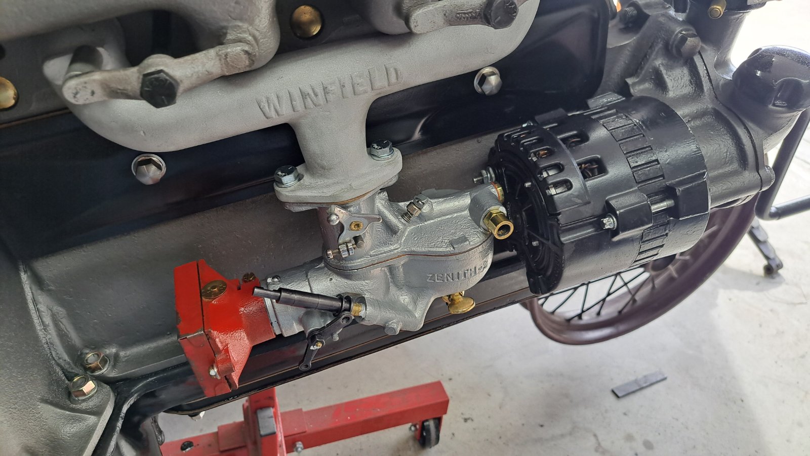

Post by Aussie16 » Thu Mar 13, 2025 7:14 am
What head are you running there Mark? It looks pretty chunky?
Mark Chaffin
Posts: 4852
Last Name: Chaffin
Location: Lake Elsinore
Post by Mark Chaffin » Thu Mar 13, 2025 10:16 am
The head is a cast iron original TURBO. I've only seen one other in my travels.

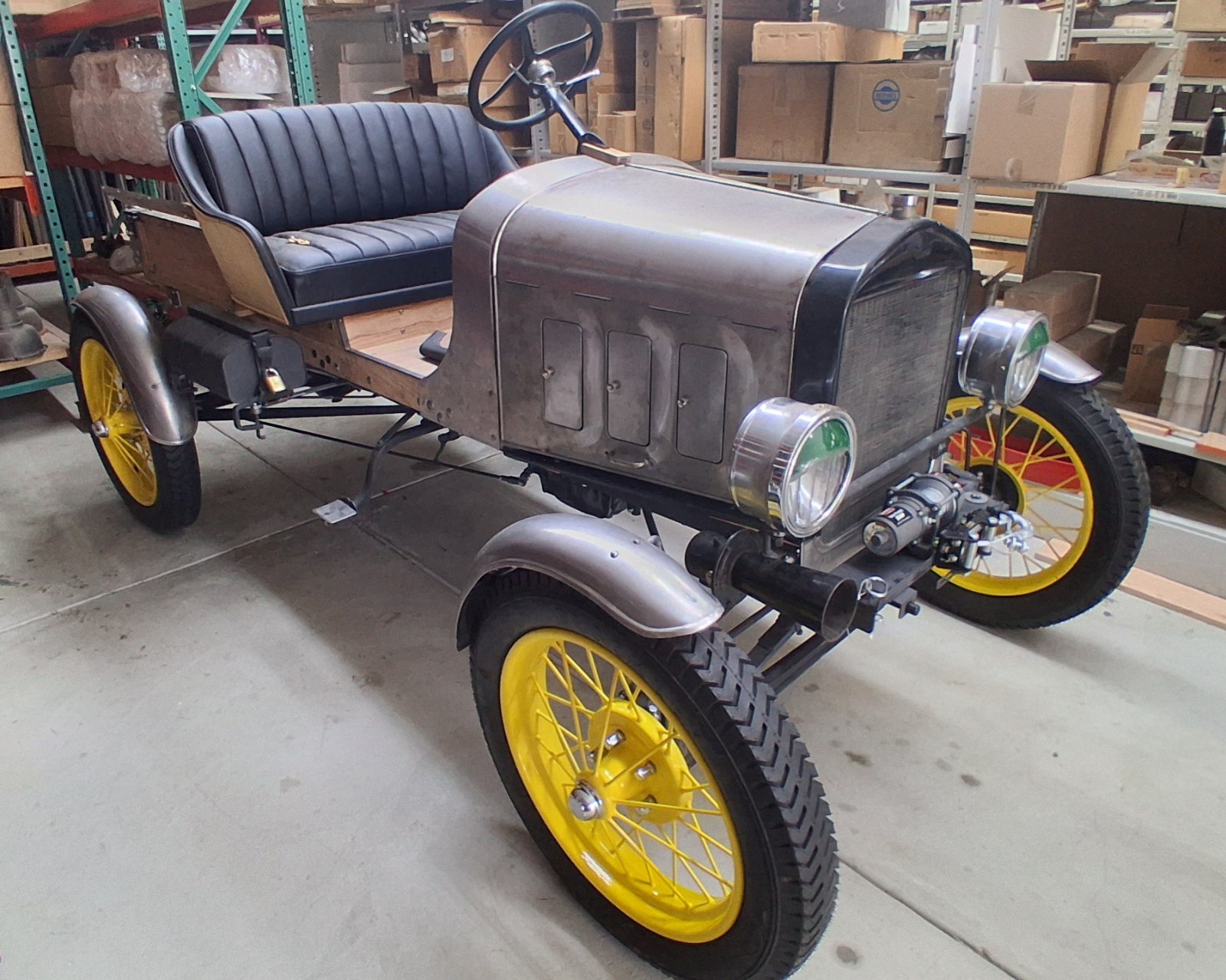

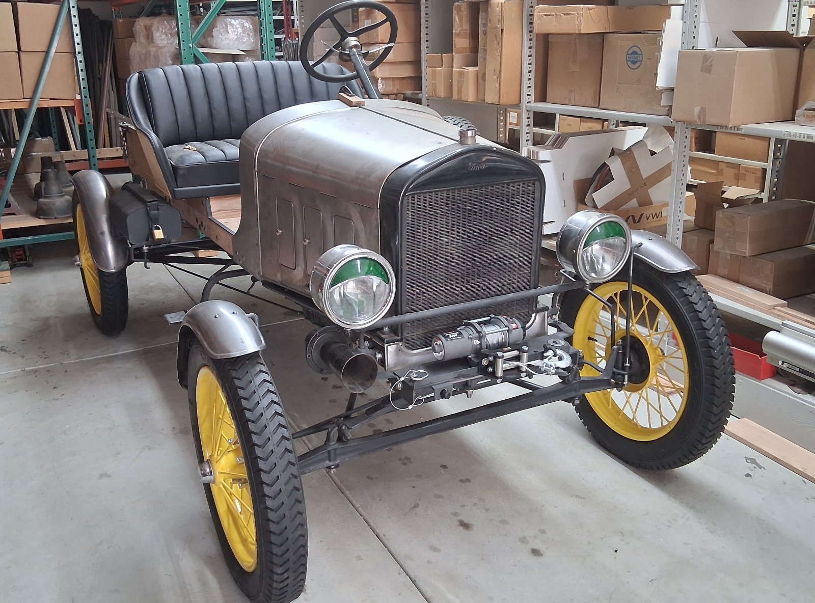

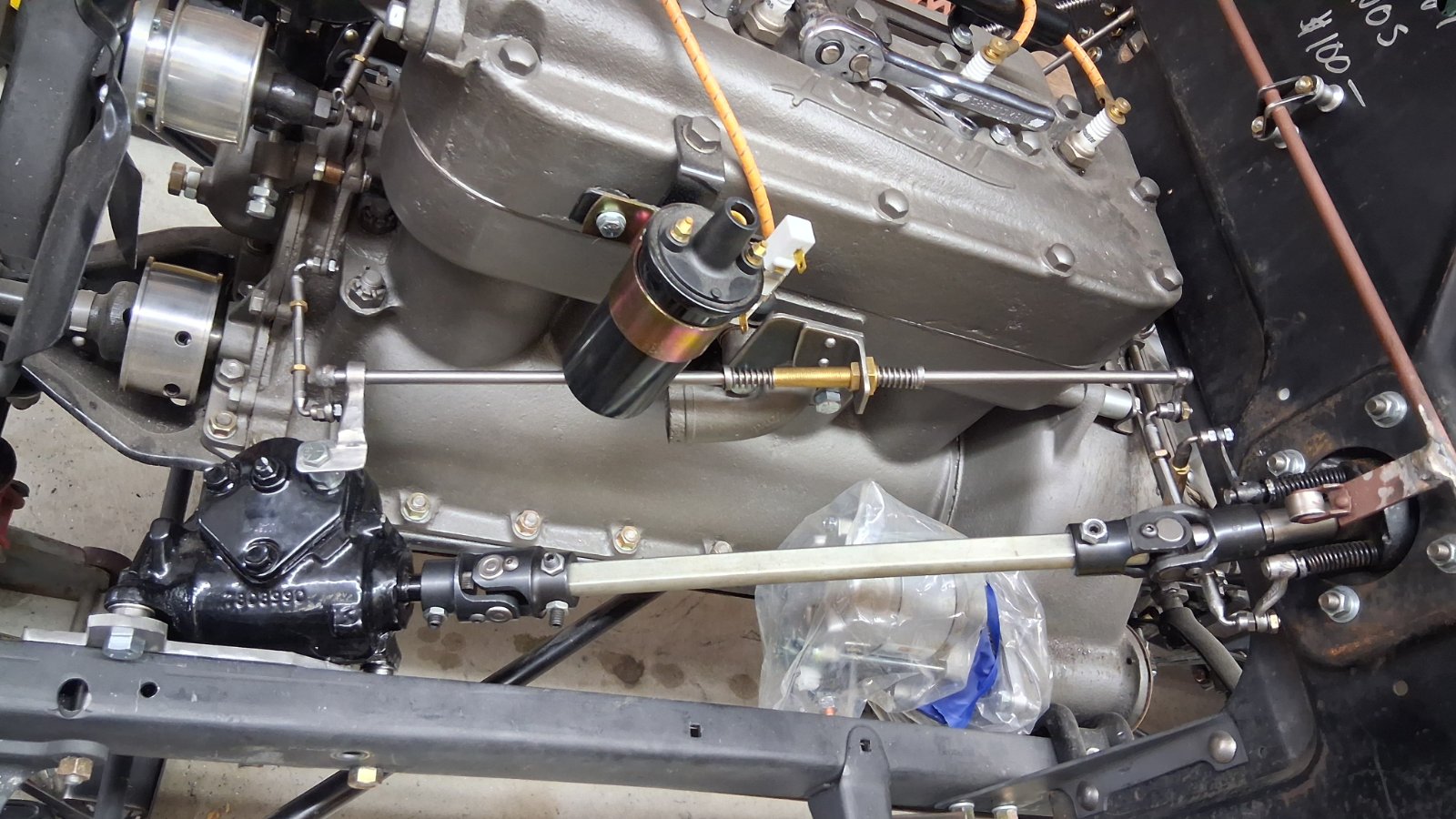

Post by Mark Chaffin » Wed Jul 30, 2025 8:22 pm
Moving right along!

Ed Fuller
Posts: 896
First Name: Ed
Last Name: Fuller
Location: NJ
Board Member Since: 2012
Post by Ed Fuller » Wed Jul 30, 2025 9:02 pm
Nice work Mark! I really like the hood you are using.

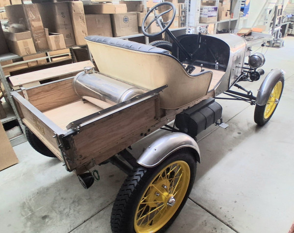

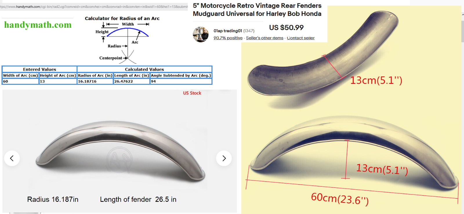

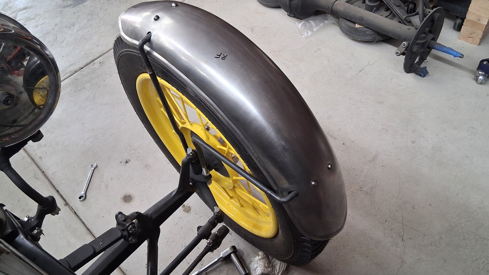

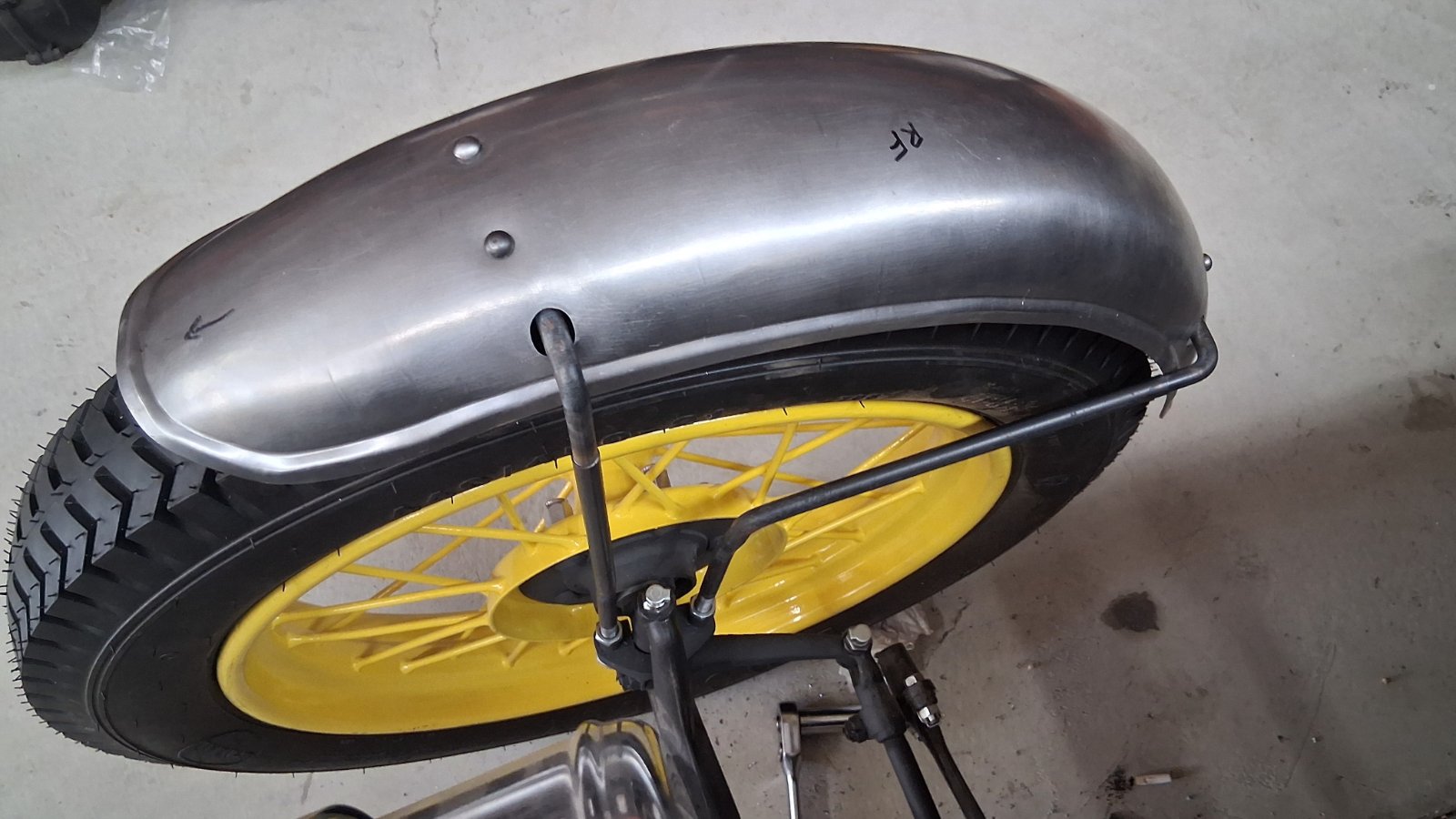

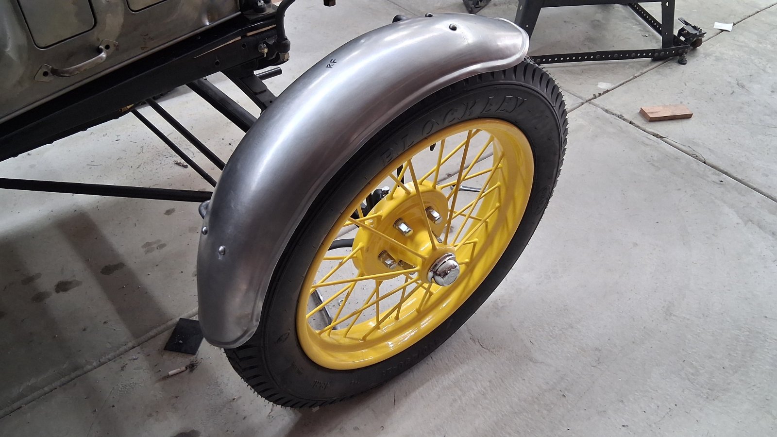

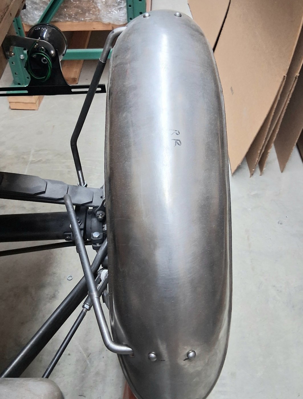

Post by Mark Chaffin » Sat Aug 23, 2025 9:24 am

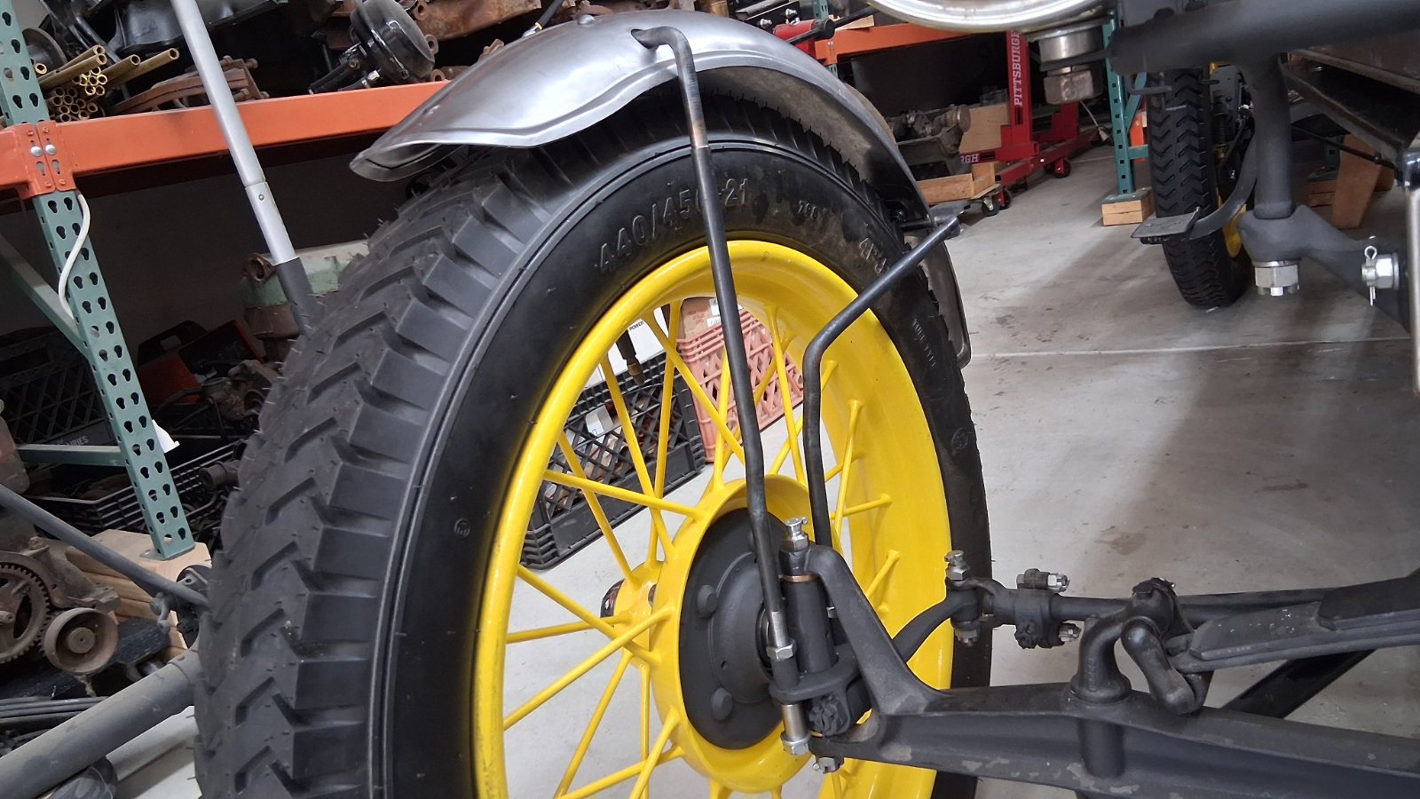

Installing cycle fenders and brackets.
Post by Bills Auto Works » Sat Aug 23, 2025 12:50 pm
Hey Mark,
That thing is coming along nicely from when I was there a few months ago! I don't know whether to be happy for you that you are making major progress or sad for myself since I can't seem to make any on my stuff. LOL I guess both! :roll:

Posts: 1220
First Name: Adrian
Last Name: Whiteman
Post by A Whiteman » Sat Aug 23, 2025 5:17 pm

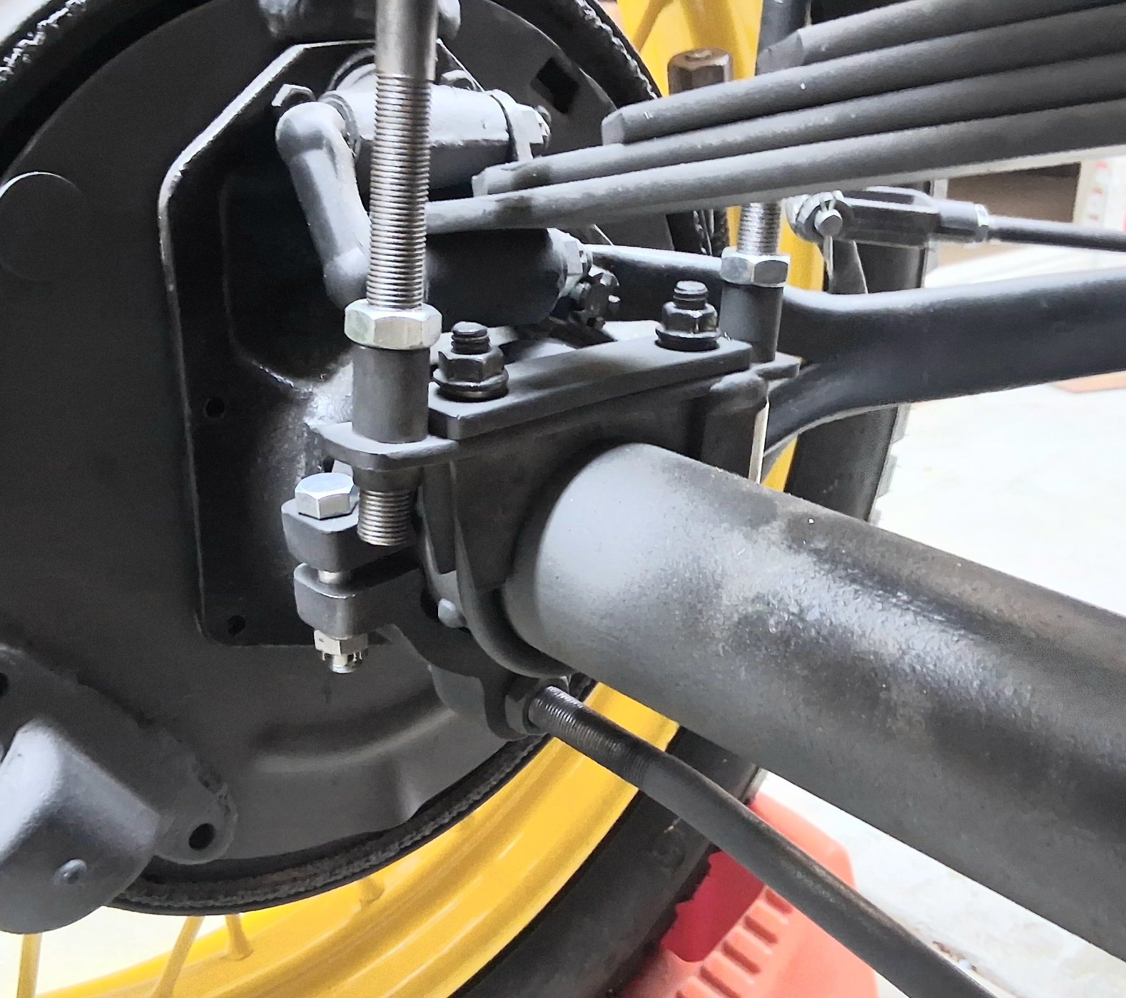

Thanks for the pictures mark, looking good.

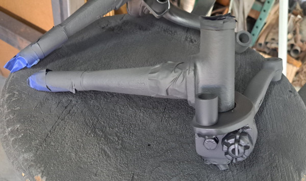

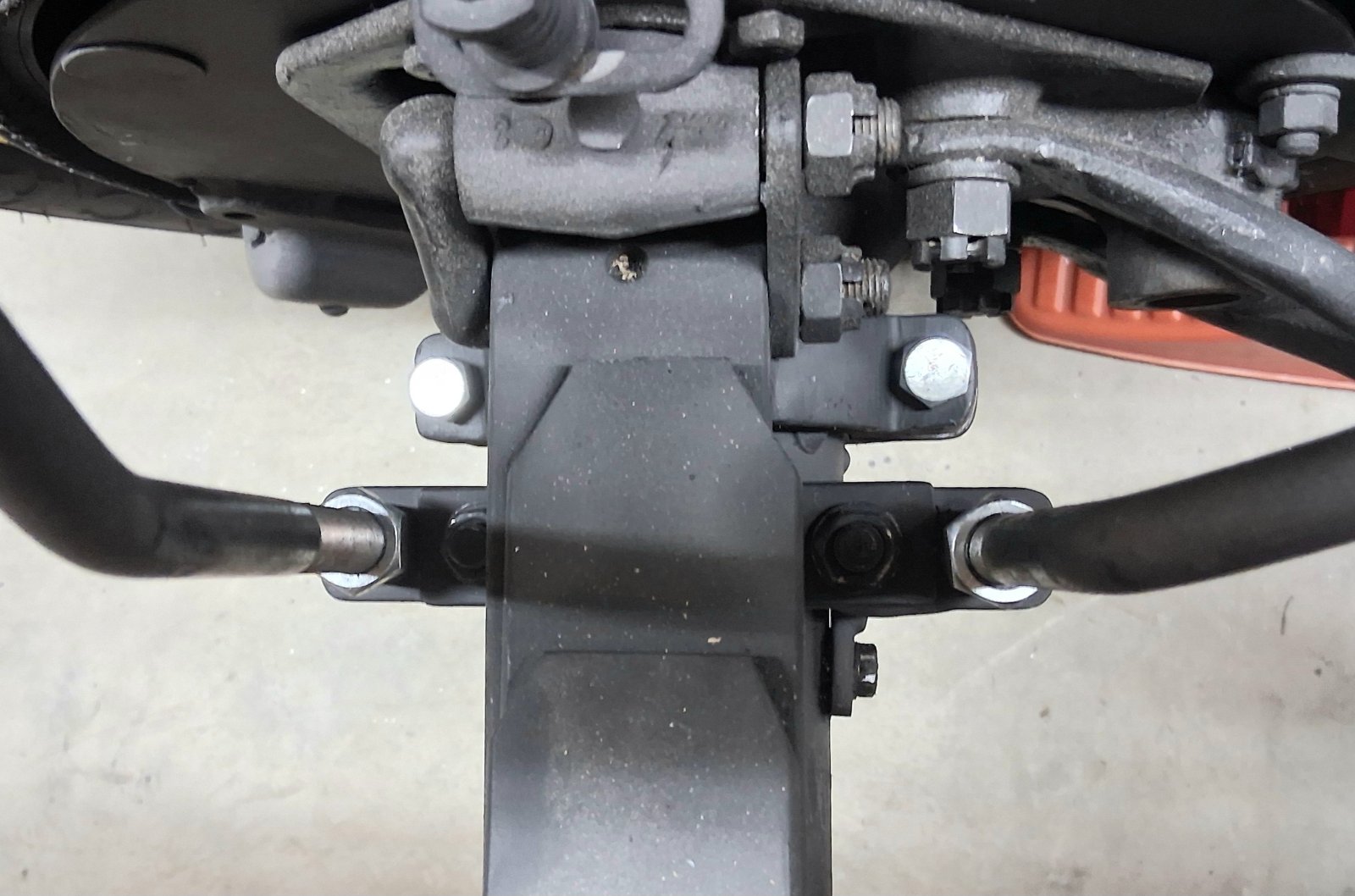

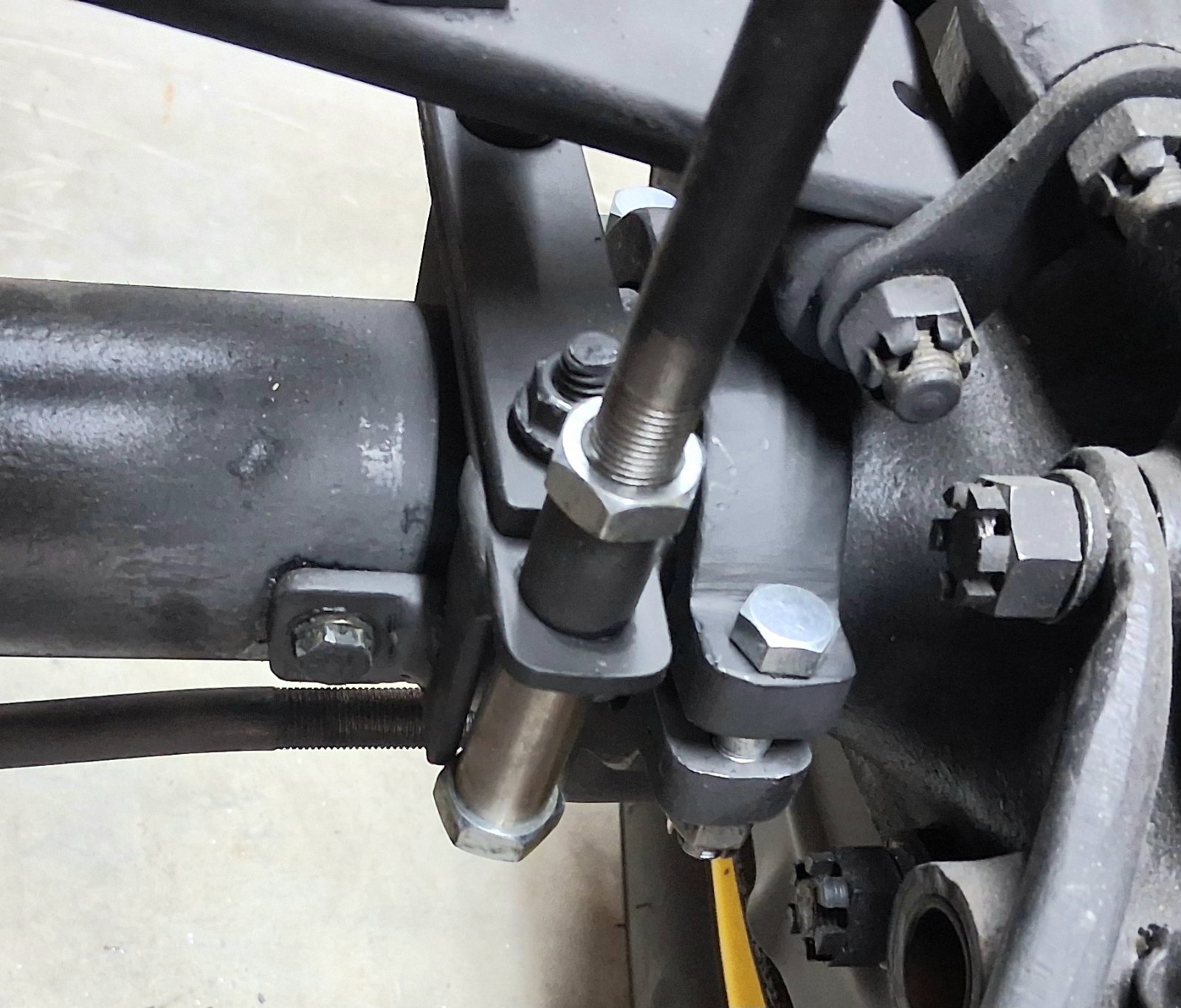

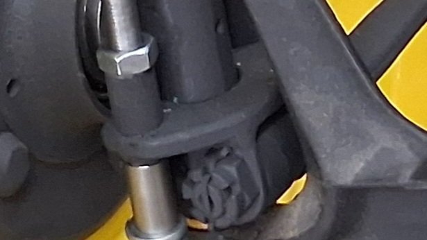

Did you make the cycle guard mounting brackets? They are very neat and I am curious how they fit and how they are braced.
Would you mind sharing a few more details??
Thanks again
Adrian
Mark Chaffin
Posts: 4852
Last Name: Chaffin
Post by Mark Chaffin » Sat Aug 23, 2025 6:01 pm
Yes. The spindle brackets were made by hand. With two tabs welded on the plate to be mounted using the spindle arm. The spindle arm boss and nut were machined down 1/8" each to allow clearance. The rods are cold role steel threaded 1/2-20 at 4" Length for adjustment. The opposite end was turned down on a lathe to .425 for the fender eyelets. Once the brackets are attached to the spindle, a 1/4-20 short bolt was added front and rear to prevent the bracket from rotating. A few more pictures have been added to illustrate further.
Posts: 1220
First Name: Adrian
Last Name: Whiteman
Post by A Whiteman » Sun Aug 24, 2025 3:35 am
Thank you, that is a clever solution! I will salt that idea away :-)

I guess it pretty much is a complete car. Just 12" shorter. Since we're located in California, I can safely say, it identifies as a Doodlebug. Pronouns are Putt and Putt. :)

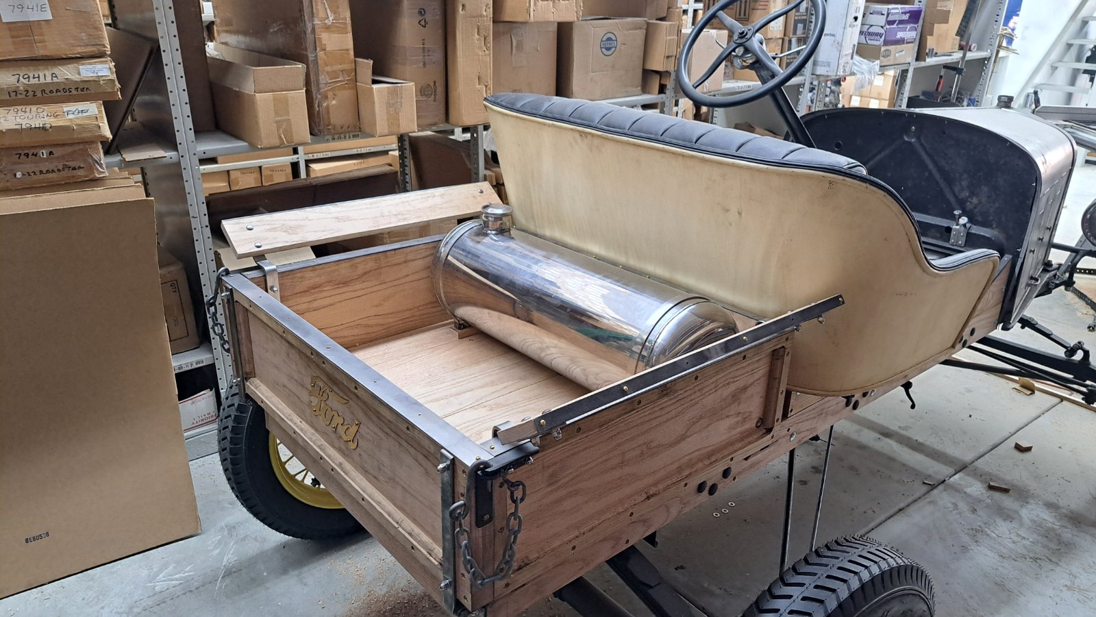

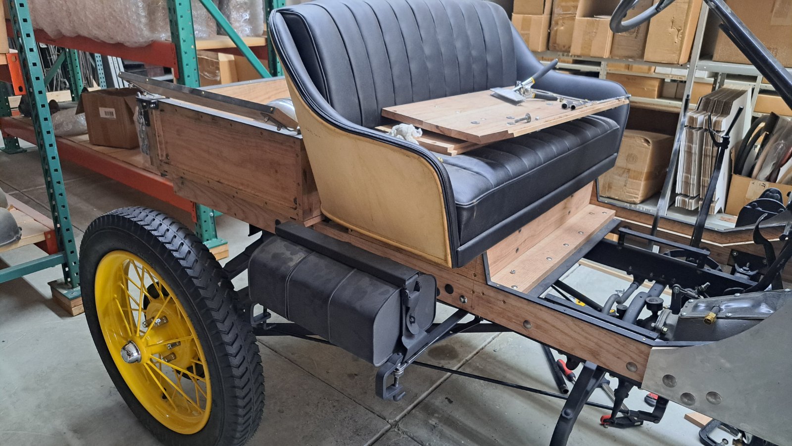

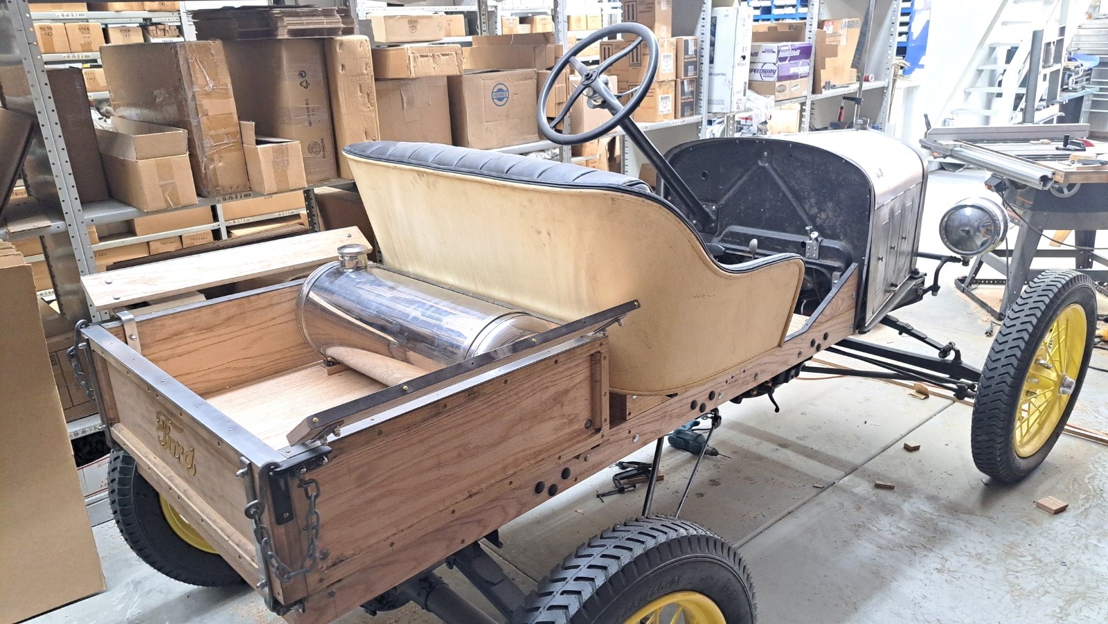

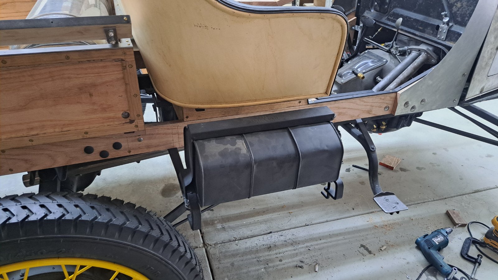

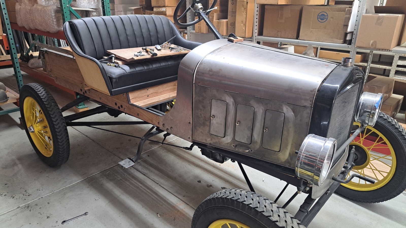

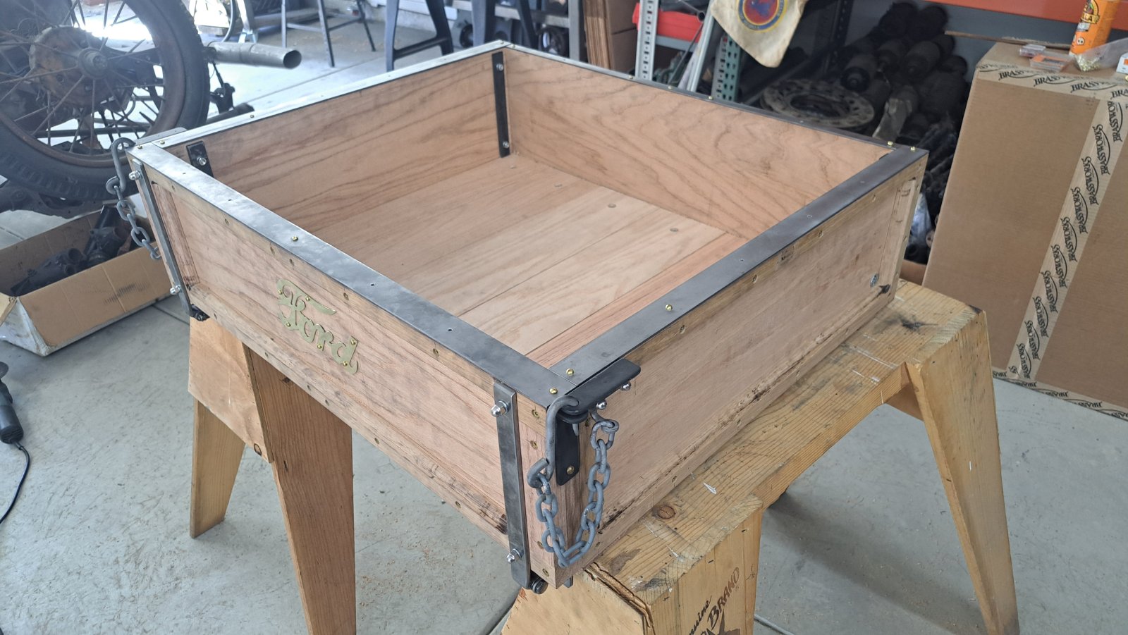

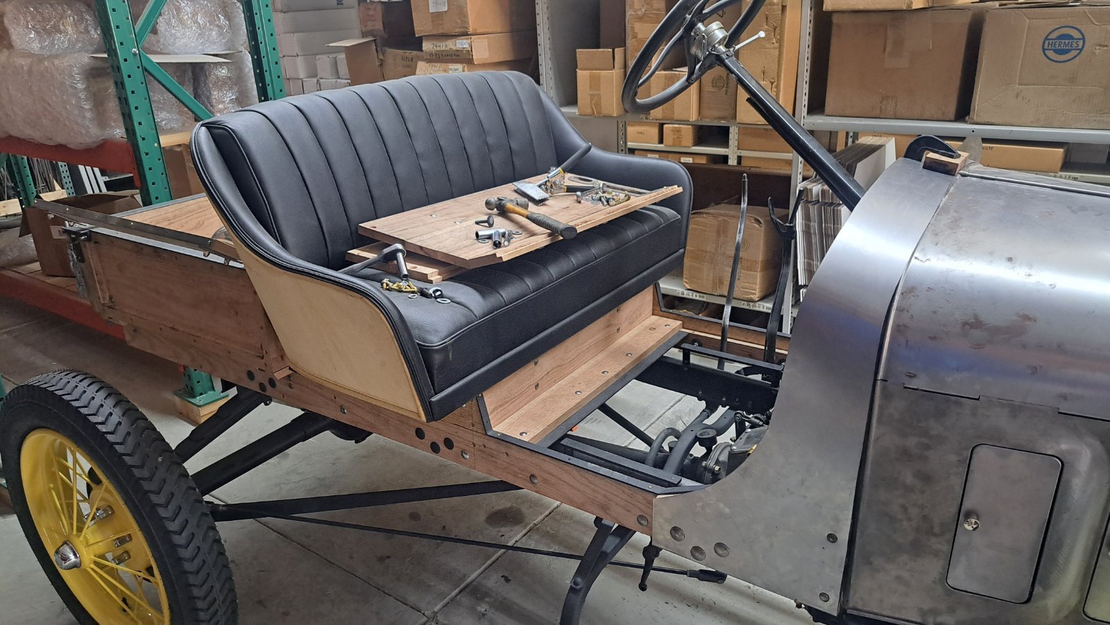

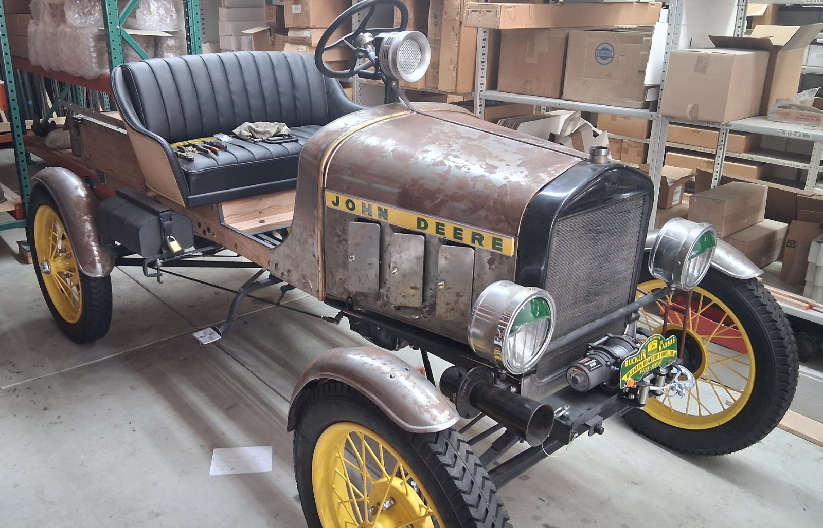

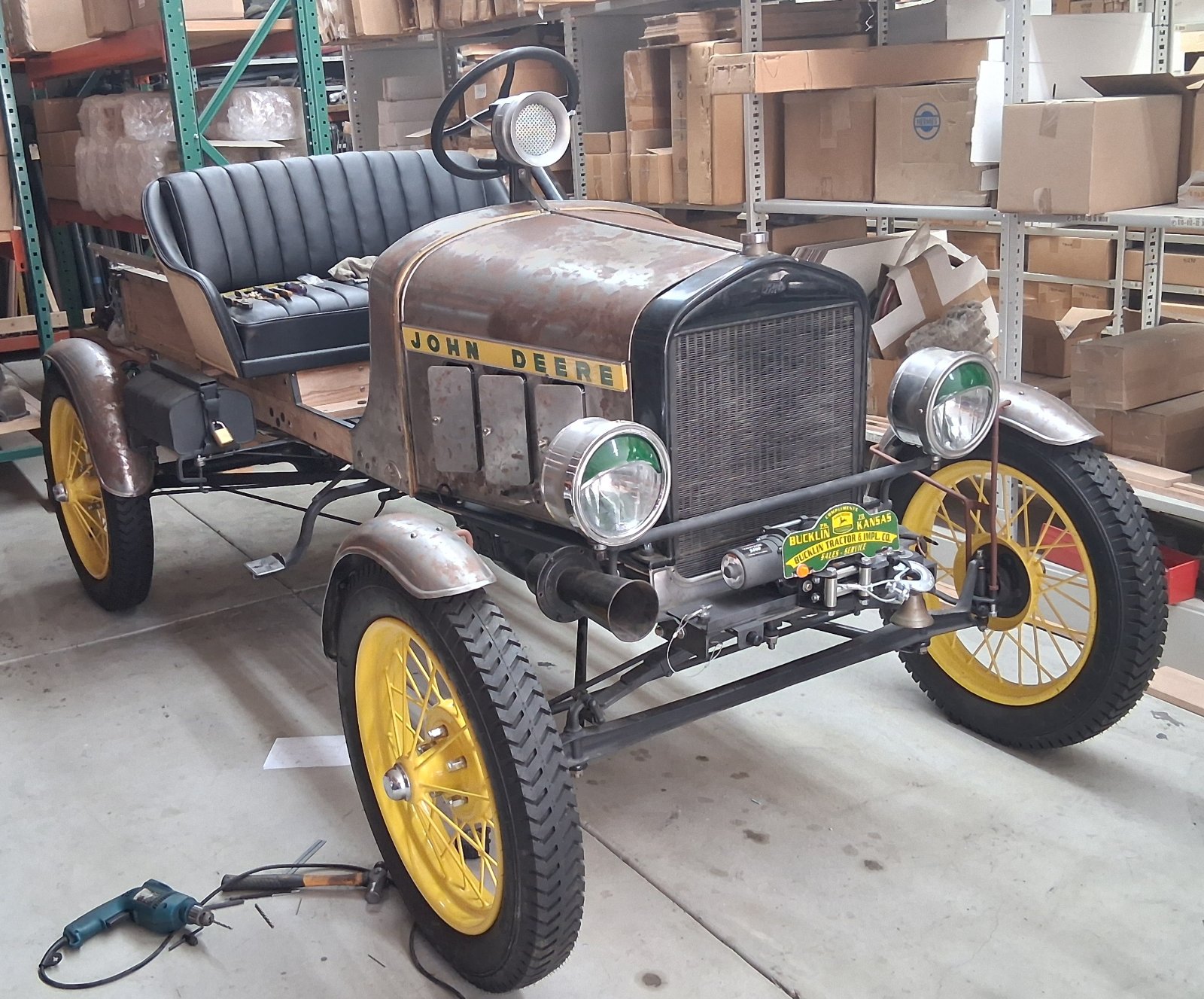

Post by Mark Chaffin » Tue Sep 02, 2025 6:27 pm
More progress. Almost ready for paint.
Ed Fuller
Posts: 896
First Name: Ed
Last Name: Fuller
Location: NJ
Post by Ed Fuller » Tue Sep 02, 2025 6:31 pm
Wow, a winch!
That must be a serious ranch!
Progress looks great Mark.
Post by Shrshot » Thu Sep 04, 2025 7:32 am
Mark, That is absolutely fantastic! Really like the fenders and the winch set up. Can't wait to see it in paint. Hats off to you sir!

AndreFordT
Posts: 566
Joined: Sun Jan 06, 2019 12:25 pm
First Name: Andre
Last Name: Valkenaers
* REQUIRED* Type and Year of Model Ts owned: 1926 ; 1922 ; 1915.
Location: Scherpenheuvel

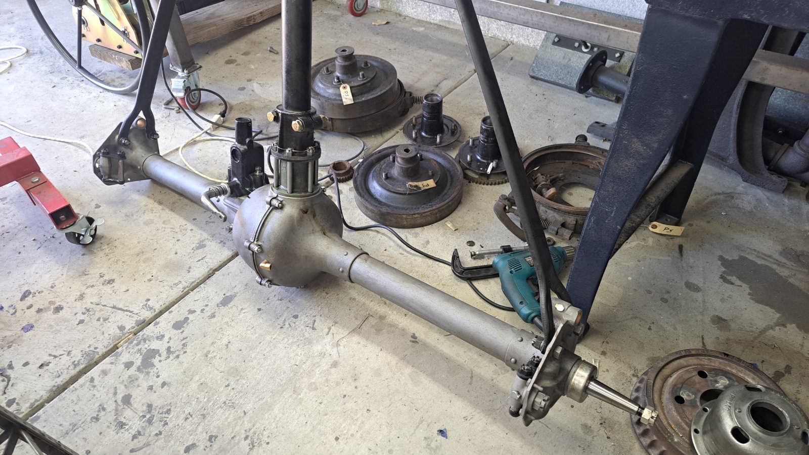

Post by AndreFordT » Sat Sep 06, 2025 1:32 am
Good morning Mark,

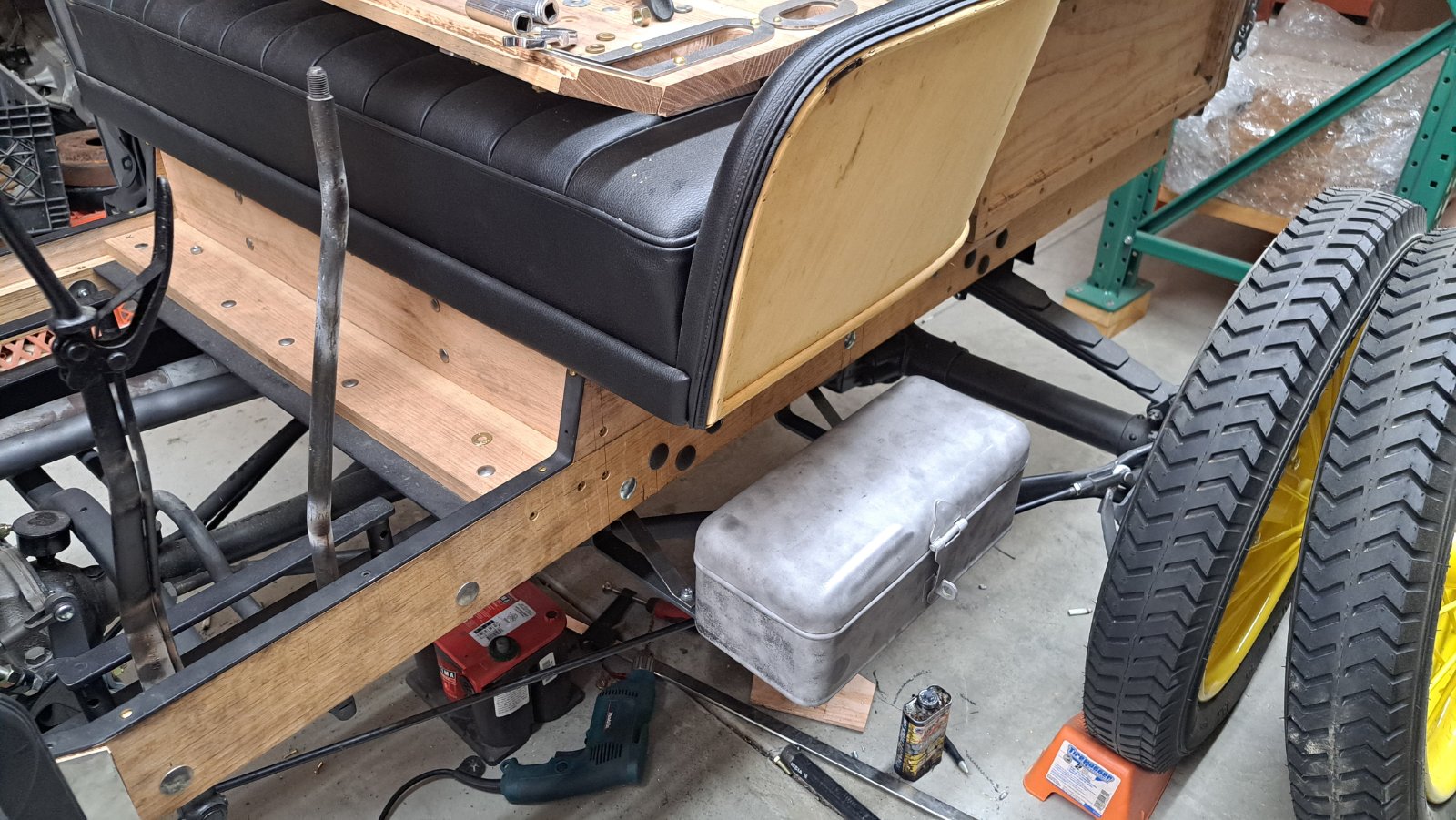

Great project, I would like to see the finished produced.

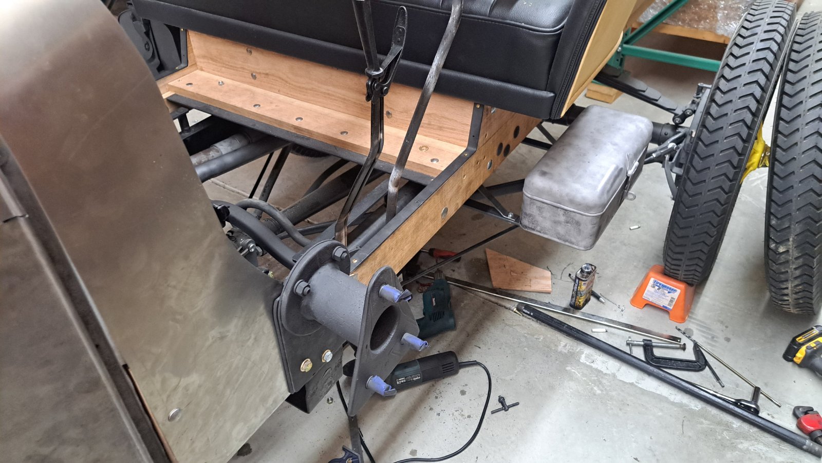

Do you have photo of way you attached the rear fenders to the rear axle?
Andre

Mark Chaffin
Posts: 4852
Last Name: Chaffin
Post by Mark Chaffin » Sat Sep 06, 2025 6:54 pm
Andrea. I'll take a few pics and add them on Monday.
Mark Chaffin
Posts: 4852
Last Name: Chaffin
Post by Mark Chaffin » Tue Sep 09, 2025 2:46 pm
Post by AndreFordT » Tue Sep 09, 2025 4:30 pm
Thank You Mark.
Andre

I should just get satin clear coat to keep the rust aspect.
Andre
Belgium
Shrshot
Posts: 143
Joined: Thu Dec 26, 2024 9:38 pm
First Name: Kent
Last Name: Palazzo
Location: Algoma, WI
Board Member Since: 2024
Post by Shrshot » Sat Oct 04, 2025 9:14 am
I can't wait to see it in paint done. That is a awesome build!

Post by TRDxB2 » Sat Oct 04, 2025 12:07 pm
Where did you get the cycle fenders & what are the dimensions? Been looking to get some
Mark Chaffin
Posts: 4852
Last Name: Chaffin
Post by Mark Chaffin » Sat Oct 04, 2025 12:44 pm
I made them. About a 24" radius. Modified early fender brackets front and rear and attached with threaded rivits.

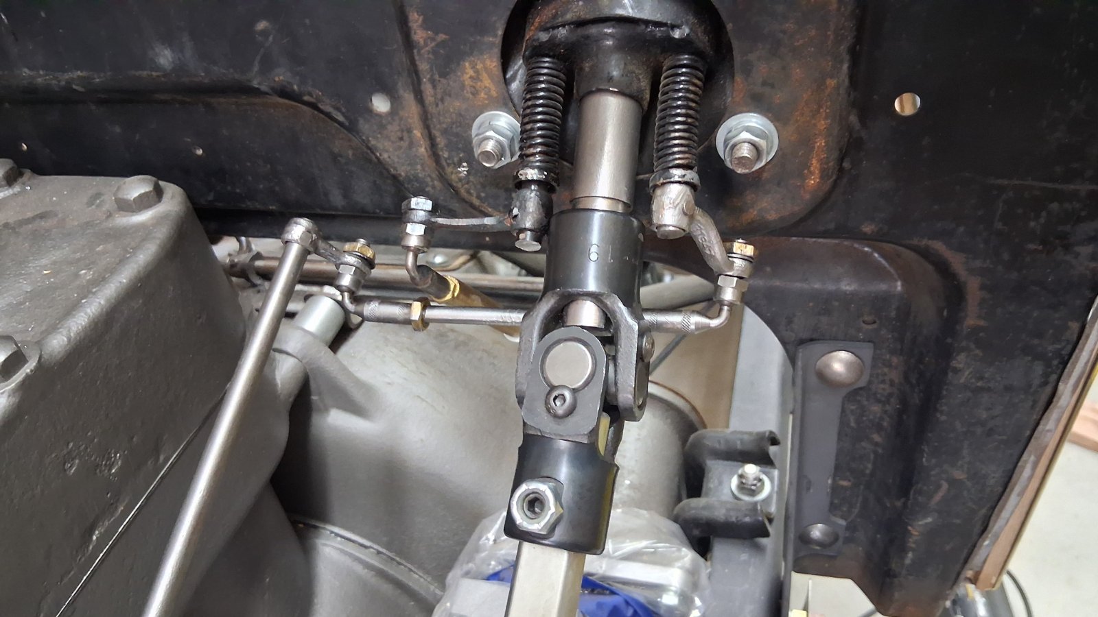

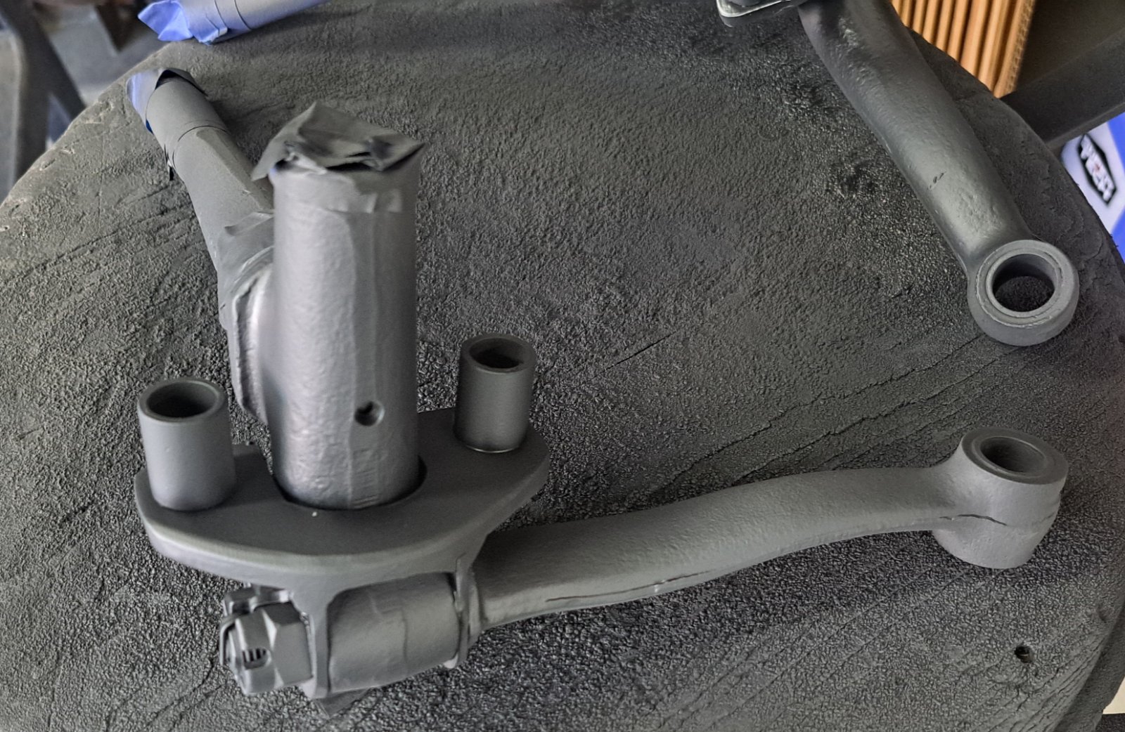

Post by Mark Chaffin » Wed Oct 22, 2025 5:25 pm
Couldn't help myself. Added the Vega box and extras for better steering.
big2bird
Posts: 736
First Name: Jeffrey
Last Name: Hausey
Location: Anaheim, Ca.
Post by big2bird » Wed Oct 22, 2025 6:57 pm
I saw it today. Took the same pictures. It's a beauty Mark.

Really incredible project very creative and well thought out and constructed. I do have a question about the seat. I'm guessing it is molded wood construction. Is it new and if so Did you make it or did someone else do it. I'm looking for that style of seat for my 1914 speedster project I'm working on now.
thnx
frontyboy
Mark Chaffin
Posts: 4852
Last Name: Chaffin
Post by Mark Chaffin » Fri Oct 24, 2025 11:55 am
Ray Wells made the seat and Ernie Romero the upholstery. They are both the best when it comes to their skill and craftsmanship.
