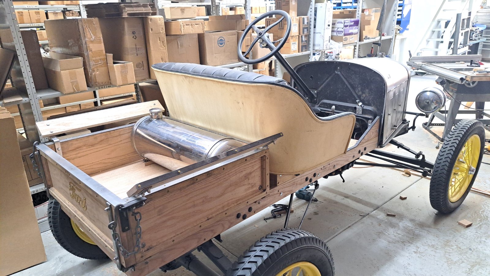

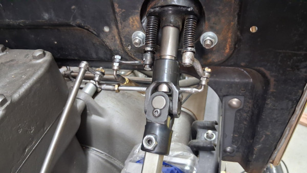

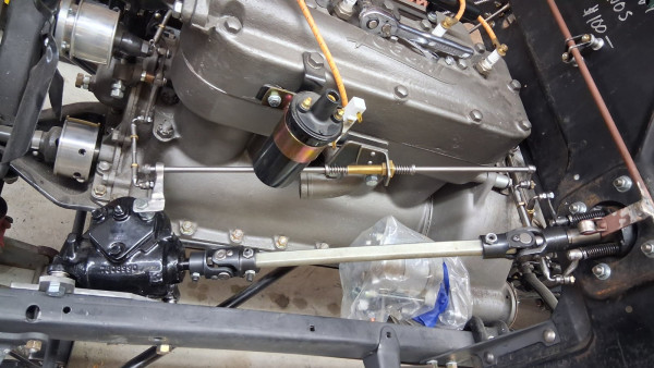

I thought I would share a couple pics of the Ranch Doodlebug build. Engine and Ruckstell are done. A huge shout out to Mr. Hank Lee for rebuilding my Zenith carburetor as I know it has been done right and also for modifying my Winfield intake manifold to ensure a proper fit. Hank is indeed an artist. Thanks Hank!

Looks like it’s coming along nicely since
last months visit. Sounds like you have some more shop space now or will shortly.
Best to you and your family, Charlie

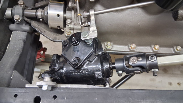

Check out the Livingood 4 W. D. setup for Model T Fords. A few years back, I believe that the original manufacturer's grandson was considering reproducing the set-up.
I believe he built one and installed it in a car. The only big modification needed was that the front spring needed to have a special bend at one end to clear the offset differential housing.
Most of the differential parts were stock Ford, or modified T components. There was a video of a car with a Livingood set-up on YouTube. Not sure if it's still there.

I'm aware of the Livinggood setup. More complicated than it needs to be. Spring setup and all. It also has a few limitations which can be improved upon. In my humble opinion. Thanks for the info though.

Frame shortened 12 inches as well as driveshaft.

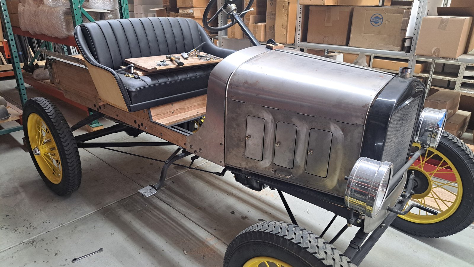

What head are you running there Mark? It looks pretty chunky?
Mark Chaffin
Topic author - Posts: 4852
- Last Name: Chaffin
- Location: Lake Elsinore
Re: Ranch Doodlebug Build
The head is a cast iron original TURBO. I've only seen one other in my travels.

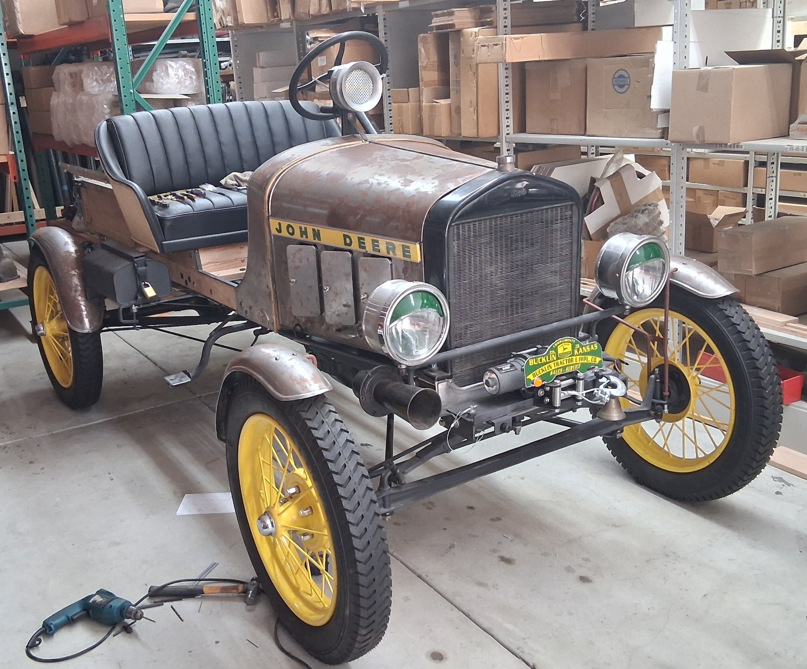

Moving right along!

Ed Fuller
- Posts: 895
- First Name: Ed
- Last Name: Fuller
- Location: NJ
- Board Member Since: 2012
Nice work Mark! I really like the hood you are using.

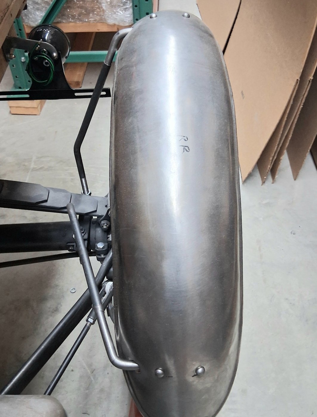

Installing cycle fenders and brackets.

Hey Mark,
That thing is coming along nicely from when I was there a few months ago! I don't know whether to be happy for you that you are making major progress or sad for myself since I can't seem to make any on my stuff. LOL I guess both!

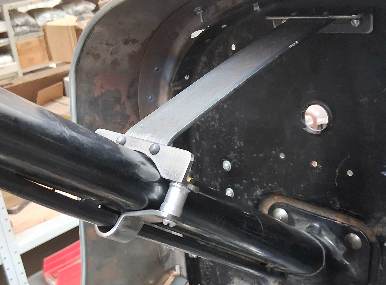

- Posts: 1219
- First Name: Adrian
- Last Name: Whiteman
Thanks for the pictures mark, looking good.
Did you make the cycle guard mounting brackets? They are very neat and I am curious how they fit and how they are braced.
Would you mind sharing a few more details??
Thanks again
Adrian
Thanks again
Adrian
Mark Chaffin
Yes. The spindle brackets were made by hand. With two tabs welded on the plate to be mounted using the spindle arm. The spindle arm boss and nut were machined down 1/8" each to allow clearance. The rods are cold role steel threaded 1/2-20 at 4" Length for adjustment. The opposite end was turned down on a lathe to .425 for the fender eyelets. Once the brackets are attached to the spindle, a 1/4-20 short bolt was added front and rear to prevent the bracket from rotating. A few more pictures have been added to illustrate further.
- Posts: 1219
Thank you, that is a clever solution! I will salt that idea away

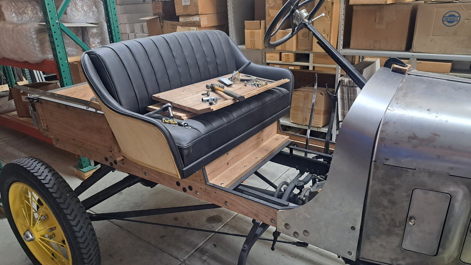

More progress. Almost ready for paint.
Ed Fuller
- Posts: 895
- First Name: Ed
- Last Name: Fuller
- Location: NJ
Wow, a winch!
That must be a serious ranch!
Progress looks great Mark.

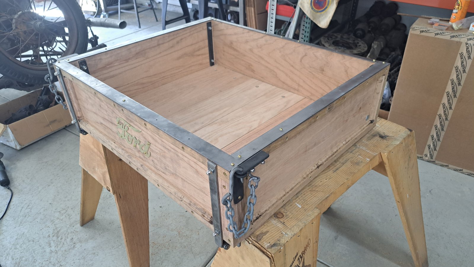

Good morning Mark,
Great project, I would like to see the finished produced.
Do you have photo of way you attached the rear fenders to the rear axle?
Andre
Belgium

Mark Chaffin
Andrea. I'll take a few pics and add them on Monday.

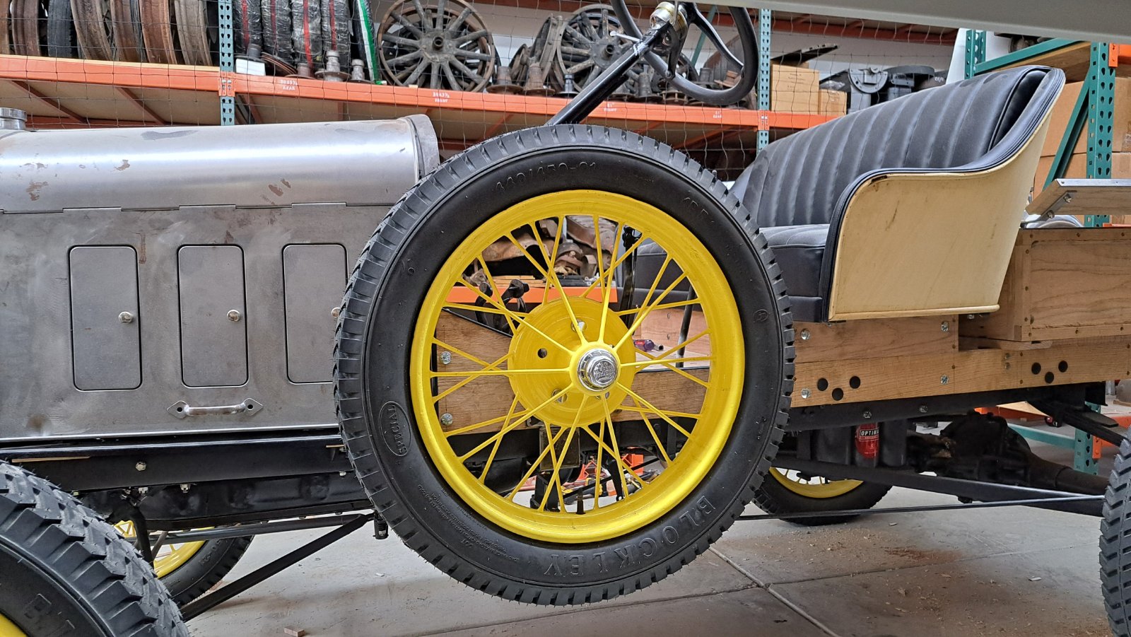

Mark. The Blockneys. Are they marked " Made in the UK."?
Mark Chaffin
Made in Vietnam.
- Posts: 7309
Made in Viet Nam, to Blockley's own specifications. They have been supplying a large range of bias ply and vintage racing tyres for many years. They recognised there was a real quality problem with the quality of the tyres produced for our Ts, and set about rectifying this. What it needed was direction from the marketer for those better quality products. That better quality comes at a higher price, but as someone commented on the forum, if it leads to longer, better service, it is far better value over all.

My opinion. Far superior to the other offerings. Especially, their tubes.

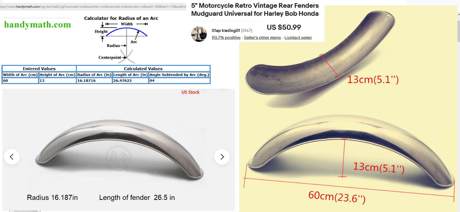

Where did you get the cycle fenders & what are the dimensions? Been looking to get some
I made them. About a 24" radius. Modified early fender brackets front and rear and attached with threaded rivits.
Couldn't help myself. Added the Vega box and extras for better steering.
I saw it today. Took the same pictures. It's a beauty Mark.
Mark,
Really incredible project very creative and well thought out and constructed. I do have a question about the seat. I'm guessing it is molded wood construction. Is it new and if so Did you make it or did someone else do it. I'm looking for that style of seat for my 1914 speedster project I'm working on now.
thnx
frontyboy
thnx
frontyboy
Ray Wells made the seat and Ernie Romero the upholstery. They are both the best when it comes to their skill and craftsmanship.
