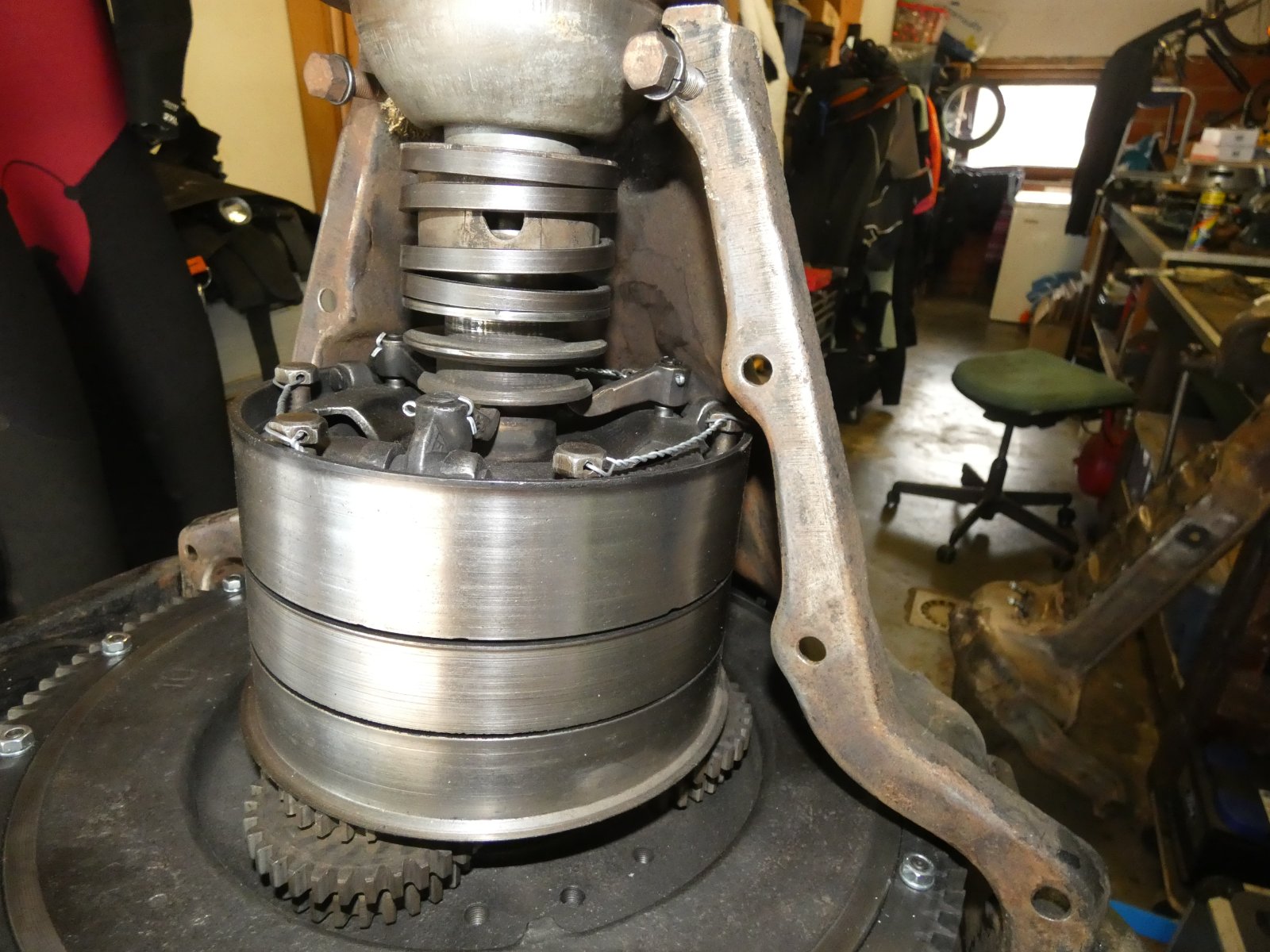

Well, I've got good news and bad news to report on my band issue. The good news is you guy's know your stuff and people can learn something new everyday from this forum! The bad news is a previous owner of this engine did indeed install an earlier, three dip pan without the enlarged drum area.
I started comparing the various three and four dip pans around here and I see the difference. I was not aware of that modification. I thought the only change in the oil pans were the dips and different style wishbone ball socket.
The previous owner, somehow, got whatever band material they used in there, but just barely. Upon closer inspection, I can see a wear mark on the pan where the band has been rubbing! And I once drove the car this engine was in and the braking action seemed fine.
Obviously, this pan issue puts a wrinkle into my quick band change plans!
Thanks for all the help on this.

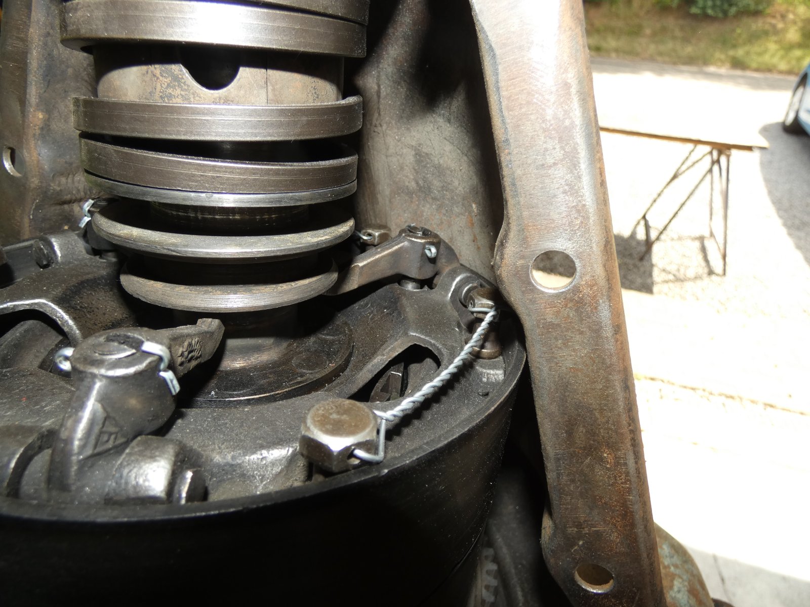

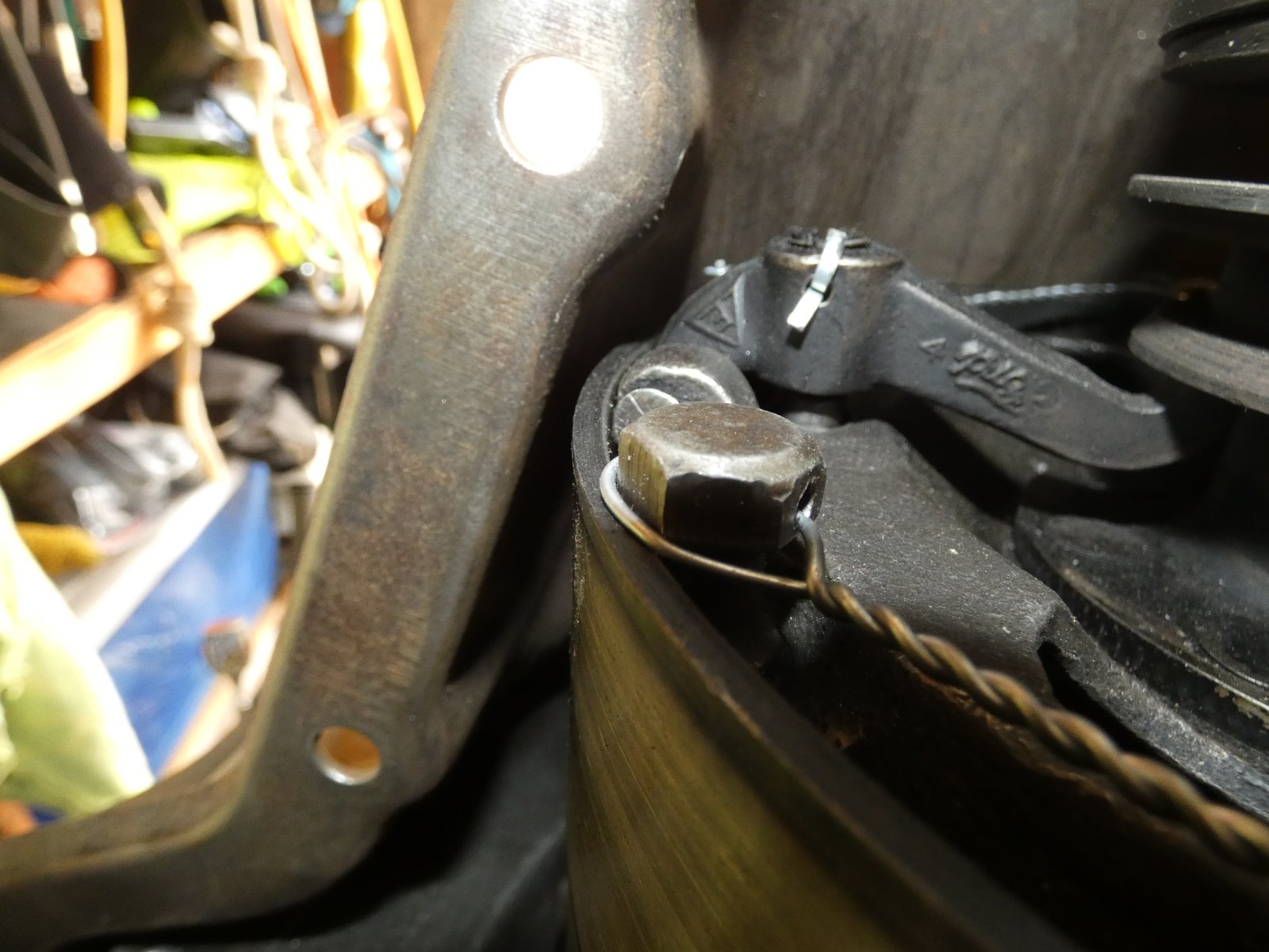

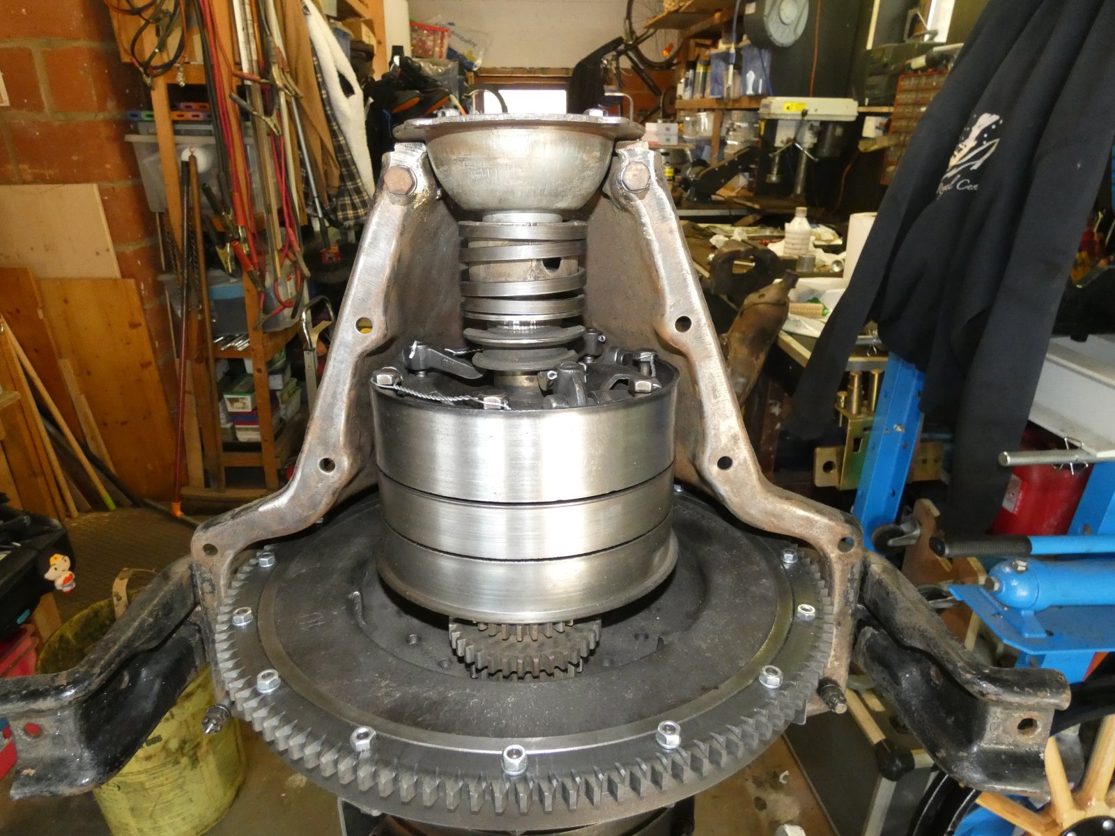

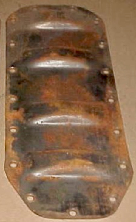

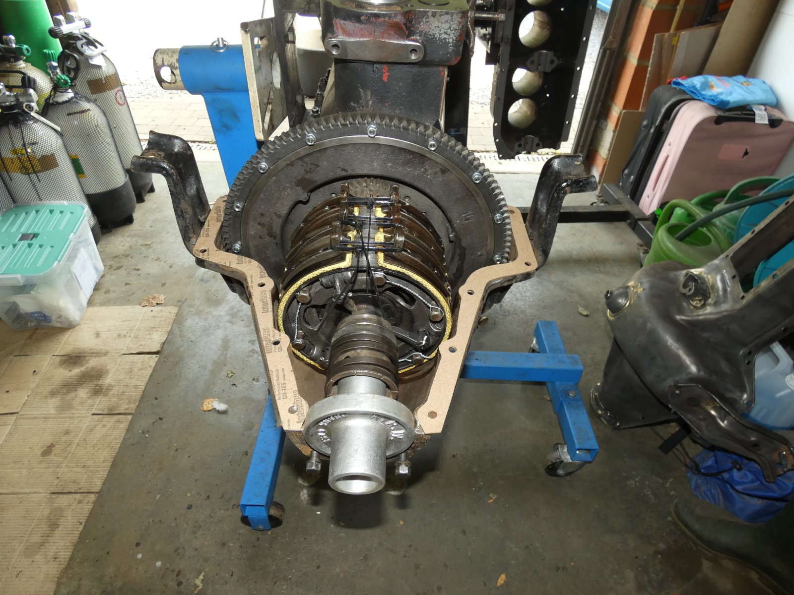

somewhere during this post there were photos asked about the oilpan and the wide drum.
A few rebuild ago I found this:
The original engine has a wide drum and a carterpan with the small inspection cover. I don't know how the previous rebuilder arrived mounting it on the engine. Here a few photos of the problem.
I changed the carterpan with a right one.
The two last photos are the wrong pan.
Good luck
Andre
