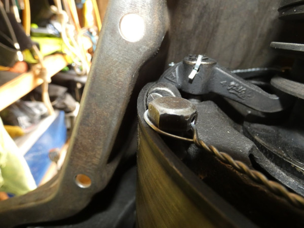

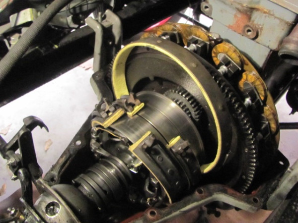

Guy's,
I am not new to band changing, although it's been a number of years since my last set and they all have been the narrow ones up until now. So, I installed Kevlar on this set, and the brake band will not go back enough and around the drum completely without the metal band hitting the pan on both sides! I am holding the ears together tightly, as if the brake was applied already, and the band still hits. It's unable to slide rearward enough to get the band into the correct position.
What am I missing here? I don't remember my last set having this clearance issue? Is this a common problem with Kevlar on the wider band? Is my band material too thick? Even if I could get it into the correct position, there would be absolutely no room for the band to relax/expand and it would be in contact with the drum continuously.
Figured I better talk to some folks who had more '26-27 band experience than I.
Thanks in advance for any light that could be shed on my brake band issue.
Steve
Steve

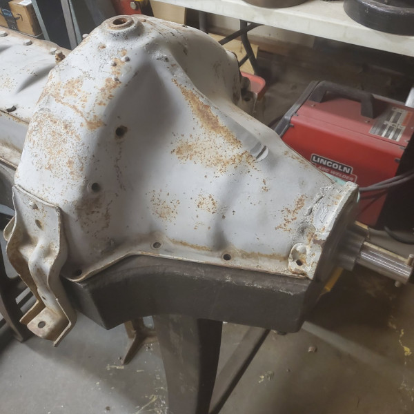

Re: '26 wide brake band & kevlar question
It's a '26 block, wide brake drum and with the late (wider pedal shaft spacing, dual mounts at the magneto contact) hogshead. Maybe the pan is incorrect, I don't know. Like I said, I have no prior experience with the "26-27's.

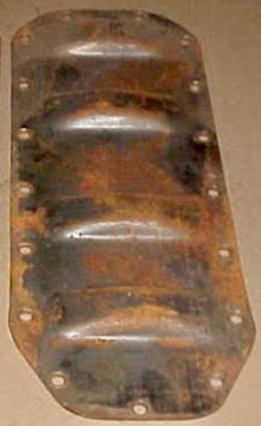

Does anyone have a photo of the later pans with the expanded area? Or, is there a photo of the modified pan in Bruce's book or the black bible? I have both but they are not within reach at the moment.
Thanks for the insight on the modified pans!
Steve
Steve

Well, I've got good news and bad news to report on my band issue. The good news is you guy's know your stuff and people can learn something new everyday from this forum! The bad news is a previous owner of this engine did indeed install an earlier, three dip pan without the enlarged drum area.
I started comparing the various three and four dip pans around here and I see the difference. I was not aware of that modification. I thought the only change in the oil pans were the dips and different style wishbone ball socket.
The previous owner, somehow, got whatever band material they used in there, but just barely. Upon closer inspection, I can see a wear mark on the pan where the band has been rubbing! And I once drove the car this engine was in and the braking action seemed fine.
Obviously, this pan issue puts a wrinkle into my quick band change plans!
Thanks for all the help on this.
Steve
Steve

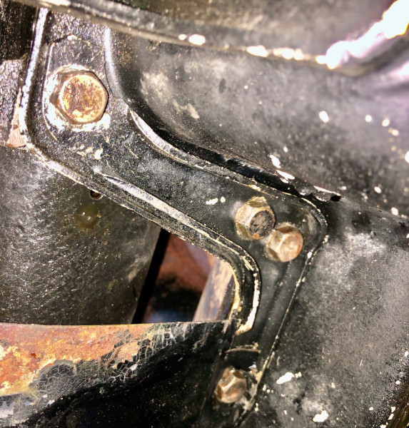

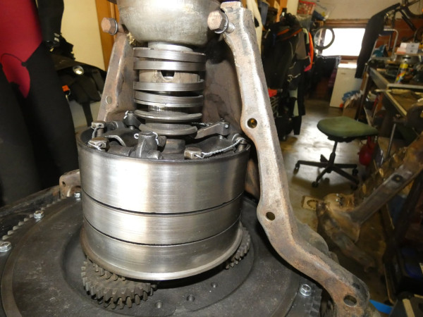

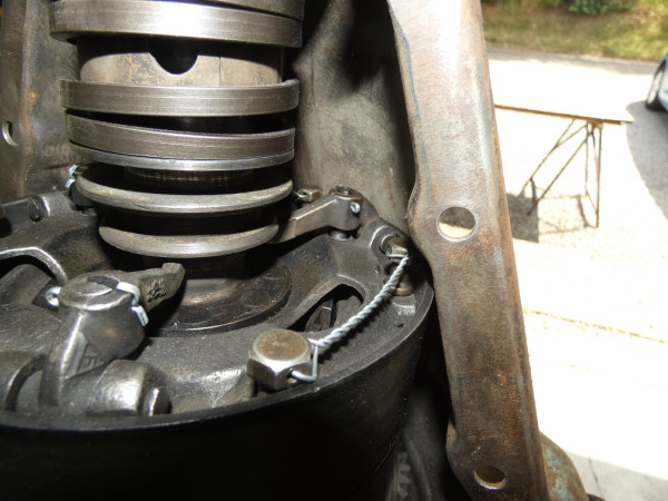

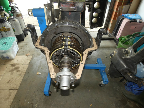

somewhere during this post there were photos asked about the oilpan and the wide drum.
A few rebuild ago I found this:
The original engine has a wide drum and a carterpan with the small inspection cover. I don't know how the previous rebuilder arrived mounting it on the engine. Here a few photos of the problem.
I changed the carterpan with a right one.
The two last photos are the wrong pan.
Good luck
Andre
Belgium
Good luck
Andre
Belgium
