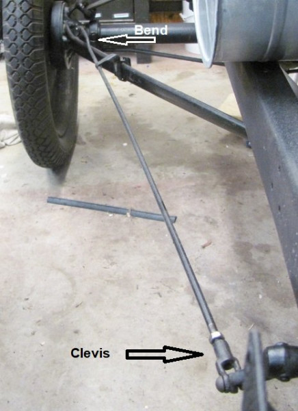

Your description makes it sound like the brake rod is to long if you need to cut off the end in the clevis (screwy thing ?) for adjusting.

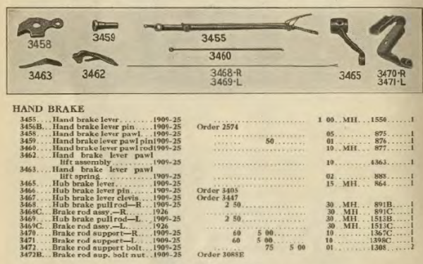

The parts book indicates left and right rod. The rods also have a bend to clear the radius rod. Your rod may have lost the bend making it longer.
To loosen the clevis, remove the rods, clean the threads you can get at, put penetrating oil on the nut & clevis. Be patient may take several application & a few days. If you need heat & have a gas stove, send your wife out on an errand......
