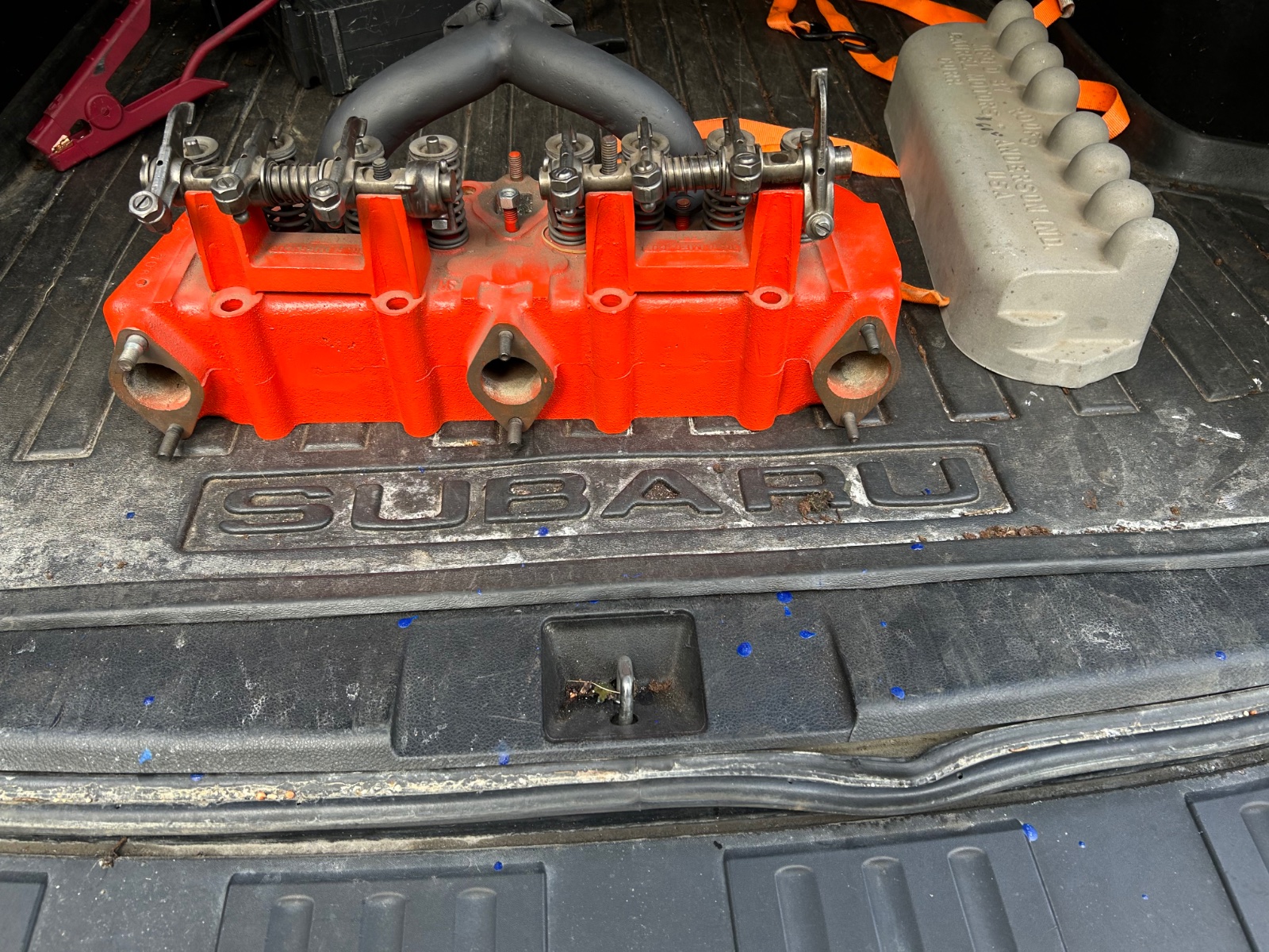

Just purchased a 8 valve Roof head. Don't know anything about the history. It appears that the head has been reconditioned. The valves are new as well as the springs. Rockers are reconditioned as well.
I am looking for pushrods and a correct head gasket. As I know little or nothing about the Roof, I would appreciate any help you could provide. Dimensions and photos of the pushrods would be appreciated. A tracing of the head gasket. Also need a 3 port exhaust manifold.

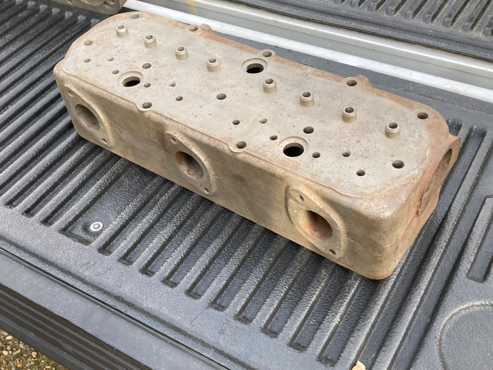

The factory 2 port Roof exhaust manifold looks identical to a Fronty T/S manifold, except the port bolts “lean” at a different angle. Here is a Roof manifold I bought years ago thinking it was a Fronty, then sold it a couple years before finding my own Roof head to match.

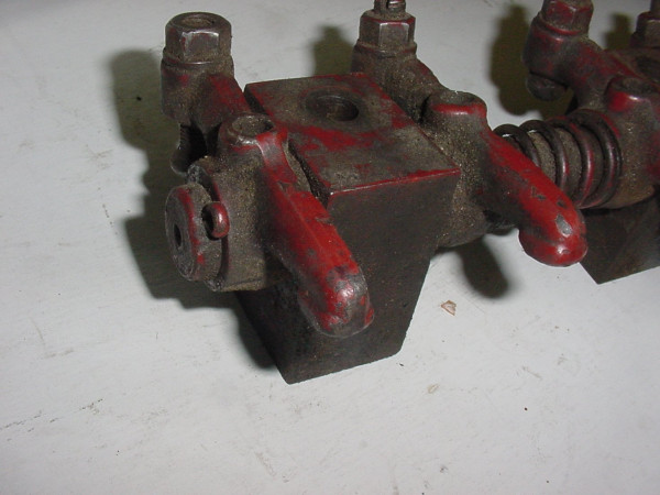

Re: 8 valve ROOF cylinder head
Here is what factory Roof rocker arms and stands look like for the twin intake cylinder head. The single port head had the rocker stands cast into the top of the head and were not removeable.

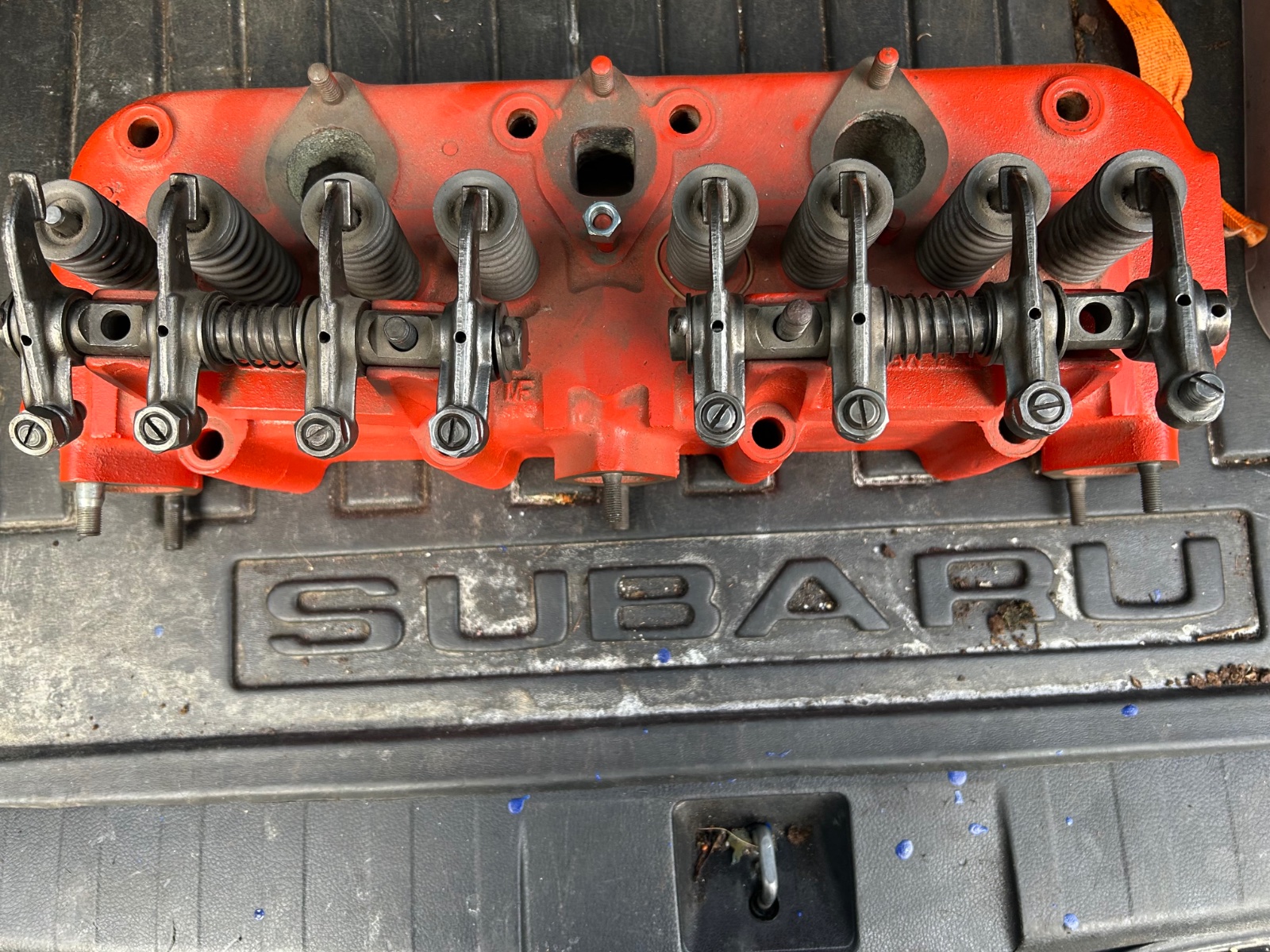

Wish I knew how to post photos here. My head has 2 intake ports on the top of the head. Also it has removable rocker stands with adjustable rockers. The exhaust side of the head has 2 ports. The intake manifold that came with the head appears to be an original casting and at the carburetor flange it is horizontal as to use a stock T carb.
This head appears to be reconditioned and is painted bright orange. If someone here may have known or owned it step up and tell me the history.

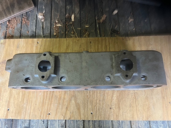

Uhhhhh… 2 ports on top…? Think it’s time for pics. Here is a shot of a 2 port Roof head. Yours the same…?

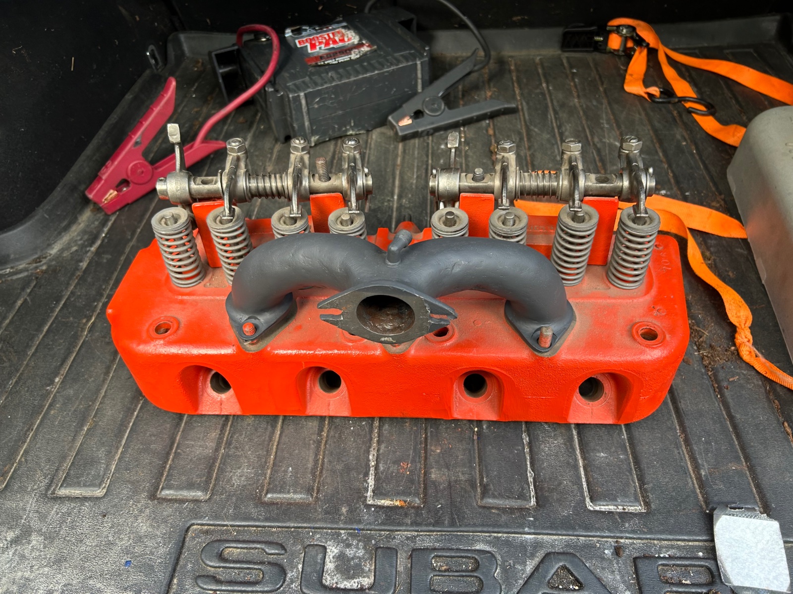

Pics of the cylinder head in question;
The rocker stanchions have “R. R. MFG” cast into them which is typical for Roof. Head bolt layout and exhaust side of head suggest Chevy/Olds 4 based design tho. Have you tried to bolt to a T block yet…?
Roof Chevy heads had the intake ports on top of the head
Chevy Roof converted to OHC, intake ports on top of head, Model M Winfield converted to downdraft
It is a 4 cylinder Chevrolet ohv head. Moving on might trade for 8 valve T ohv head or sell the Chev head
