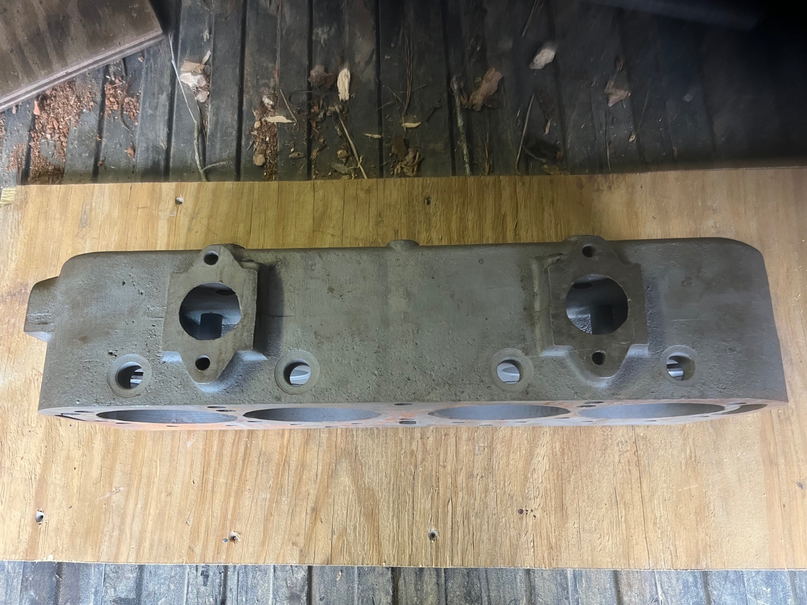

- Posts: 1603
- First Name: Kevin
- Last Name: Pharis
- Location: Sacramento CA
Re: 8 valve ROOF cylinder head
Uhhhhh… 2 ports on top…? Think it’s time for pics. Here is a shot of a 2 port Roof head. Yours the same…?
