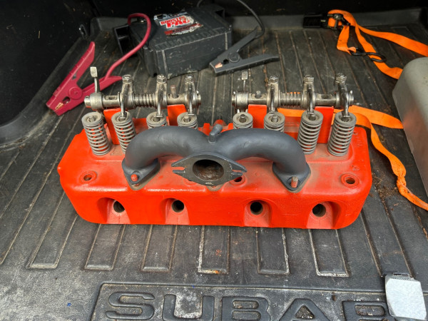

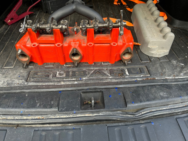

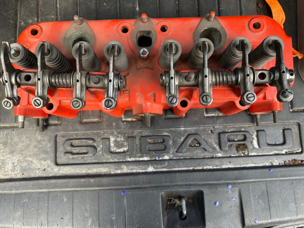

Re: 8 valve ROOF cylinder head
Pics of the cylinder head in question;
The rocker stanchions have “R. R. MFG” cast into them which is typical for Roof. Head bolt layout and exhaust side of head suggest Chevy/Olds 4 based design tho. Have you tried to bolt to a T block yet…?
Roof Chevy heads had the intake ports on top of the head
