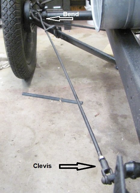

We need to identify the screwy thing first. Are you talking about emergency brake rods and the threads at the end of them that the clevis and nut are on?
- Posts: 6577
Re: Refractory Brake Rod
I am assuming your referencing the hand brake rods not the clutch & not the slow speed clevis attached to the Clutch Pedal
Your description makes it sound like the brake rod is to long if you need to cut off the end in the clevis (screwy thing ?) for adjusting.

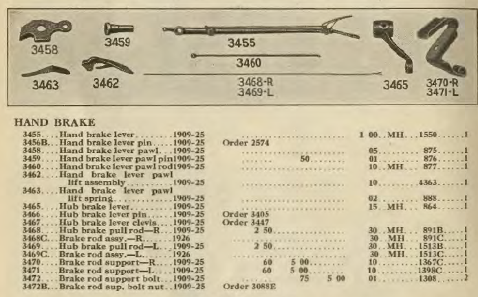

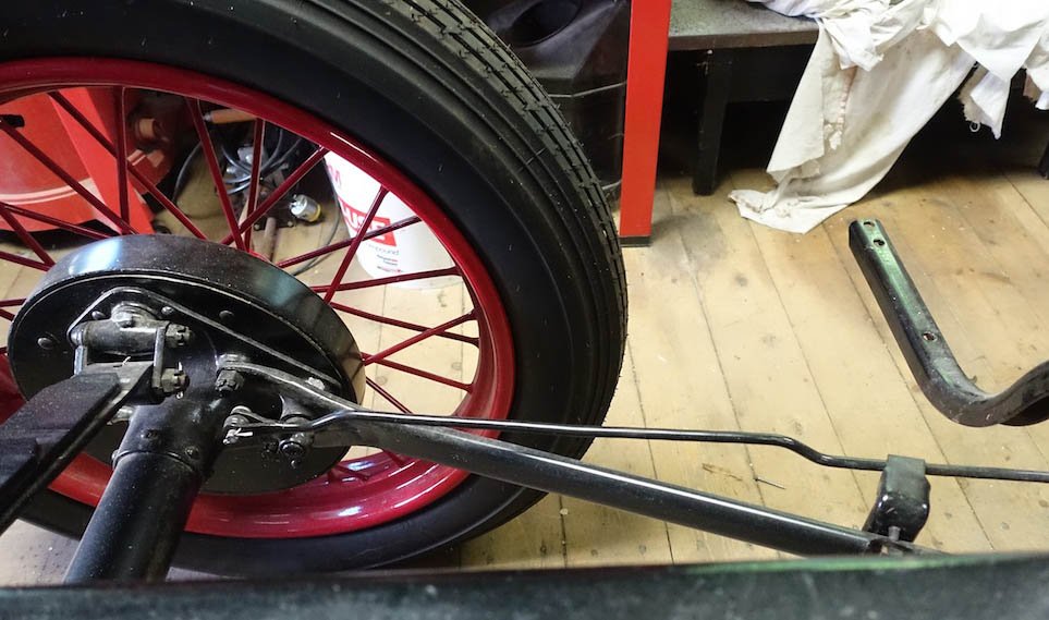

The parts book indicates left and right rod. The rods also have a bend to clear the radius rod. Your rod may have lost the bend making it longer.
To loosen the clevis, remove the rods, clean the threads you can get at, put penetrating oil on the nut & clevis. Be patient may take several application & a few days. If you need heat & have a gas stove, send your wife out on an errand......

First, remove the entire brake rod - if have access to a torch, heat up the clevis and let cool - it will loosen right up - same with the nut. You can also thread more of the rod, if needed with a 5/16 fine thread die.

The later clevises are rolled steel, with a seam along them. Attention with a hammer around the outside of the clevis, as well as heat, should free them up. Failing that a sharp chisel can be used on the seam to open up the clevis a tad.
