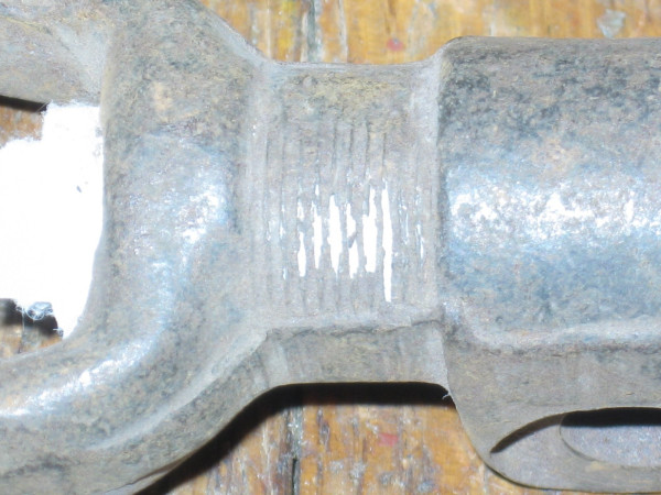

Recently cleaning out some boxes and drawers and I came across some N.O.S. parts.
- Posts: 4290
Re: Why some N.O.S. parts remained N.O.S. over the years.
I used an NOS intake manifold some years ago. The car wouldn't run right no matter what I did. Turned out, the interior passages were half blocked with casting flash. Into the trash it went!

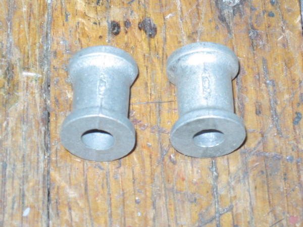

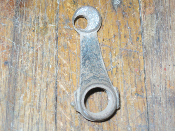

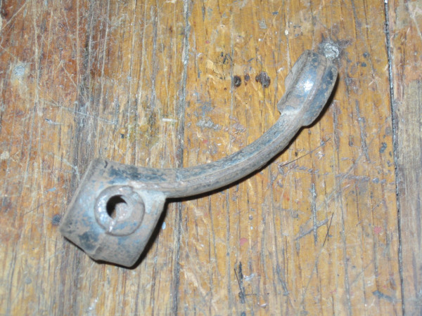

A few more that escaped the final quality checks.
Not that bad just a little "out-of-time" on the punch press, third time is the charm I guess.

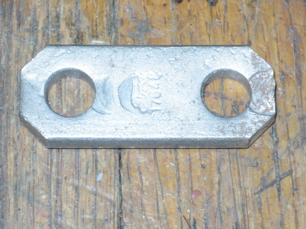

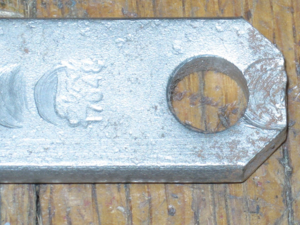

Some of my favorites, N.O.S. Crankcase Lower Cover Bolts that seem to have missed a step. I have about 50 of these mixed in with good N.O.S. ones.
