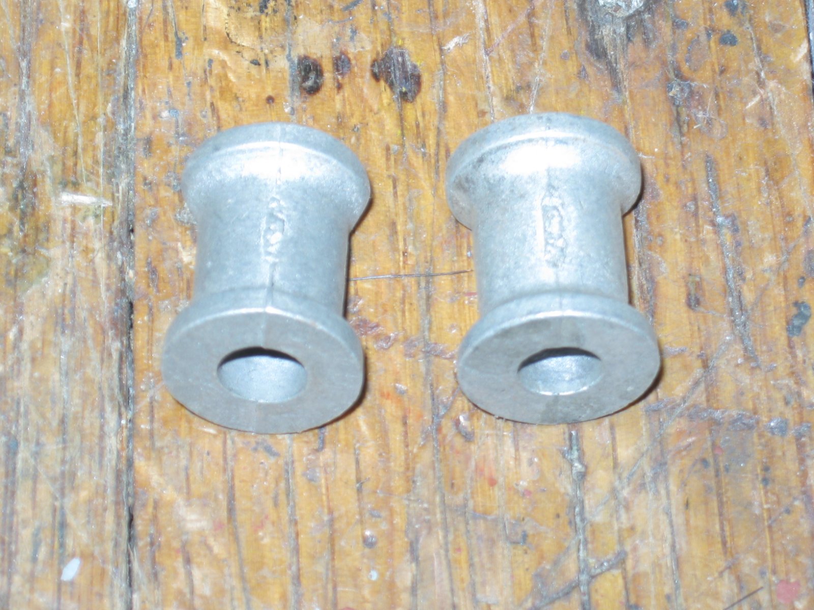

Recently cleaning out some boxes and drawers and I came across some N.O.S. parts.
