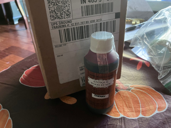

Topic author - Posts: 1254
- First Name: Mike
- Last Name: Bird
- Location: Goshen IN
Re: Laurel mountain Forge Stain
Just received my order. Sorry for those who were unable to get one. If I find some more I’ll let you know.
