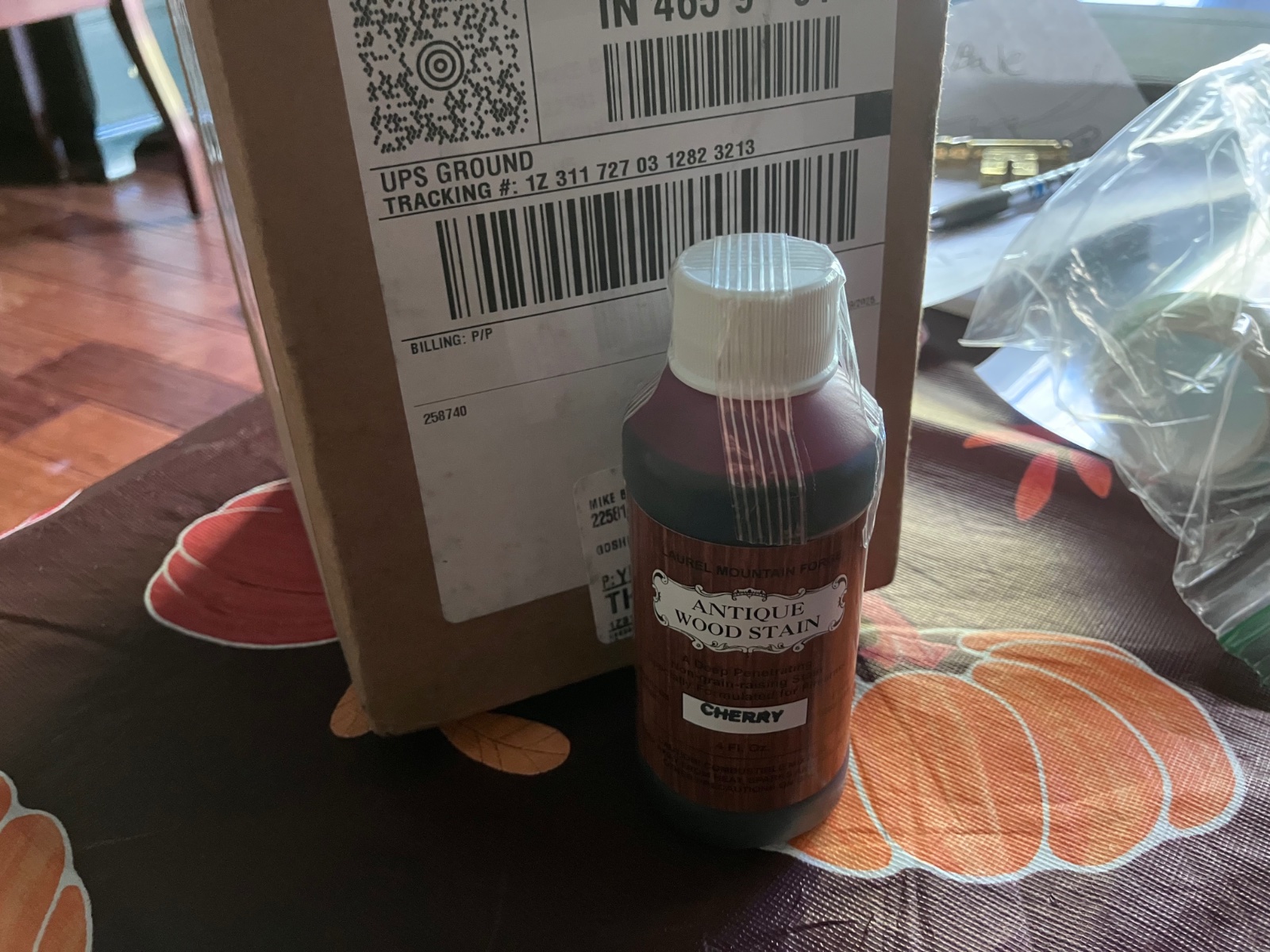

Tbird
Posts: 1333
Last Name: Bird
Location: Goshen IN
Re: Laurel mountain Forge Stain
Post by Tbird » Tue Oct 14, 2025 3:55 pm
Just received my order. Sorry for those who were unable to get one. If I find some more I’ll let you know.
