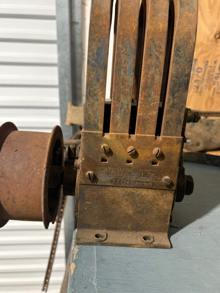

I acquired this “gem” a while back with some other junk.
It is a KW model ALC,…. Thinking it is a magneto?
Anyone have any information??

Yes, that is a magneto from the 1900's: https://oldcroak.com/k-w-ignition-company-magnetos/
The 'ALC' has five magnets, is for ignition and lighting and cost (in 1909) the sum of $50.
