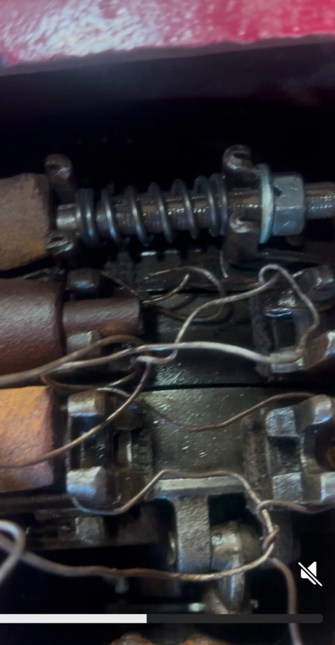

I recently replaced the brake band on my Model T and ended up doing it in a way some of you might appreciate (or laugh at). I didn’t have the proper band-changing tool available, so I improvised with bailing wire to snake the new band around the drum.
I also chose to do the whole job in the car, without pulling the hogshead. It took some patience and a few choice words, but it ultimately worked. I filmed the process in case it’s helpful to others, or if anyone wants to comment on better techniques or things I should try next time.
Here’s the video if you’d like to take a look:
https://youtu.be/Mfq15zHDguA?si=tIYA2AfIvGVJao_Y
I included both real-time footage and some high-speed sections to show the fiddly parts without making it a long slog.
Would love to hear how others approach band changes in-car — tips, tricks, or tools you swear by.

Thanks, John! Good to know I’m not the only one who’s improvised a “band tool” out of whatever was on hand. A coat hanger or welding rod probably would’ve saved me a little grief, but the bailing wire did the job in the end.
That Ford advertisement is great — I hadn’t seen it before. I’ve wondered what kind of magic Joe Snow was using to get it done that quickly. Certainly wasn’t my experience!

Changing bands in a finished car is the best selling point for Kevlar. At 6'3", its just flat horrible.

I just finished putting a motor together and I don’t have the band clamp tool so I wired them all up with baling wire. Good for making cotter pins if you can’t find one, I’ve got it holding the muffler up on my 88 GMC where the tailpipe rusted in two as well.

I use nylon zip ties to hold all together whilst replacing the cover - they USUALLY slip out from under the band ears but being nylon, if a small piece goes AWOL, it really can't damage anything.

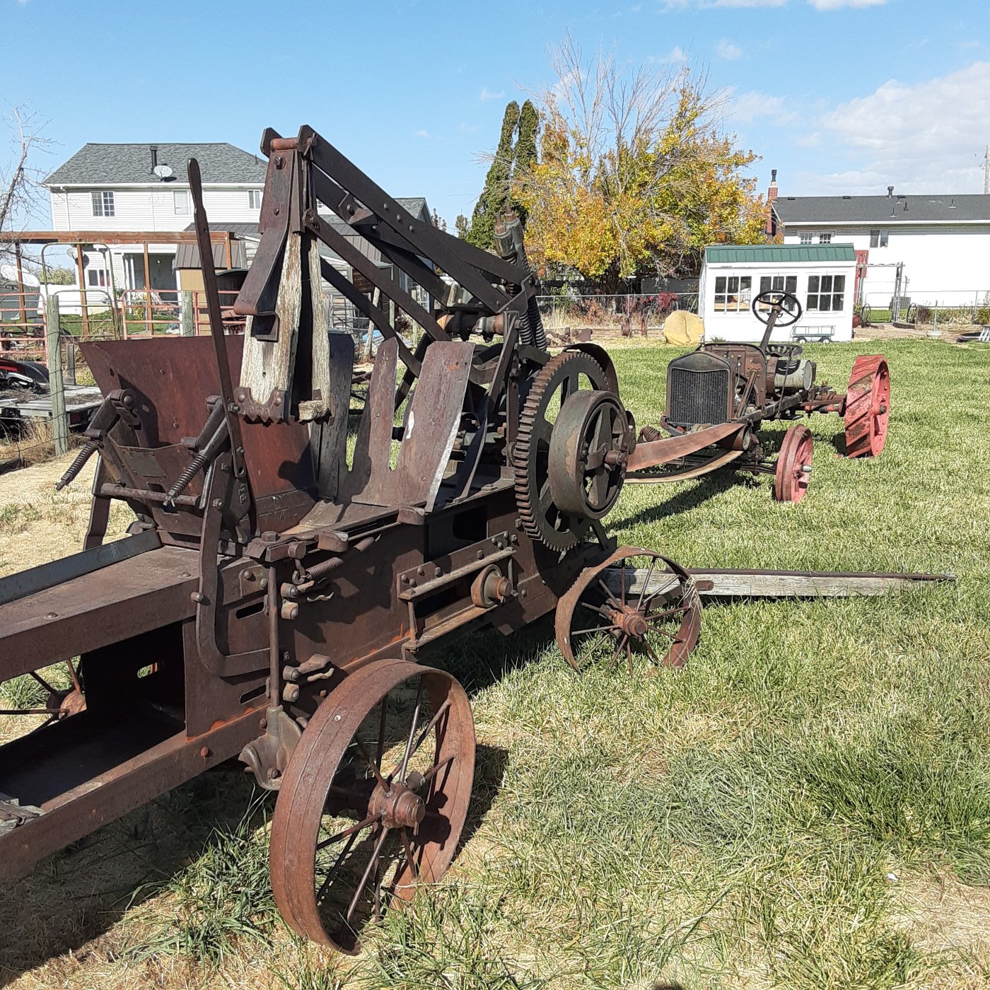

Not to confuse the issue, but here is a wire tie baler in operation. It's a 1922 Missouri Mule hay press. And hit to keep the discussion on task, Sammy T Shaw, is providing the power. Sorry we were'nt baling that day.

Thanks for all the responses! I didn’t expect a vocabulary lesson, an engineering lecture, and a comedy show all at once, but here we are. I really enjoyed reading everyone’s explanations and learning from you all. I had no idea my misspelling of baling would take on a life of its own and spark so much discussion—apparently one wrong vowel can start a small linguistic wildfire. Lesson learned.

Also, Robert mentioned “no attempt to true up the band to the drum before installing the lining.” I thought I had done that by fitting the band around my drum jig (as shown in the video), but I may be missing something. Robert, could you explain what I should look for or do differently? I’d really like to understand this better.

Kevin, many thanks for posting that !
(Worth noting these early “hay presses” worked stationary. Hay had to be brought to the press, as opposed to the “modern” balers that would pick up windrows in the field.)
