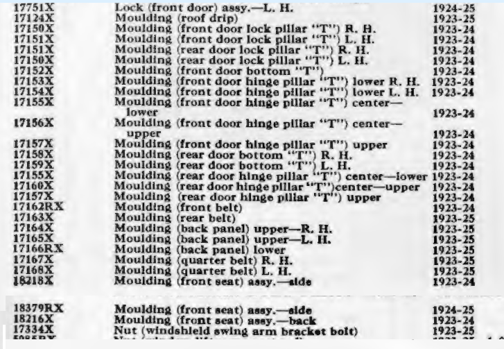

tom_strickling wrote: ↑Sat Nov 29, 2025 10:03 amWhat is the semi-rounded metal strip that goes around the back of a Fordor to cover the sheet metal seam called?
The 1925 Price List of Body Parts lists it as Moulding, Rear Belt, part number 17163X.

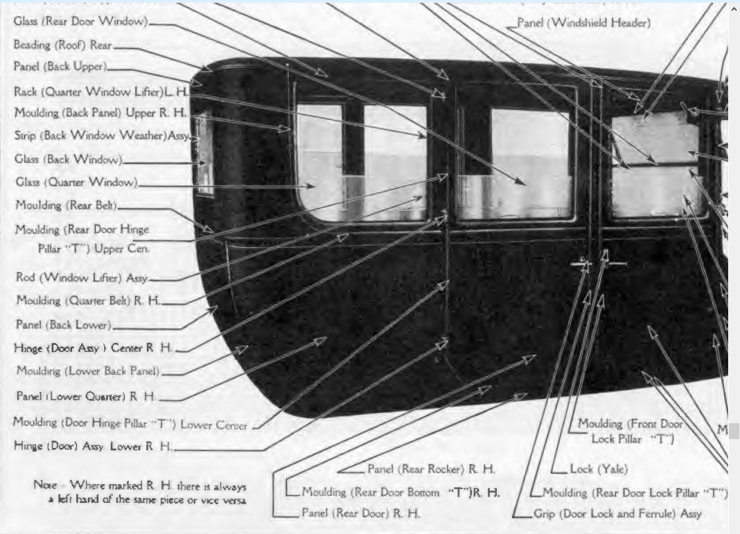

- Posts: 6611
Re: Part name needed
Does this help?tom_strickling wrote: ↑Sat Nov 29, 2025 10:03 amWhat is the semi-rounded metal strip that goes around the back of a Fordor to cover the sheet metal seam called?
