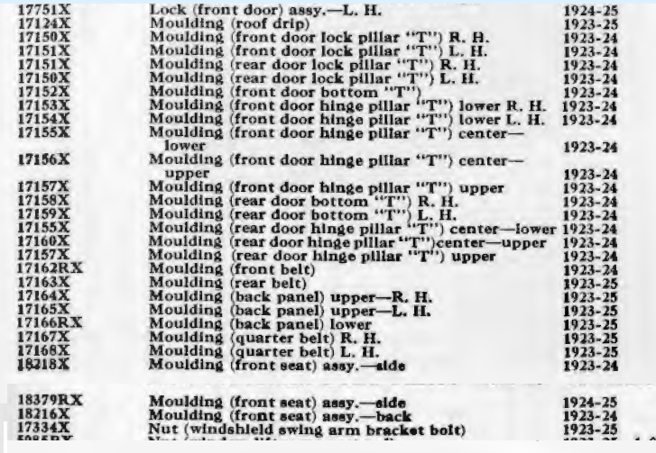

The 1925 Price List of Body Parts lists it as Moulding, Rear Belt, part number 17163X.

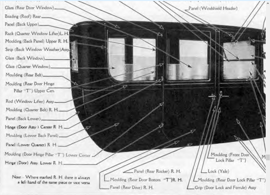

Post by TRDxB2 » Sat Nov 29, 2025 10:27 pm
tom_strickling wrote:
Sat Nov 29, 2025 10:03 am
What is the semi-rounded metal strip that goes around the back of a Fordor to cover the sheet metal seam called?
Does this help?
