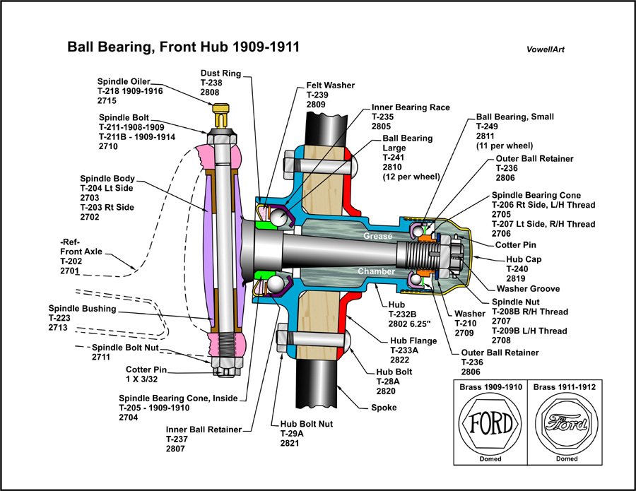

found this in the archive section... this answers my question about the bushings / inserts

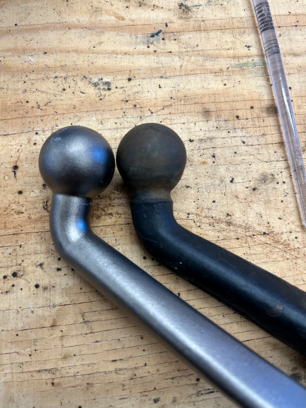

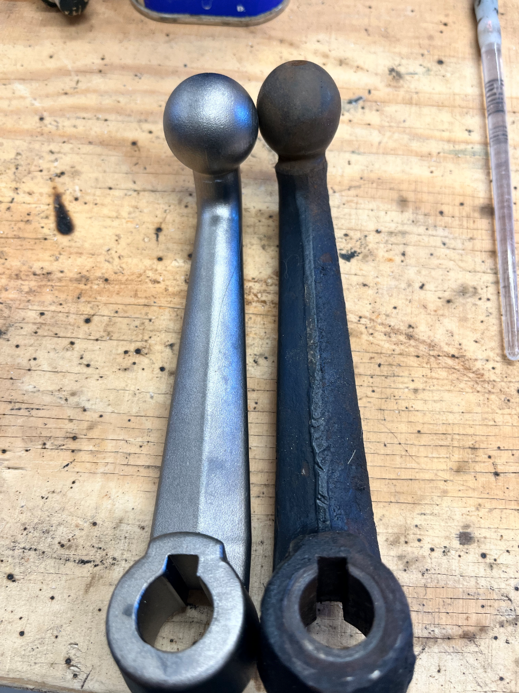

Post by fireheadman » Sun Dec 07, 2025 8:40 pm
made a little progress on this issue..
  • re-peened the wheel bolts after tightening those up a 1/4 turn
  • replaced the 3 pinon gears (studs were ok), installed a new brass screw cap.... those 2 cleaned up a lot of slop!! (just need to re-grease everything)
  • next went in for the pitman arm, compared that to the new one and noticed the difference in size + wear on it. (Also bought a new end cap for it, rod side seems fine!)
  • lastly, re-replaced the bushings on the driver side (spindle / kingpin).... bought a reamer and center alignment tool (this made a world of difference!!
bad news is for the passenger side spindle, I went a little over board on cutting out the bushing (couldn't get it to budge on tapping it out) and put a 1/16 groove up and down it.
....so going to pick up a replacement spindle soon, install new bushings, then should have most of the slop, wear and tear out of there!
Question I have on the pitman arm.
Since this a metal on metal (moving part), is there supposed to be a lubricant applied to it? Or just leave it dry?
Only place left to review is the ball joint on the wishbone (at the engine pan connection).... Might replace the lower section of that if I can find the parts.

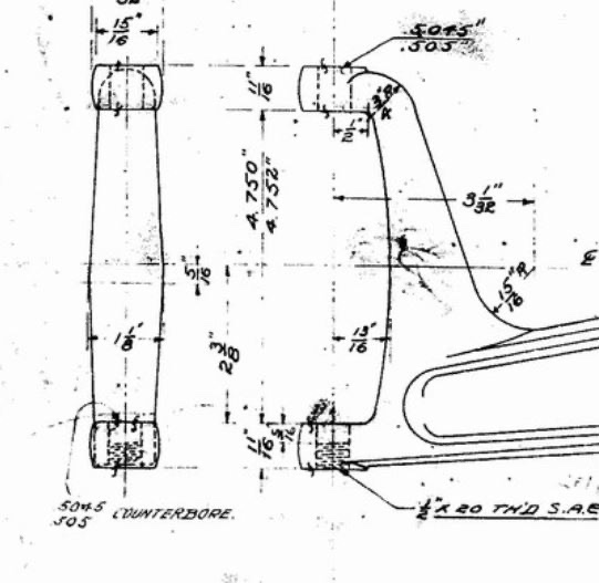

Here is what it should be. Have not seen a really good axle in many years. You may have a unicorn.
Chris Barker
Posts: 345
First Name: Chris
Last Name: Barker
Location: Somerset, Eng;and
Re: wobbly front wheels
Post by Chris Barker » Wed Dec 10, 2025 4:45 am
Interesting in that nowhere on the section of the axle drawing shown above does it state that the kingpin axis is vertical - which it is. Maybe it's elsewhere.

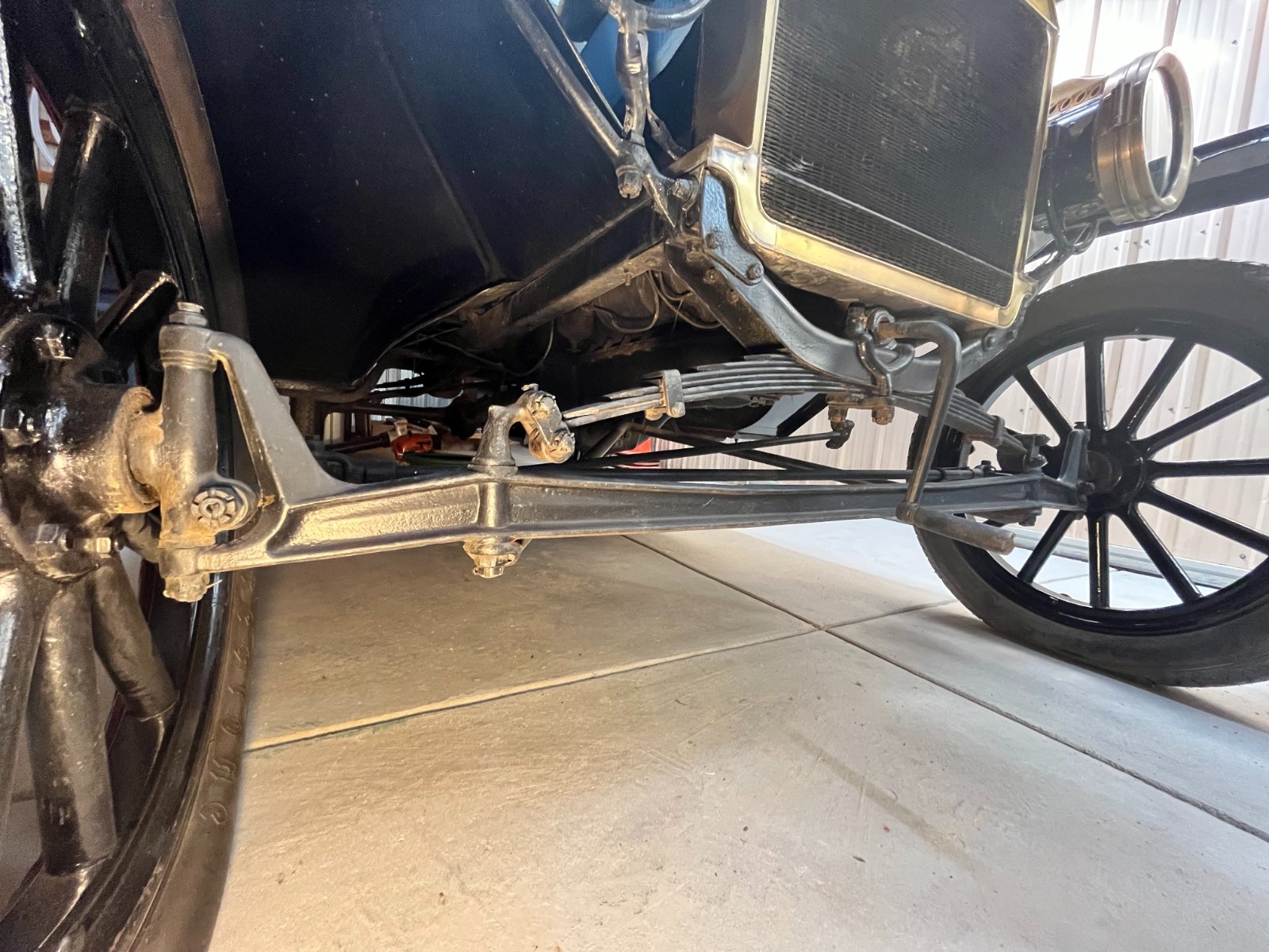

Post by fireheadman » Mon Dec 22, 2025 9:32 am
let's go this route instead.... use of a picture.
what is the name of the steel piece that spans left to right and the spindles mount to with kingpins?..... That is what I am referring to.
not sure that is a tierod. pardon the confusion and hopefully that clears up things.
Member: Mile High Pedal Pushers - Denver, Colorado Chapter
https://www.youtube.com/watch?v=e5FPWnxG_9w
Posts: 8671
Post by TXGOAT2 » Mon Dec 22, 2025 9:56 am
That is the forged steel axle. The piece in the picture that connects the top of the spring to the frame crossmember and holds the crank is for a later model car.

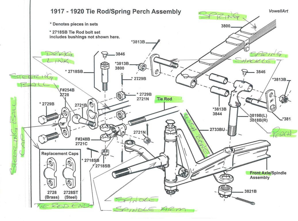

Post by Jerry VanOoteghem » Mon Dec 22, 2025 12:27 pm
Maybe this will help. Thanks to Martin Vowell for his excellent diagram, which I adulterated with my notes...
Some of these may not be the official Ford names, but most folks will understand what they mean.
T Front End.pdf
(339.98 KiB) Downloaded 86 times
