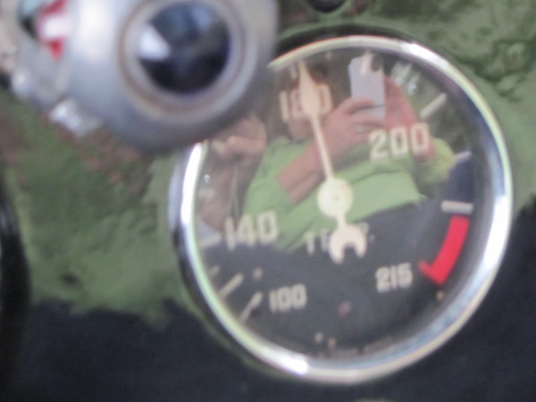

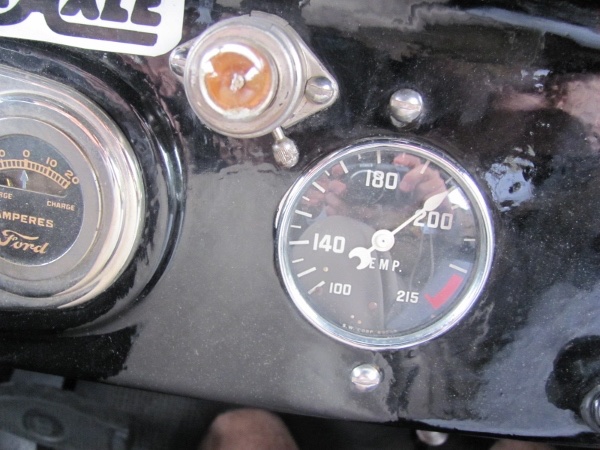

Will wrote:
Mon Dec 29, 2025 7:13 am
been an issue for some time, If I keep my speed no faster than 35mph the engine runs at normal temp. If I push the engine to 40mph it wants to run warm. The moto meter will be full red. As soon as I back down the speed she cools back down and the moto meter runs in the right range.
Have experienced the same, a good running T with same equipment, runs cool, but the motometer will show the added engine heat when running wide open on a busy road!
Installed a fairly accurate temp gage, sender in the water outlet, running normal speeds, right at 180 degrees.
Now on the open highway, speeds to 40-45, the temp will rise.
IMG_6881 (500x375).jpg (84.71 KiB) Viewed 280 times
Speed equals Heat! Slowing back down brings the temp down too.
IMG_6882 (600x450).jpg (132.25 KiB) Viewed 280 times
