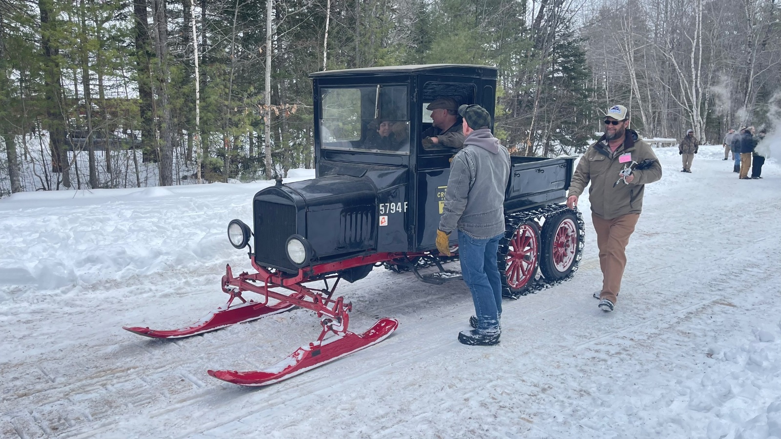

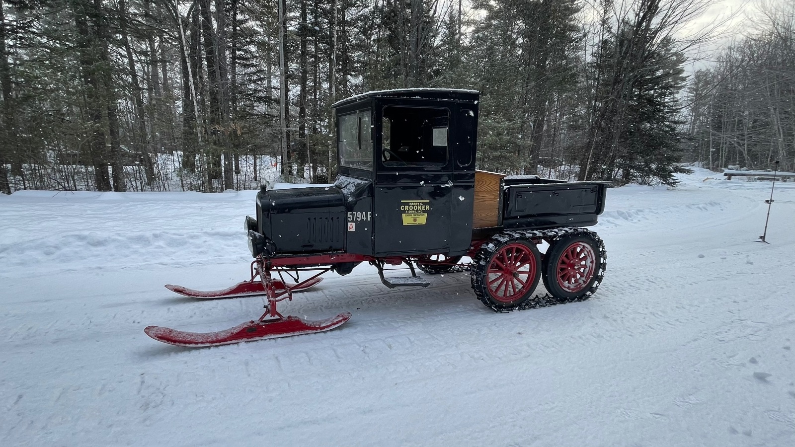

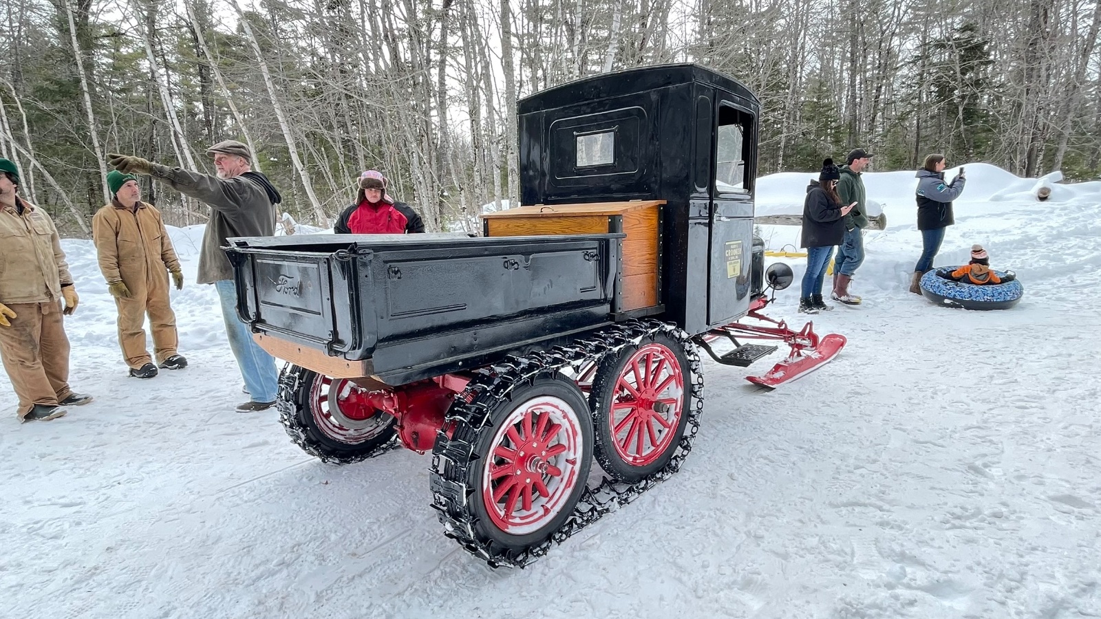

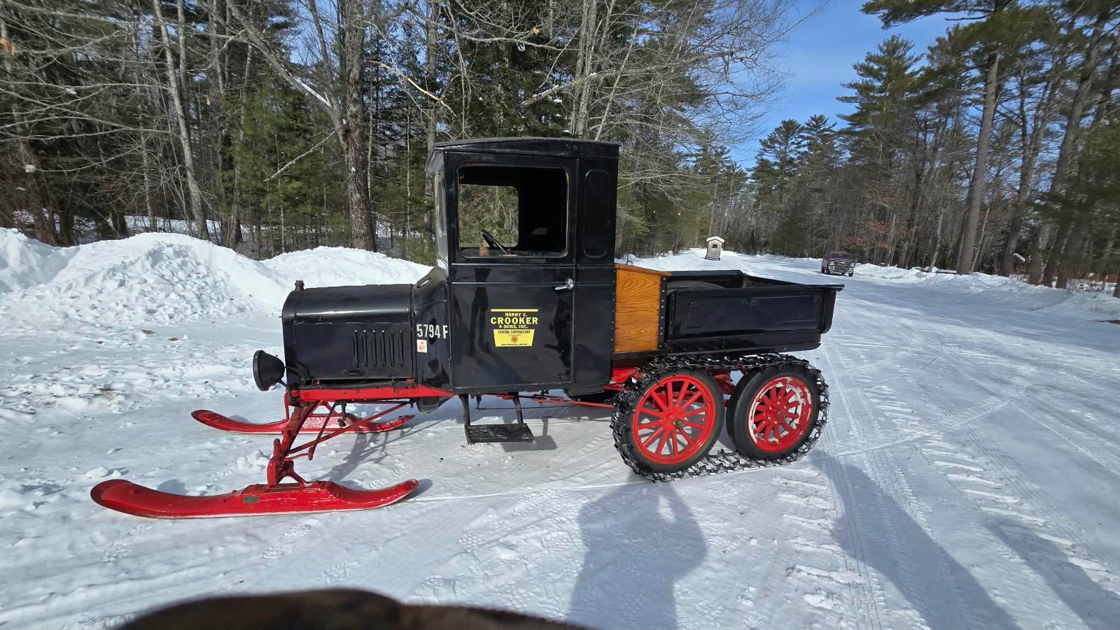

Good afternoon,
I am new to the wonderful world of the Model T. A little background: I have been involved with the Maine Forest & Logging Museum in Bradley, Maine, for quite a few years now. Back in December, we received a generous donation of two Ford Model TT trucks with Virgil White snowmobile conversions. Needless to say, we are pretty excited about this. One is a 1926, the other is a 1927. However, we suspect the 1927 is a bit of a mix and match.
We are currently working to recommission the 1927. In addition to changing out the fluids, etc., we have replaced the bands since the cotton bands were way, way beyond their expiration date. Hopefully, over the next week, we can rack up some running time to work out any remaining bugs.
We are a Living History museum, meaning that our vehicles and exhibits all function and are operated and demonstrated on a regular basis. In fact, the 1927 TT snowmobile will debut during our Winter in the Woods event on February 7th. As we move forward, we will no doubt be seeking advice.
The TT's will be operated alongside our steam-powered Lombard Log Haulers and Lombard Tractor-Trucks.

Welcome!
Those are some great TT's. My first T was a Closed Cab stake side TT.
And this beast is a hoot!!! I can only imagine what's required to crank this monster!

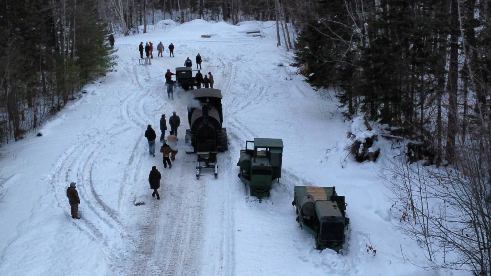

Thanks! Cranking them isn’t too bad. Here is a video of a cold start of the 1919 Lombard. The engine is a 964 CID Sterling Model FT. Ryan was feeling strong that day. It does have electric start. It’s dialed in pretty good. Usually just a couple rolls and it’s bellowing to life. Loves lots and lots of gasoline!Daisy Mae wrote: ↑Thu Jan 22, 2026 3:49 pmWelcome!

Now I have to convince my wife that coming to Maine in the winter is a good idea…
Wonderful to see them preserved and available to be admired
Feel free to post pics for those of us too far away to visit easily

In addition to the two model TT snowmobiles, we were also gifted a 1914 steam-powered Lombard Log Hauler restored by the late Harry Crooker. It’s been on loan to the museum since 2013 and is now a permanent part of the collection.
This shares space with our 1907 steam-powered Lombard Log Hauler which is fully operational and frequently under steam and out and about during our events. On February 7th we will have it out on skis for the first time in over a decade.
We do have another Model T… to clarify, before you get too excited - it’s an eight-ton, 1928 Lombard Model T dump truck. It’s an interesting beast. It has a four speed Cotta transmission. However, reverse is in the differential and is engaged with a separate lever so you have four speeds forward and in reverse. The hoist is a Garwood mechanical unit. From time to time it does make itself useful.

Well.. yesterday’s “Winter in the Woods” event went very well. We had over double the number of visitors from last year, the weather cooperated, we met many new friends and everyone seemed to have a fun time.
The TT snowmobile was a big hit and ran pretty good. It seemed to be improving as we went through the day. However, on the last run the magneto quit and when we went to start it the starter locked up. Tim performed a bit of investigating and found one of the magnet clamps wedged in the bendix! Needless to say, it was towed back to the its storage space (with the Warford in neutral) and ended the fun with the model TT for awhile.
We will need to pull the motor, assess and damage and dive into the magneto. While we are there, we will access if we need to rebuild the engine as well.
This was the first time since 2015 that we had the 1907 steam-powered Lombard Log Hauler out in the winter as it was originally designed to be. It was late in the day so it’s kind of dark and the crowd had thinned out but here we have the 1919 and 1934 Lombard Tractor-Trucks along with the steamer and the model TT. at this point we where trying to diagnose the problem.
Running old vehicles and equipment is always a challenge but it keeps life interesting!

A few more photos of the TT out and about before it became unhappy.

Steam powered equipment is wonderful, but deadly dangerous if not handled correctly. Boilers can explode with incredible force.

Yes they can. The original boiler was made in 1907 and was lap seam which is not legal here in Maine to run in public. It was also well beyond its life span. The current boiler was fabricated in 2013 to ASME code. It undergoes a State boiler inspection every year. We are very careful in regards to water treatment and layup. Our operating crew includes four licensed boiler operators.
It’s an amazing machine to operate.
