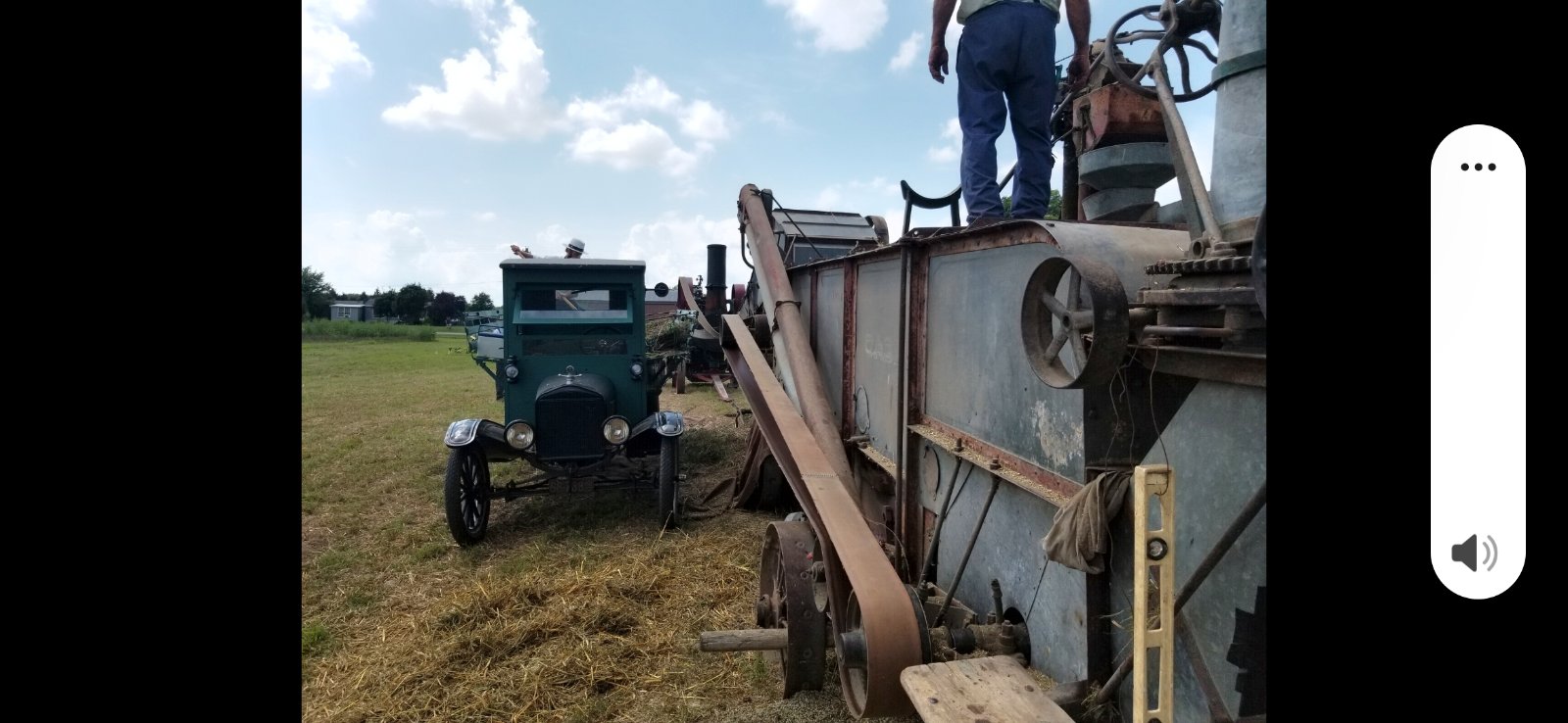

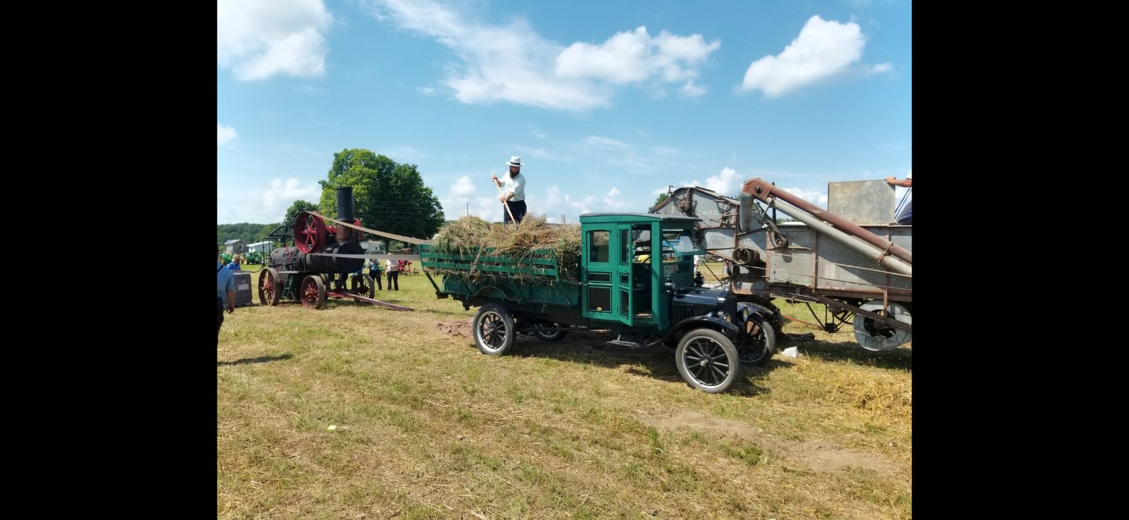

I am new to the wonderful world of the Model T. A little background: I have been involved with the Maine Forest & Logging Museum in Bradley, Maine, for quite a few years now. Back in December, we received a generous donation of two Ford Model TT trucks with Virgil White snowmobile conversions. Needless to say, we are pretty excited about this. One is a 1926, the other is a 1927. However, we suspect the 1927 is a bit of a mix and match.
We are currently working to recommission the 1927. In addition to changing out the fluids, etc., we have replaced the bands since the cotton bands were way, way beyond their expiration date. Hopefully, over the next week, we can rack up some running time to work out any remaining bugs.
We are a Living History museum, meaning that our vehicles and exhibits all function and are operated and demonstrated on a regular basis. In fact, the 1927 TT snowmobile will debut during our Winter in the Woods event on February 7th. As we move forward, we will no doubt be seeking advice.
The TT's will be operated alongside our steam-powered Lombard Log Haulers and Lombard Tractor-Trucks.

Seeing these machines work is a joy. My TT does its job when needed.Screenshot_20260202_143757_Gallery.jpgScreenshot_20260202_143814_Gallery.jpg
That is awesome!
