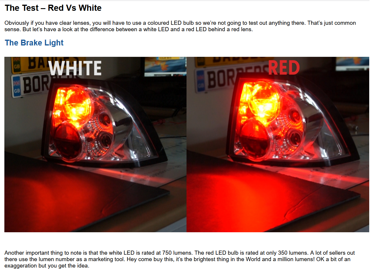

We had a specialist light guru address our club meeting recently. I found this disclosure very interesting. A white LED will transmit just a small percentage of its output through a red lens, that part of the light spectrum which is red. Remember ROY G BIV from school days. Only the red portion of the spectrum is transmitted by a red lens. You need red LED led lamps is you want maximum output from your tail lights. All the output from a red LED is transmitted through a red lens. It makes sense to me, but what do I know? His demonstration certainly showed same to be real.
- Posts: 6609
Re: LED Tail Light Lens
After reading these articles I'm thinking of doing a test. The lens in the repro taillight is a bit of a dark red color so...?
good article about Red or White LED bulbs https://www.autobulbsdirect.co.uk/blog/ ... -red-lens/

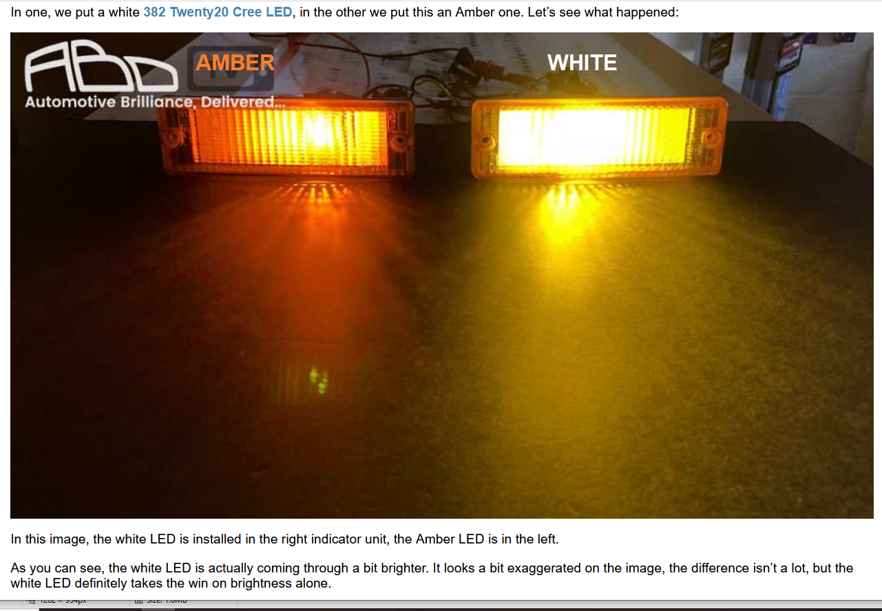

Another one of theirs Amber vs White LED Bulbs https://www.autobulbsdirect.co.uk/blog/ ... ith-video/
