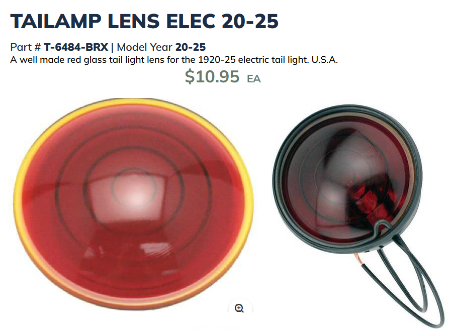

- Posts: 6608
Re: LED Tail Light Lens
Bulb part numbers identify functionality not and socket configuration although they default: 1156 is a single-filament, single-intensity bulb (used for reverse/turn signals) w single contact; 1157 is 12V a dual-filament, dual-intensity bulb (used for tail/brake lights) with two bottom contacts. Its 6V version is an 1154.
Socket configurations BA14 (horizontal Pins, single contact); BA15D (horizontal pins. double contact) & BAY15D (off-set pins, double contact).
1157 12v (1154 6v) tail/brake light bulbs normally come with a BAY15D base (off-set pins). 1188 12v (1158 6v) tail/brake light bulb with BA15D Base (horizontal pins).
Light brightness is measured in Lumens or CP (candle power). Light Color (warm 3500k to daylight (6000k) is measured in Kelvin.
For the stock dark red lens a 6000k bulb will appear brighter than a 3500k bulb even for the same amount of Lumens
Wattage is what causes the ammeter to show the amount of load on your electrical system. That's why LED's (1 -2 watts) are preferred over filament bulb (5 watts).
BUT the simple solution is to replace the lens with one that isn't so dark to start with
https://www.snydersantiqueauto.com/prod ... &cat=41888
