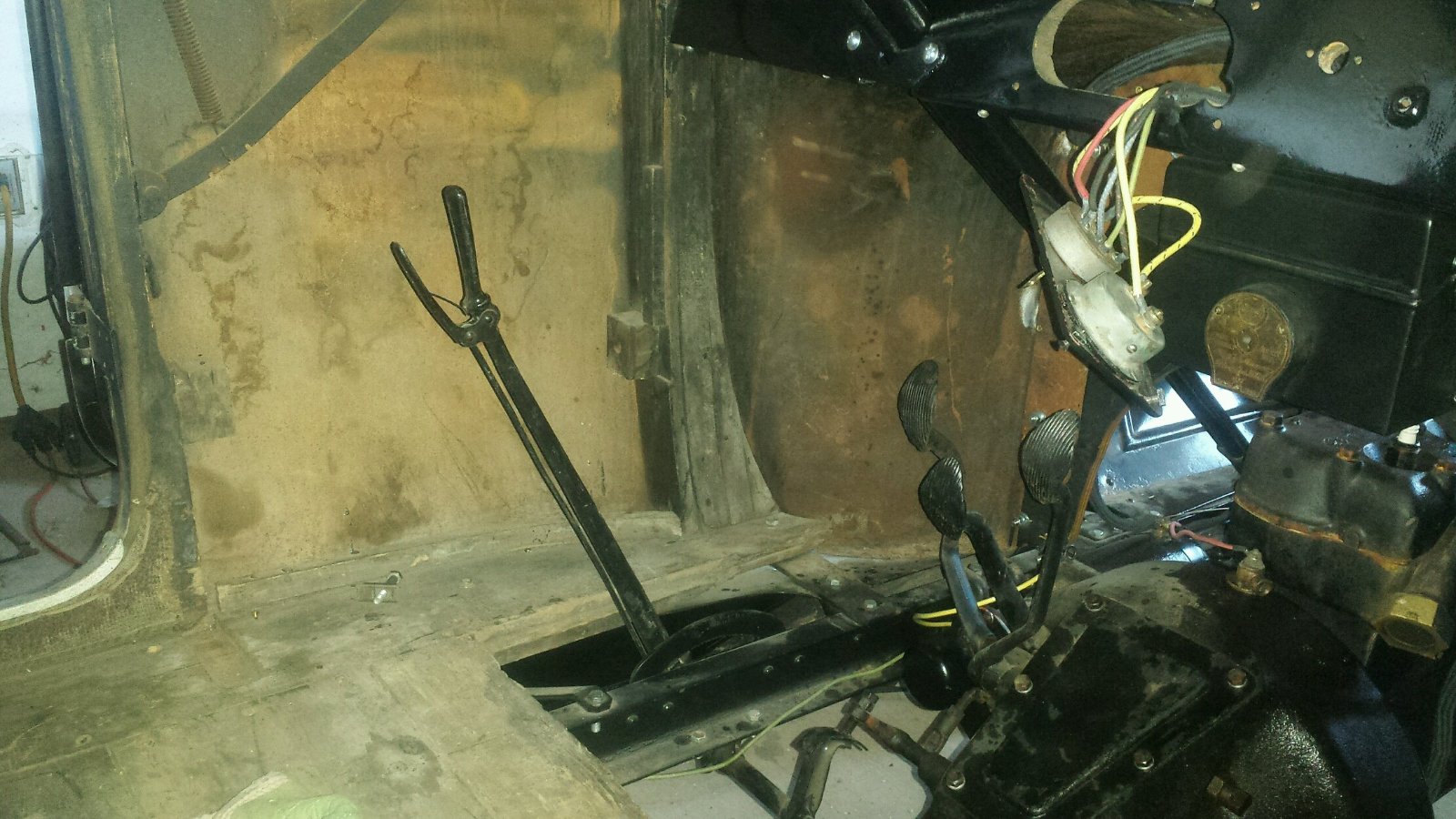

I have attached a couple of pictures of the floor on drives side. I have no idea what I need to support the floor where it angles up and fits around the pedals up to the fire wall ???????????????? Any information would be very helpful .
Thanks Mike

I have a '22 Coupe and in that area to support the floor boards are wooden supports attached to the side. They rise at an angle to hold the edge of the floorboard. I'm sure yours is very much the same. I will try to remember to get some pictures tomorrow and post them if I can. Most of my rebuild photos were lost when my computer crashed several years ago.

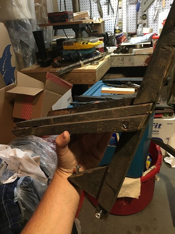

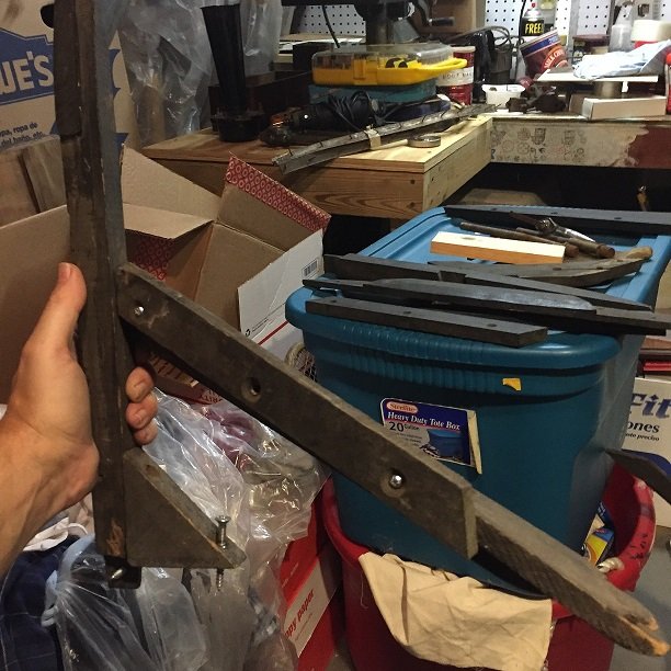

I've been ogling your center door since I found it on Craig's List the first time you listed it. You are missing a "frame" of wood. The frame sits behind the firewall and has angled boards running towards the front seats. These are what the floorboards rest on. Will Vanderburg posted these photos. Thank You, Will.

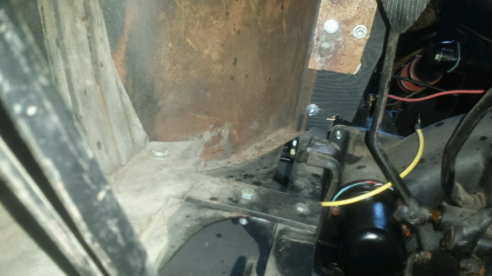

You're also missing a metal support bracket that screws to that front pillar upright to the frame rail.

and there also seems to be an "ear" of wood missing that goes all the way up to the front of the metal cowl piece.

Thanks. Now have have a good idea of what I need. I do have some wood in a pile of stuff.
Thanks again for the pictures and information.
