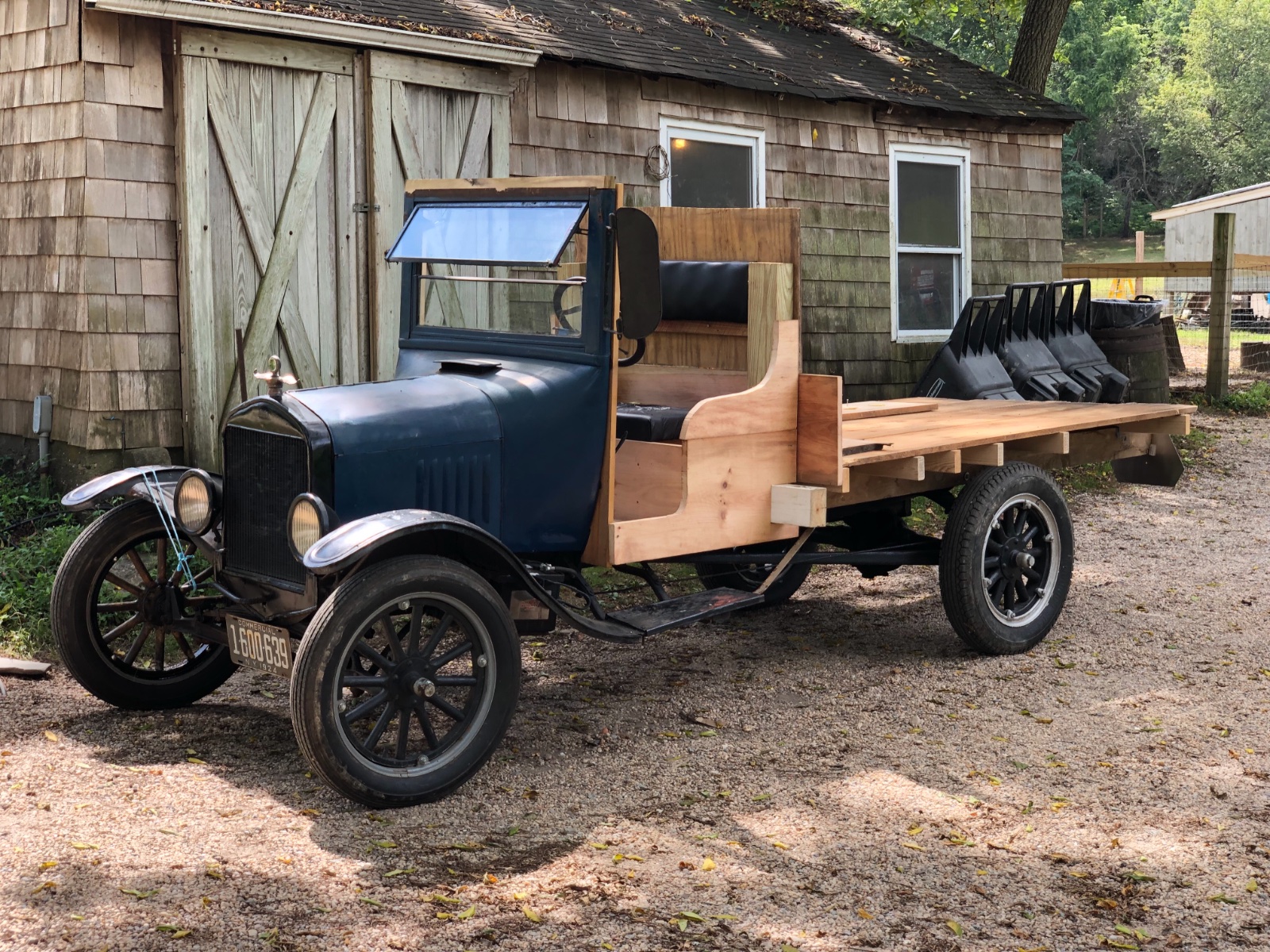

I have been helping my friend Bob Benner work on his TT truck that he acquired earlier this year. It is a work in progress that he hopes to give a new life and use as a truck around his farm also to give hayrides and take to the occasional parade and such. It has a ruckstell rear end that I believe has the five to one gears in it. It has the later Style shift lock assembly so at this point I am assuming it's a later model rear end. After we initially got it running the rear end seemed to shift as it should. Since then Bob has been working on it and learning to drive it around his farm, now the problem is that the rear end does not want to go into high gear only low gear and the dreaded neutral that we understand it should not really have. We have not started the teardown yet it is still under the truck, work should start sometime in the near future. My question to those of you TT truck owners or others who have worked on these truck ruckstell rear ends, we are wondering what the more common causes of this problem might be and what we should be looking for. I am familiar with the standard car rear ends but haven't been into a ruckstell yet. Bob has the Ruckstell axle book written by Glenn Chaffin and I have started to read through it to familiarize myself. Also wondering if anyone manufactures replacement parts for these rear ends or if we need parts are we looking primarily for good used parts. Also to those that will tell us these rear ends should have auxiliary brakes Bob has already ordered and received Rocky Mountain brakes that we will be installing as part of this rebuild. Thank you in advance for any input and insights you may be able to give to us with this project.

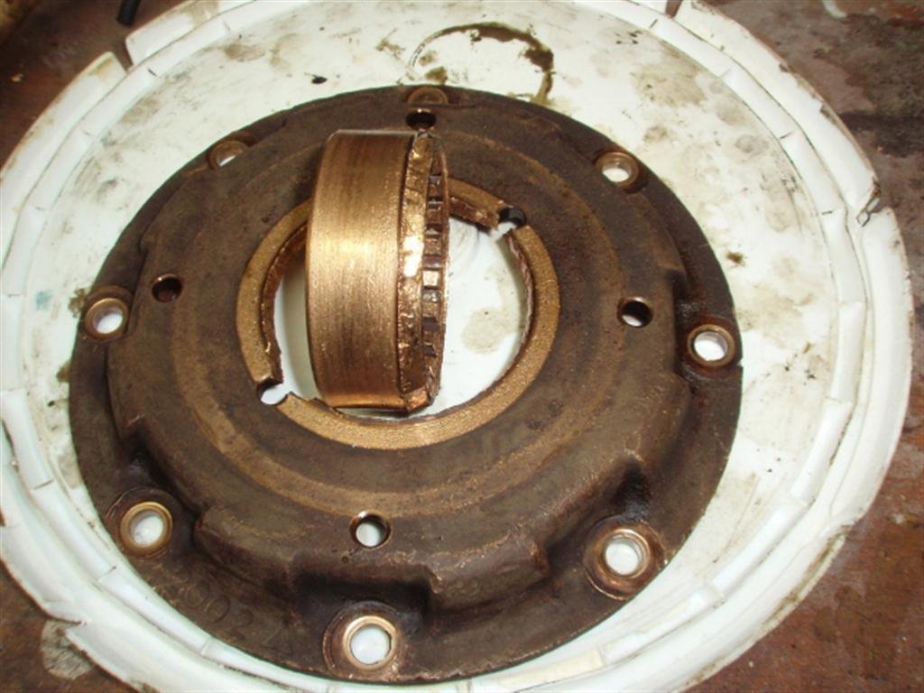

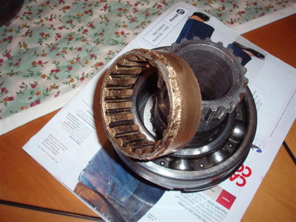

Could be a broken bronze gear casting. That broke on my TT and I had the same problem - no more standard drive, only low.
It also gives a nasty 'neutral' if you shift into standard, no braking either in that case.
Tear down and see if you can replace the casting if possible. It usually cracks near the hub (see picture).
A MUST is to get the MTFCA booklet on Ruckstell rebuild. FOLLOW it carefully and you won't go wrong.
