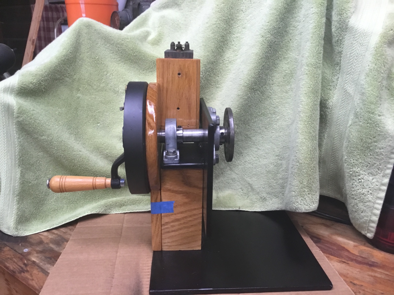

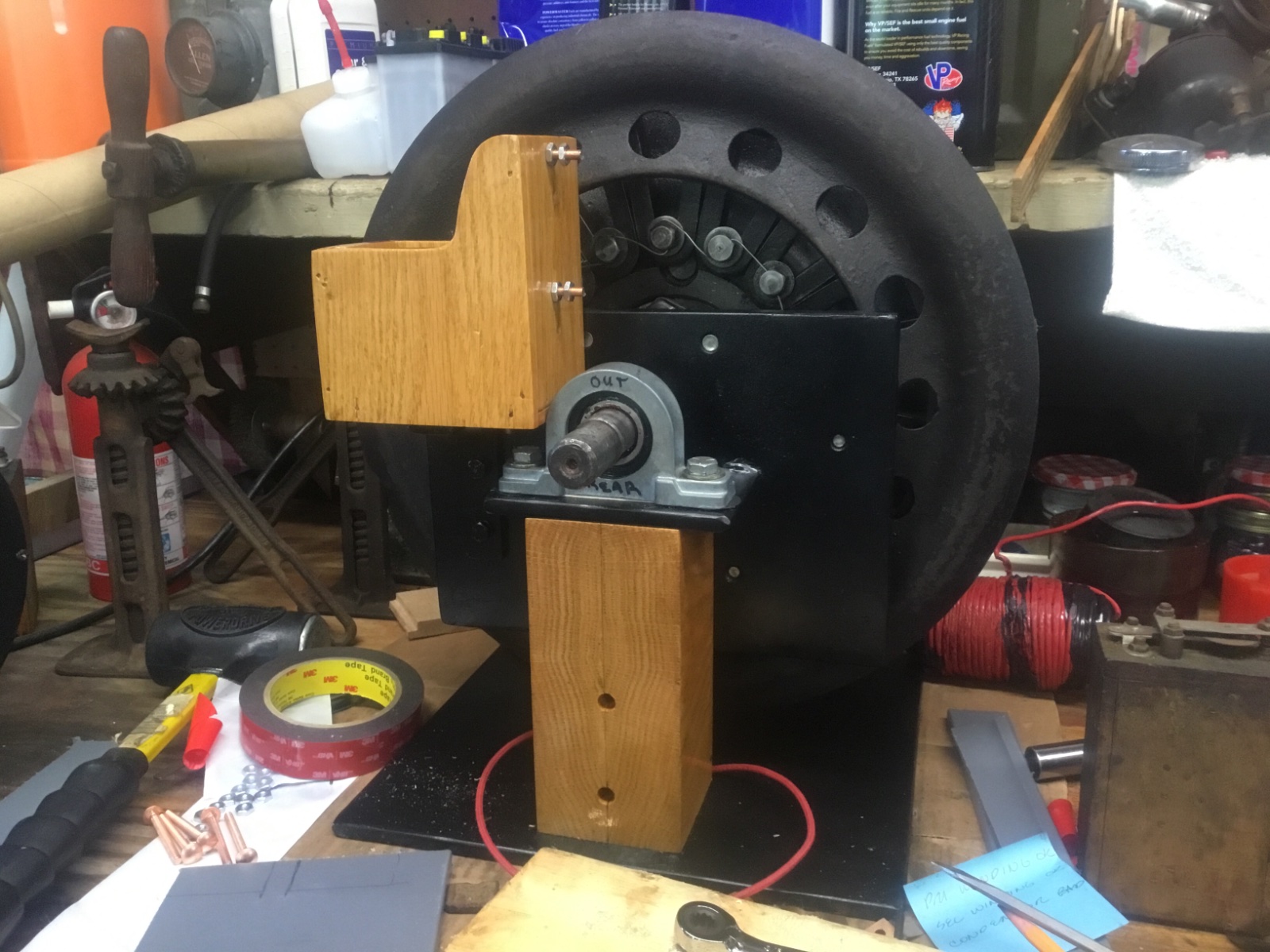

Starting to get an idea of what this is going to look like. Today I mounted the big parts, flywheel and field coil, and am still working on alignment. As a side note, if you’ve never lifted one, these things are heavy, so final assembly will happen on it’s work stand. I’m not sure where the meters will end up, but the photo shows one possible location. None of the wooden parts are permanently installed yet.
BE_ZERO_BE
- Posts: 662
- First Name: BOB
- Last Name: CASCISA
- Location: POULSBO, WA
Re: Home-Built HCCT Project

This looks amazing! You are showing the work of a true craftsman. It makes me tempted to make one, especially since I have all the T parts needed to make one. But on the other hand I am considering a ECCT. Looking forward to see more progress!
Matt

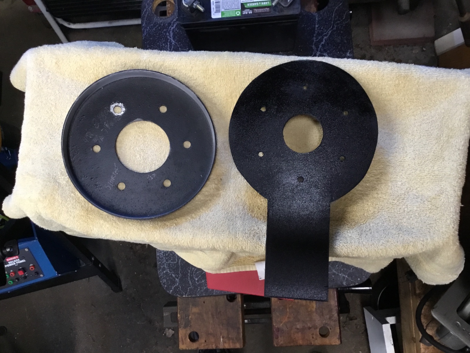

Before it gets painted black and covered by the drum, I wanted to show those following along the insulator I made from my wife’s cutting board. After trying to make the hardwood version fit, I decided to follow Gary Tillstrom’s recommendation to use the thinner plastic board instead of wood. It fits perfectly and seems like a better option for those planning to build one of these.

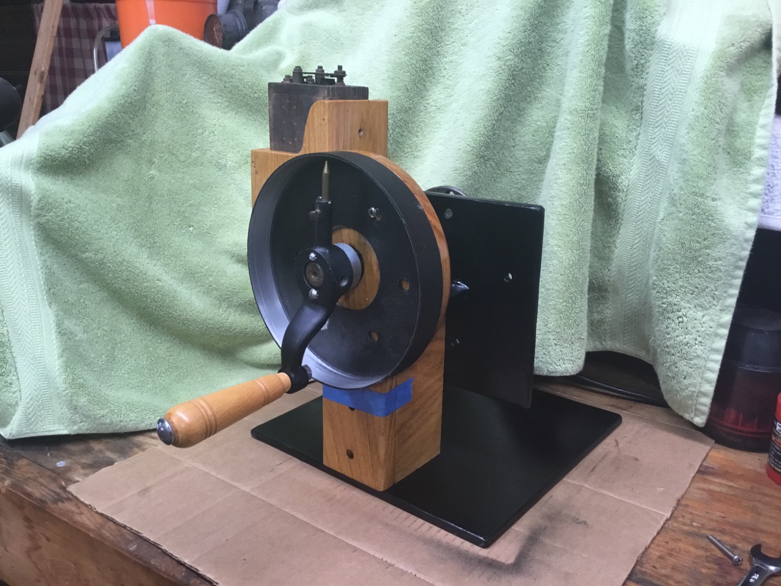

Here is the drilled and painted back-panel for the brake drum. I’m using transmission cover screws to attach the drum to the panel. They fit perfectly, although one screw will have to be longer to attach wiring to the back of the drum. The larger holes in the drum give you some wiggle-room to center it up around the “crankshaft”. Waiting for screws, wire ends, etc, to come in the mail today or tomorrow. Almost done.
tgiro
Topic author - Posts: 53
- Joined: Mon Jan 07, 2019 7:09 am
- First Name: Joseph
- Last Name: Amara
- Location: MA
The remaining parts came in the mail, so the insulator board and brake drum are installed. Here are a couple of photos, one with and one without the crank. The shiny hole in the drum is where the wiring will be connected at the back. All that’s left to do is to hook up the wiring and mount the meter. (Pardon my messy work bench.)

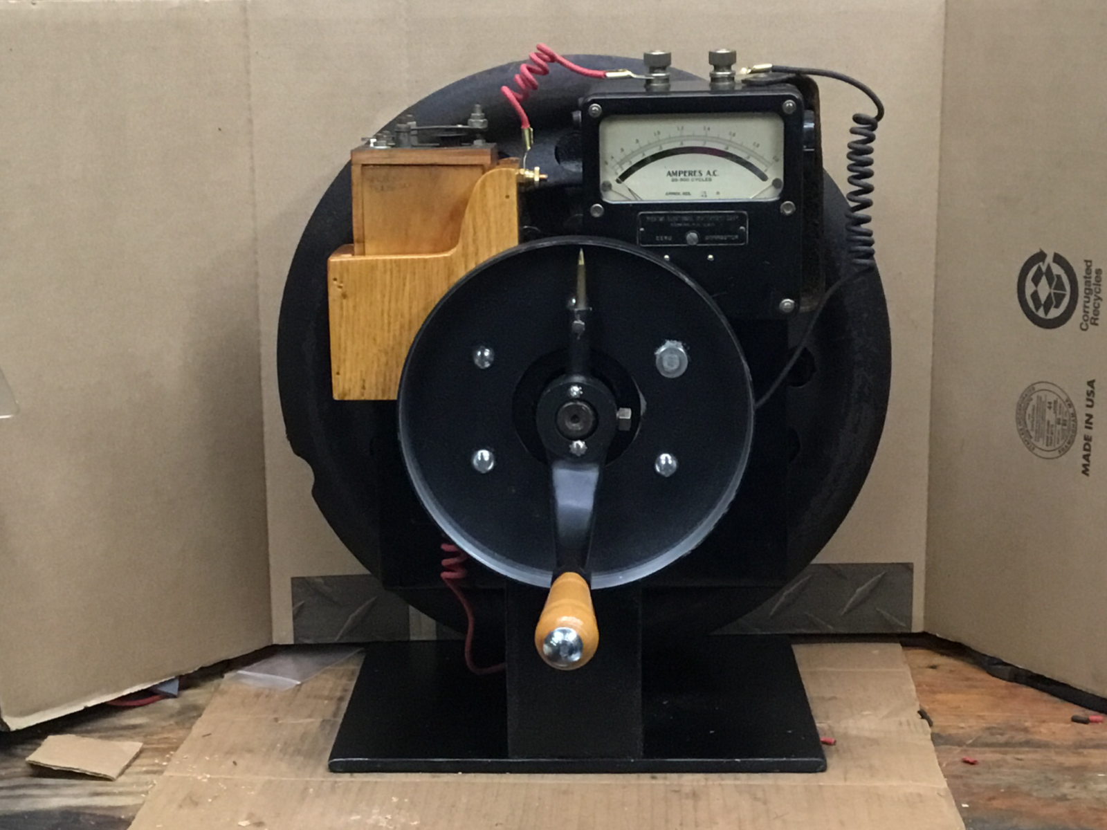

For all who showed an interest in this project, I’m happy to say the HCCT is finished. I finished wiring tonight, stuck a coil in the box, and presto . . . sparks. The ammeter is working fine, but the sparks around the drum are a little inconsistent. So there’s still some cleaning and adjusting to do, but I’m done for the day. Thank you to all who followed along and to those who provided parts, advice and encouragement. Good luck with all your Model T projects. Regards, Joe

Hi Joseph.
A beaut project well done, congratulations, -BUT- as you said this unit will only show if the coil sparks.
With your high tension (SPARK) set up, you cannot set the coils visually for correct timing, You cannot read the sparks as is, or I would not be able too. May be one of the coil professionals will chime in.
Again, a well done project, congrats ......Neil.

Hi Neil, Thanks. I bought a length of uncut spark/magneto wiring a couple of years ago while gathering supplies for this project. To be honest, I thought I could get away with this wiring as it’s easier to work with. Wrong. I’ll be upgrading it soon. Thanks again. Regards, Joe

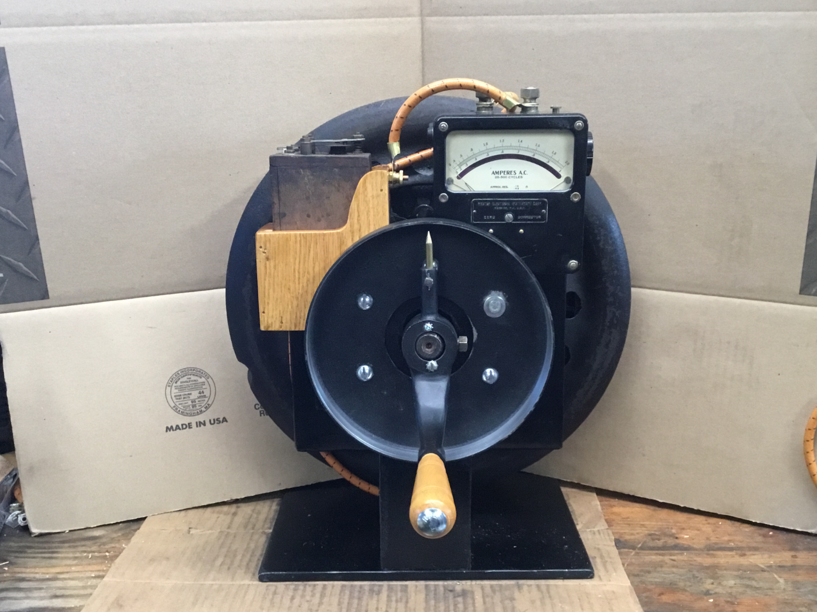

As Neil noted above, I wired the HCCT incorrectly in the above photo. After taking another look at the wiring diagram provided by Ron Patterson, I have rewired it correctly and it is functioning properly. As soon as I have a chance to neaten up the wiring job, I’ll post a photo of the corrected setup to avoid confusion for anyone undertaking a build. Thank you to Neil for pointing this out. Regards, Joe

As promised, here is a photo of the tester in it’s final configuration. Again, thanks to all. Regards, Joe
