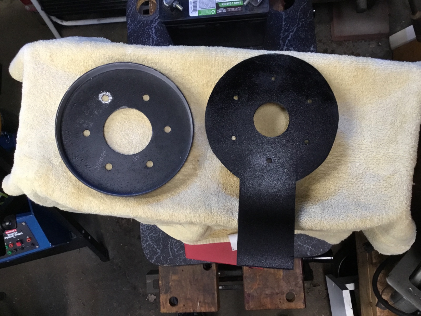

Here is the drilled and painted back-panel for the brake drum. I’m using transmission cover screws to attach the drum to the panel. They fit perfectly, although one screw will have to be longer to attach wiring to the back of the drum. The larger holes in the drum give you some wiggle-room to center it up around the “crankshaft”. Waiting for screws, wire ends, etc, to come in the mail today or tomorrow. Almost done.
