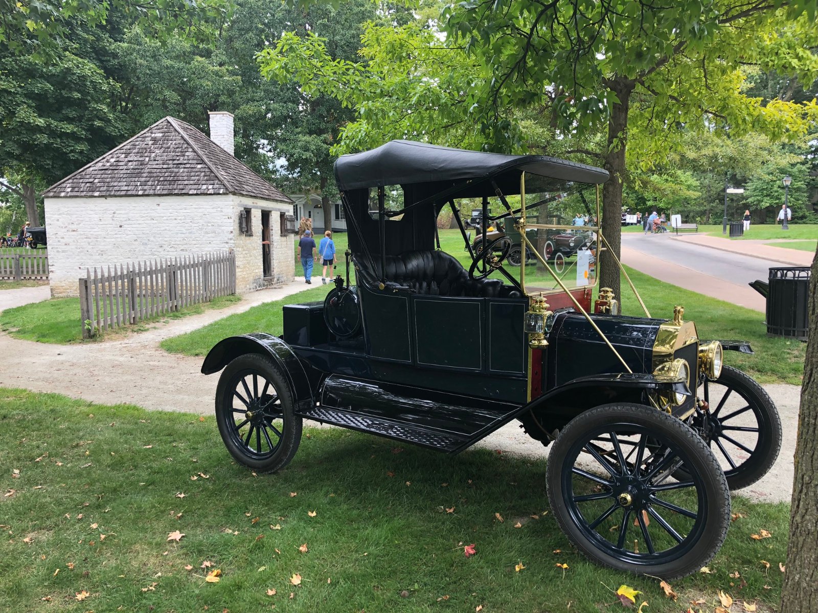

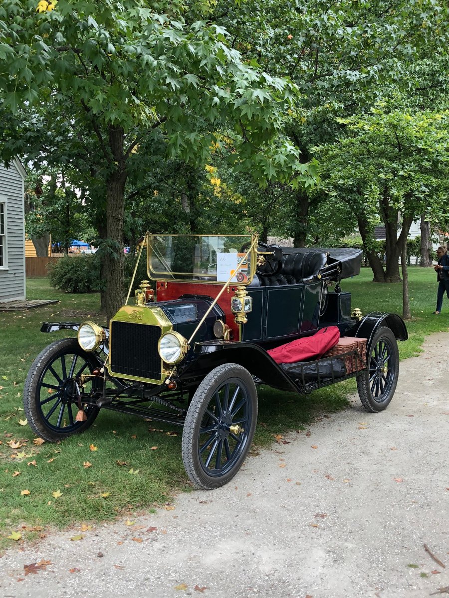

Update. The model is pretty much complete. The brass details (headlamps, side lamps, horn, etc.) were done by eye based on photo references. Headlamps are Jno Brown Model 19, side lamps are Atwood Castle 204. Horn is double twist. From what I've read, there was a lot of variety when it came to these things and no real standards. Next steps are UV mapping and shading. I'm planning to use this set of photos as a guide as the finish appears to be historically correct: https://rmsothebys.com/en/auctions/pg19 ... out/775098. (With the exception of the dash, which should be painted black inside and out, correct?)
Steve
billgall
Posts: 5
Joined: Fri Apr 19, 2019 1:15 pm
First Name: Bill
Last Name: Gall
* REQUIRED* Type and Year of Model Ts owned: 1912 Torpedo, 1915 Touring
Location: Indiana
Re: Digital model of 1912 Torpedo
Post by billgall » Sun Sep 29, 2019 9:14 pm
No, the dash is not painted black, it is stained cherry.
You can also reference my 1912 Torpedo at this year's Old Car Festival. Other than the accessory magneto headlights, it is correct for a late 1912 Torpedo (note the horn bulb is mounted inside the door as opposed to the earlier 1912 cars).
