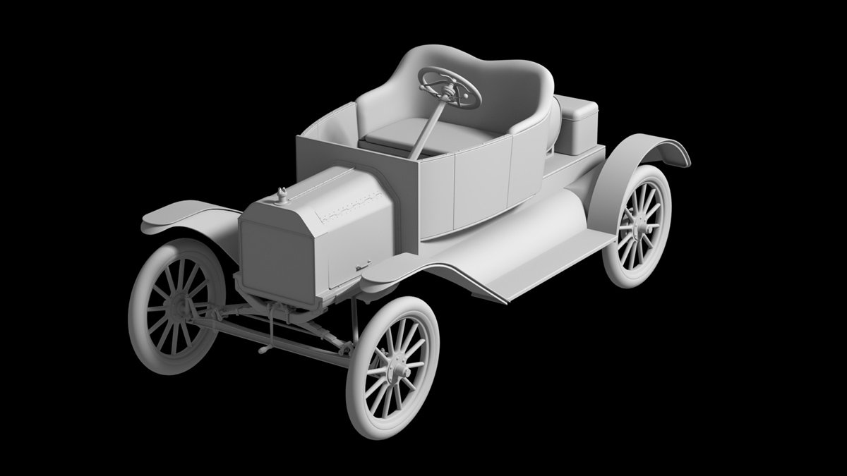

A few weeks ago I posted a question here to ask about 1911 Torpedo drawings needed to make a digital 3D model. First, thanks for all the responses here and others that I received by email. Several people have been very helpful. Second, as it turns out full drawings of that year's Torpedo do not seem to be available. But drawings for the 1912 Torpedo are, so I've decided go ahead with that one instead.
Making good progress with the chassis, hood and radiator cover complete. As work progresses on the body I'll post updates.
The model is unshaded (no surface color or texture) so renders as a light gray overall. Shading will be done once the model is complete.

Thanks, Ken. Not CAD software but Autodesk Maya, which is primarily a character-modeling application. So most of the work is done by eye using the Benson Ford blueprints as references. Try to keep accuracy to within a half-inch or so, but there are compromises here and there.

Update. Most of the body is now in place. Front fenders were the most difficult part so far. They look simple but the shapes are surprisingly complex.

Update. The model is pretty much complete. The brass details (headlamps, side lamps, horn, etc.) were done by eye based on photo references. Headlamps are Jno Brown Model 19, side lamps are Atwood Castle 204. Horn is double twist. From what I've read, there was a lot of variety when it came to these things and no real standards. Next steps are UV mapping and shading. I'm planning to use this set of photos as a guide as the finish appears to be historically correct: https://rmsothebys.com/en/auctions/pg19 ... out/775098. (With the exception of the dash, which should be painted black inside and out, correct?)

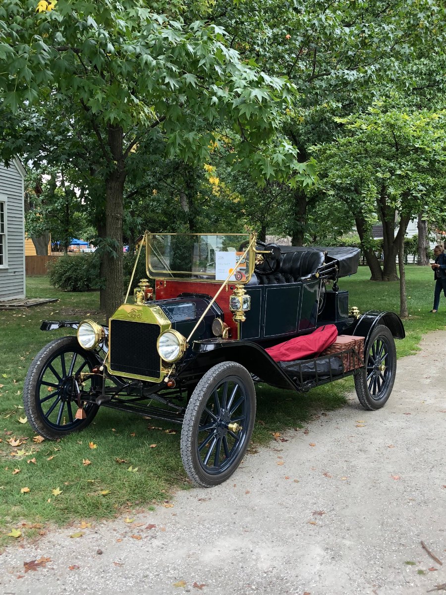

You can also reference my 1912 Torpedo at this year's Old Car Festival. Other than the accessory magneto headlights, it is correct for a late 1912 Torpedo (note the horn bulb is mounted inside the door as opposed to the earlier 1912 cars).

Finished shading the model so it's pretty much done for now. The green paint job on the body is a little too light, I know, but will be adjusted when the car is placed into a real scene. It also needs to be roughed up a bit with some dust and dirt. Let's just say for now it's just been driven off the showroom floor.

Thanks. After posting the image something made me double check the encyclopedia and, sure enough, I found that the color should be midnight blue. That's fixed.
