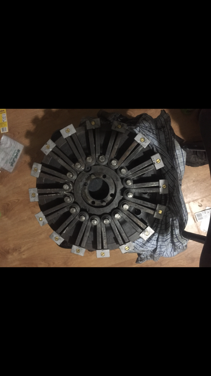

Can someone tell me if using 1912-13 long style clamp plates on my flywheel and the newer single stack mag ring could cause any problems with mag output or timing? I know this seems like a strange question but I am trying to figure out a strange problem with my mag out put. My magnets are strong, mag ring rebuilt, gap correct, little to no crank shaft end play, mag puts out about 8v at idle but never goes over about 15 at wide open throttle, with 1157 bulb, and never burns out the bulb. I have rebuilt many T engines and of course mine is the only one with this problem.

The longer keepers were designed to be used with round poles with widly spaced coils, of course, and the later short keepers were used with oval poles and very closely spaced coils. I know you know that, but am repeating for benefit of newer members here. I do not know for certain, but I really wonder if the long keepers in tandem with larger oval poles are somehow altering the sine wave of the AC output and it is not a clean or true waveform. If you have access to an oscilloscope it would be interesting to compare the wave form of a normal mag and yours.

Scott Conger, thanks for the replay I have been questioning this for a long time. My engine is apart right now do to some teeth breaking off of a reproduction trans driven gear so i will probably install the small rectangular ones.Would be really interesting to know if it makes a differance or not.

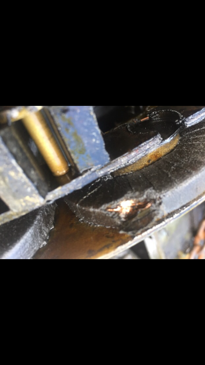

Corey Walker
- Posts: 671
- First Name: Corey
- Last Name: Walker
- Location: Brownsboro, TX
Re: magnet clamp plates
I had a clamp screw break in my 14 and it damaged one of the longer style clamps so I put an ad in the classifieds for one along with this picture. Somebody noticed the later mag ring and gave me a reason as to why it would work, just not as exactly intended. I replaced the longer style with the later ones when I put it back together. The main difference is that it’s like my 21 now. You can notice the difference in the positions on the quadrant more. The magnets weren’t recharged when I was running the longer clamps which might have had a lot to do with it but it was like a gradual advance.
