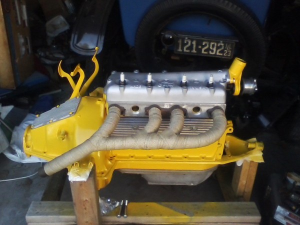

I would like to thank Mr. Joe Bell for allowing me to purchase a RHD hogshead that he had.
I am attempting to build a somewhat unique 2 person boattailed roadster/speedster (RHD, suicide doors, removable hardtop & some other modern amenities).
I am presently assembling the drive train.

The new RHD hogs head to be installed this week. Not pictured yet
