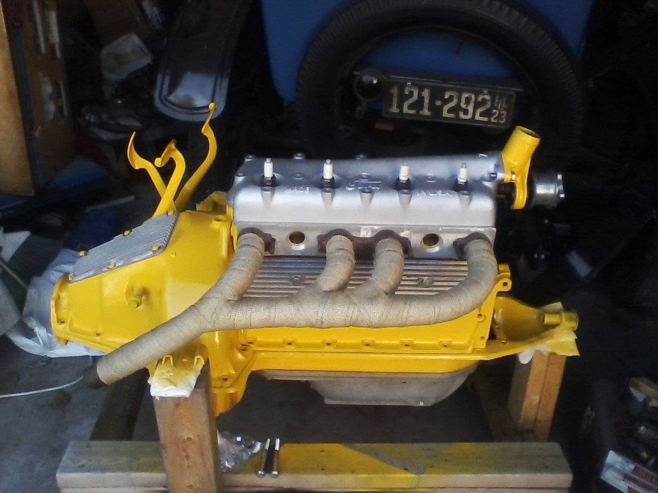

I plan on painting the "new" hogs head today and installing when dry. Using a "rattle" can off the shelf color. I will then install the front plate distributor and oil pump. I have a pump like in Hank's photos.
