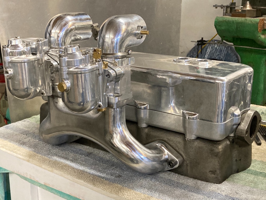

Improved Akron-Hed sanity check
This is not the first sanity check for this project... and it won’t be the last. So far every sanity check has proven that sanity has little to do with this project!

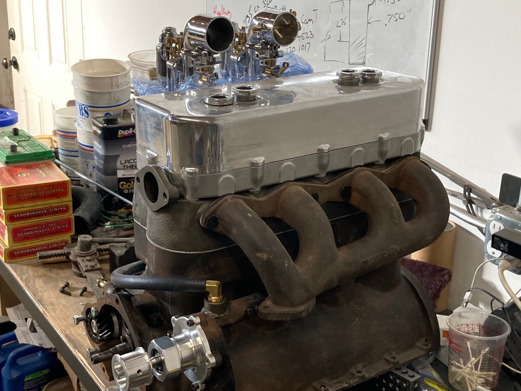

Re: Improved Akron-Hed sanity check
I like what I see .
Interesting valve layout, side to side , rather than front to back like all the other overheads ! .
It will be interesting to see how it performs .

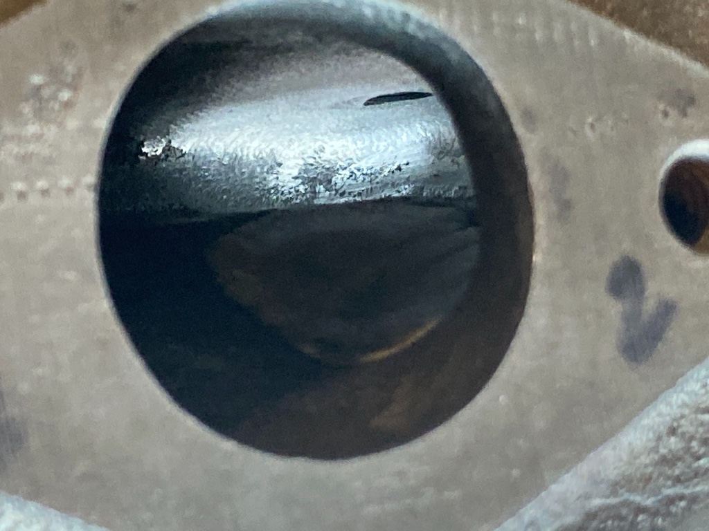

The Akron has a typical flat bottom combustion chamber just like all the other pushrod heads... and it measures a cavernous 1-5/16” deep. With a stock crank and pistons, I imagine the compression ratio would be somewhere around 3:1. And with the A crank and .060” overbore probably a staggering 3.1:1!!!
I’ve got a new set of pistons on the to-do list, lookin to maintain the 7.5:1 ratio I currently run with the flathead. Also on the list is a low lift cam to compliment the 1.5:1 rocker ratio. With the 1.750” valves, I’d like to run better than .300” lift at the valve. The plan is to work out a deal with a fella who has a flow bench. Not lookin to alter the head any, just lookin to figure the best lift for the design

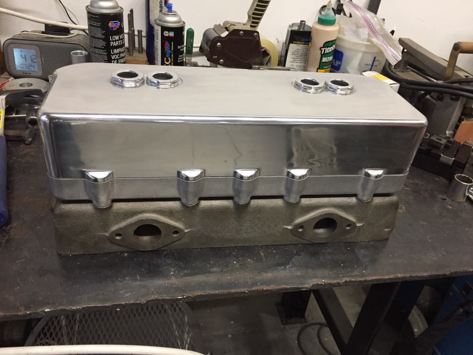

It’s no “show” polish... but it looks a whoooooole lot better than it did yesterday...!

Kevin, the (in)-sanity check looks fantastic. It would be a shame to mark up the top of the valve cover in any way, but some sort of marking to indicate who and where this set-up was conceived should be considered. You can now not tell that the cover is a 3 piece affair.

With the valve cover done... all that’s left to do is...;
Finalize the push rod dimensions
Drill the last couple mounting bolt holes in the rocker supports
Notch the rocker shafts for the clamp bolts
Drill oil holes in the rockers
Rebuild the head
Machine new keeper grooves in the exhaust valves
Order custom intake valves
Order custom pistons
Design new camshaft
Build new header and exhaust system for the car
Build new intake to fit twin carbs
Build new hood to close up old header clearance and clear new header on opposite side
Freshen up the ‘ol motor so as to make all the magic happen
Paint everything to match
And finally... convince my wife it was all worth it!!!

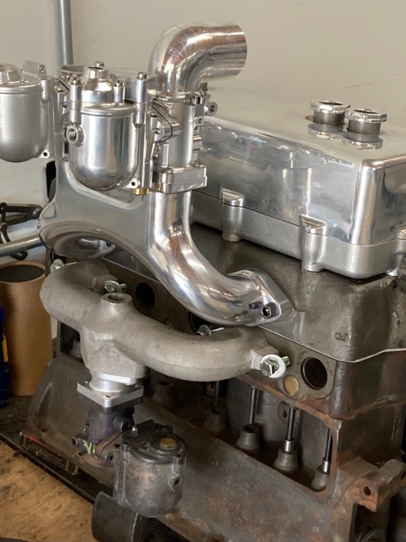

I have the original exhaust manifold... but my speedster is an outside exhaust kind of car
. So planning on building a header flange. Header and tail pipe might get interesting with the steering box, alternator, water pump, and shift/e-brake levers all on that side...

And of course, a pic of the Akron-Hed with my new manifold and carbs mocked up

Feels kinda weird working on my own stuff...
Got the bolt bosses faced to a common height so that the rocker sub plate doesn’t get twisted when torqued down. Also the valve guide bosses were trimmed to clear the stock T springs. Made spacers to shim the springs to the correct compression height. Drilled and reamed the epoxy plugs for new push rod guides. And started turning the new bronze push rod guides. Will need to sand and blend the epoxy plugs to match the port floors prior to pressing in the push rod guides

I’m officially mad at my touring car... so thought I would see if Andy’s idea had any merit. I didn’t have any OF’s laying around, but was able to cobble this up as a proof of concept
I’m gonna need some ideas on how to hook up the progressive linkage

So it turns out that it took a year to get the carbs, intake manifold, water manifold, and water pump figured out… and now it’s time to think about the exhaust.
Plan A was to build a cone header out the left side of the car. This was going to require new hood sides and mods to the body for exhaust brackets. Sounds easy at first, but a closer look revealed many complications that I simply didn’t want to get involved in.
Plan B involves using the original exhaust manifold (or a similar looking header) and routing the pipe under the car. Doesn’t seem right to hide the pipe under the car… but the manifold has a really nice shape, and won’t require much change to the car to get it all hooked up.
The Boyd water pump amazingly fits right under the manifold as tho it was meant to be there. Will be lots of clearance around the starter and my frame mounted steering gearbox too. I may loose a few cool points for staying under the hood, but it’s all fitting up nicely

Got the head off tonite and it looks pretty good in there… except for those giant scuff marks and a little water damage in the bores! Clearly I have put a few miles on the ol girl, but it’s goin to have to work for a bit longer
