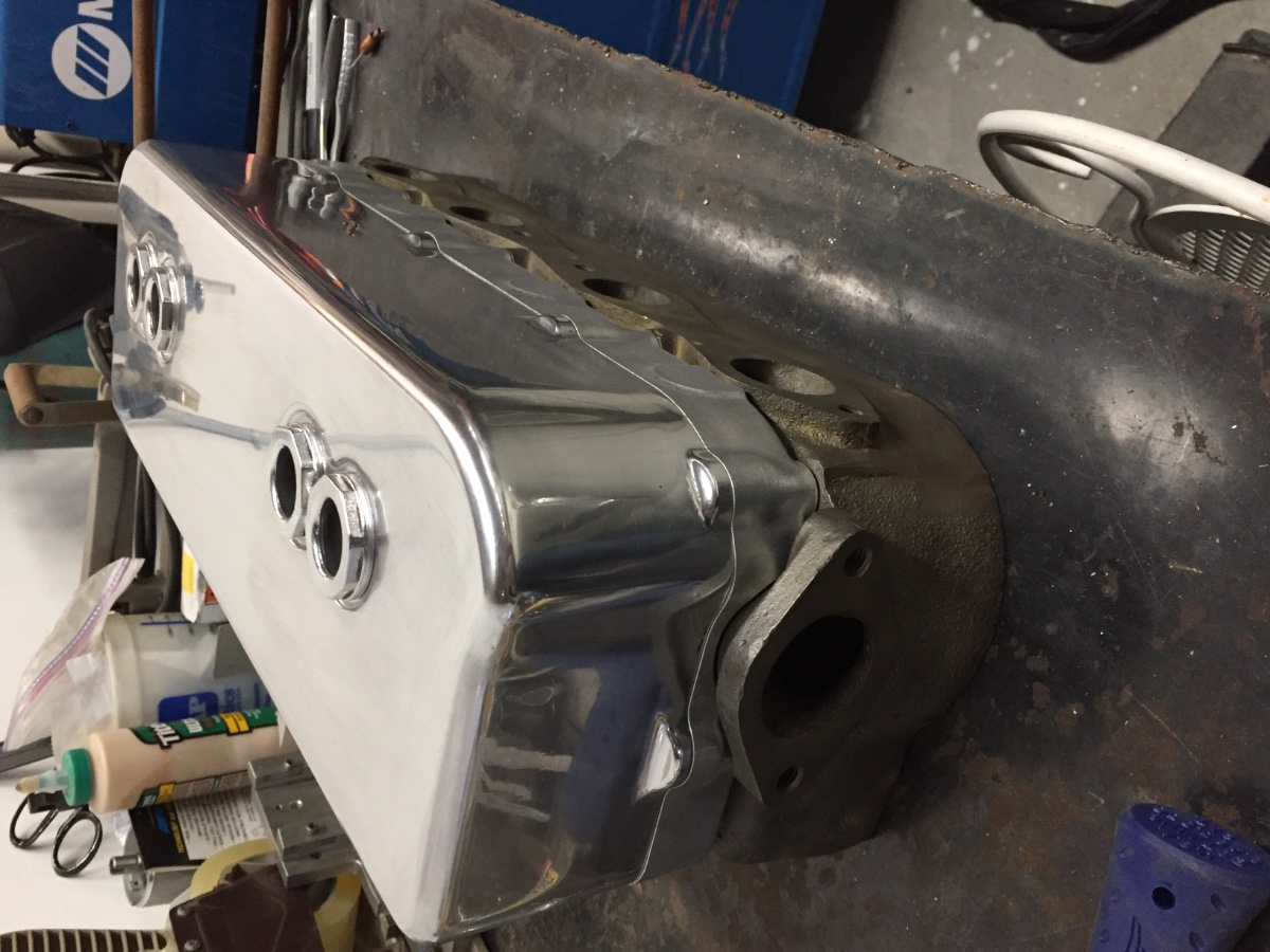

This is not the first sanity check for this project... and it won’t be the last. So far every sanity check has proven that sanity has little to do with this project! 😉
The original design;
The concept;
Up close with the rockers;
Just a bit of welding left to do on the cover;
After all the welding is done, there is just a few details to button up and it’s time to start thinking bout swapping out the ‘ol Sherman flathead 😁

I like what I see .
Interesting valve layout, side to side , rather than front to back like all the other overheads ! .
It will be interesting to see how it performs .

After a couple hundred hours designing and manufacturing the rocker system... all I can do is hope it’ll perform! So far everything looks promising as the head has many favorable design characteristics... 2 in, 4 out, cross flow, valves in line with the ports, and spark plug near the exhaust valve. The ports are relatively small when compared to other performance heads... but I think they’ll be plenty big enough to produce similar (or better) performance as the other 2 intake port overheads
Too late to give up now... I hope to have the head runnin later this year!!! That is... assuming I survive the pandemic...!?😉

It’s no “show” polish... but it looks a whoooooole lot better than it did yesterday...!😉

Kevin, the (in)-sanity check looks fantastic. It would be a shame to mark up the top of the valve cover in any way, but some sort of marking to indicate who and where this set-up was conceived should be considered. You can now not tell that the cover is a 3 piece affair.

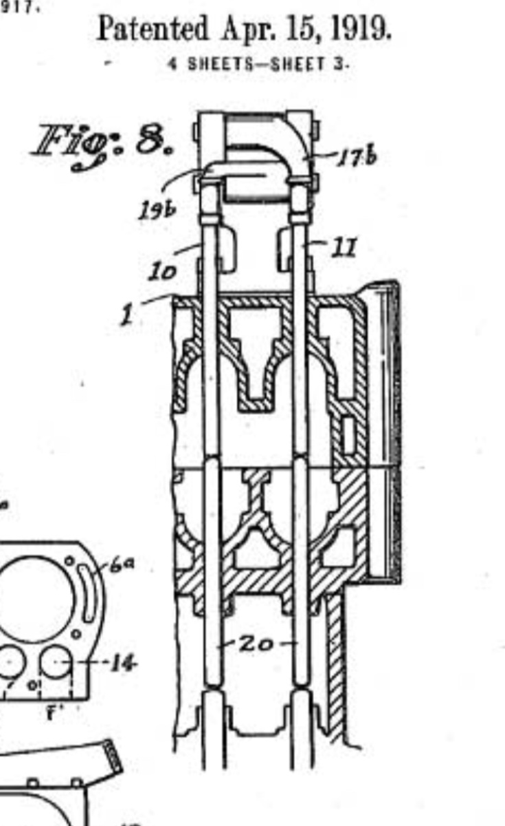

Post by Dan McEachern » Thu Apr 02, 2020 3:07 am
Some 16 Valve Roof heads used a similar arrangement on the pushrods although not that elegant.

Post by Kevin Pharis » Thu Apr 02, 2020 12:51 pm
I know that the Roof 16 used a short link to connect the rockers to the valve tips... but just found these patent drawings showing the 2 piece pushrod design used on the A version of the Roof 16 heads
The bummer about this design, is that the pushrod needs to be a tight fit in the guide to prevent vacuum leaks at the guide... but this prevents the pushrod from swinging with the arc of the rocker arm. I imagine the A version Roof 16 valve train must have been problematic at higher speeds, and all the vacuum leaks must have been a pain at idle.
The Akron has a similar design system with the pushrod exposed to the intake port... except that the Akron didn’t use a “rocker”, and so the pushrod didn’t need to swing during operation. It does have a tube installed that passes thru the intake port to pilot the pushrod, but this tube is ultimately open to the port at the bottom. I intend to fill the bottom of the port with enough epoxy to seal off this tube and eliminate the associated vacuum leaks

I have a Roof 8 (Laurel model 40) and the pushrods are essentially similar to your posting. The bottom of the pushrod essentially resembles a valve stem with a hole drilled into the top about a 1/2”. The rest of the pushrod is about 3/16” diameter and then the “cup tip” is at the top. I remade the lower stem parts (Years ago) and had to make one of the top halfs. Made that in 2 pieces and welded it together. LOTS of miles on it.
One other thing. The rocker arms are REALLY hard and long lasting material. The shafts are mild steel and are essentially a “consumable”.
I hope this helps

So... I’m finally back on the Akron-Hed track after a year and a half of machine shop confusion and carburetor creation. Spent the morning warming up the head enough to pack epoxy into the intake ports, sealing up the auxiliary intake passages that connect down into the stock intake ports in the block. When the epoxy cures, I will set the head up in the mill and drill/ream the epoxy plugs to accept new push rod tubes.
Intake
Exhaust
Kevin Pharis
Posts: 1656
First Name: Kevin
Last Name: Pharis
Location: Sacramento CA
Re: Improved Akron-Hed sanity check
Post by Kevin Pharis » Sat Jan 15, 2022 5:44 pm
And of course, a pic of the Akron-Hed with my new manifold and carbs mocked up😁

What did the auxiliary passages do?
Andy
Kevin Pharis
Posts: 1656
First Name: Kevin
Last Name: Pharis
Post by Kevin Pharis » Mon Jan 17, 2022 10:48 am
I believe that the the auxiliary passage was intended to offer a low performance carburetor/manifold/port option. The intake ports in the head could be blocked, and the stock intake manifold and carburetor could be used. Or the ports in the block could be blocked, allowing use of a performance manifold and carburetor.
This is a theory based upon the next HAL designed engine, the SOHC Model A. These heads also had an auxiliary intake port to offer 2 levels of performance. Here are pics of SOHC HAL engines at the Speedway museum showing the port options;
