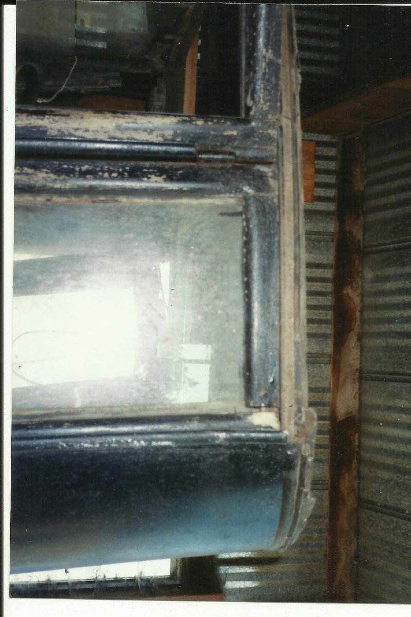

Restoring a 1920 Coupe. Looking for a source for the moldings that go around the side windows. Moldings are secured to the glass and slide in the metal channels when opening the side windows. Any help appreciated

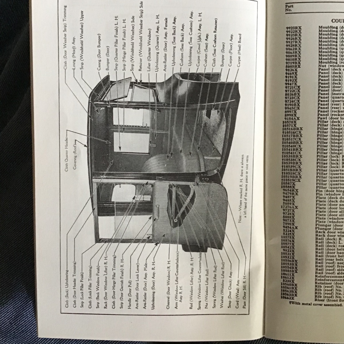

Fords body parts book showing the pre 23 Coupes interior. Don’t know if all the pre 23 Coupes were the same but the metal trim strips go around the window frames. Not sure if there were any metal strips going around the windows themselves. Click on the pic to rotate it. Sorry about that!

Wish all the photos of my 21 were not on a hard drive that crashed!
I seem to recall asking where I could get the channels that fit in the pillars because of their odd shape. The 22/23 were different the earlier coupes, they used the slotted piece on the window that the locking lever fit into instead of the lifting strap. This link might help (?)
http://www.mtfca.com/discus/messages/70 ... 1505092603
Well I stand corrected!

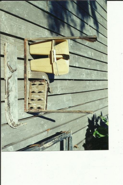

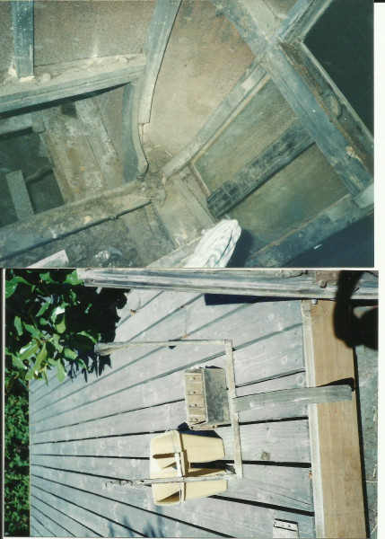

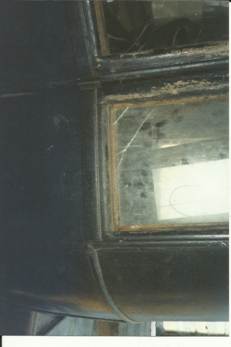

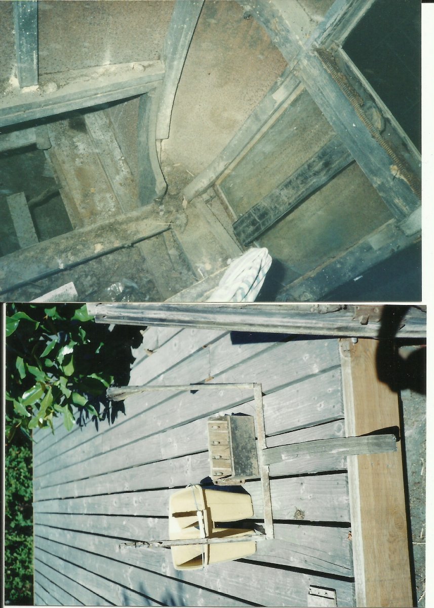

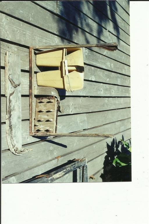

I found the photographs I took of my 21 when I was de-contructing it. I have to get my scanner re-installed and will post what I found.
- Posts: 5549
Re: 1920 Coupe Side Window Glass Molding
Not great but might help
- Posts: 5549
Before you ask, the ones shown in the photos are long gone. You might want to put ads here, Facebook, fordbarn.com etc and watch eBay. Not an item that is reproduced so you are going to have to do some searching. If you have them or samples, you may have to repair what you have or see about having them made.
