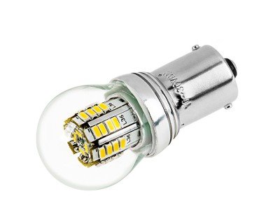

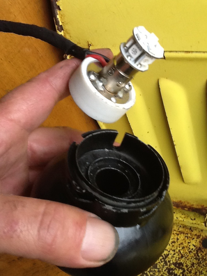

Here is the LED bulb I have in my 1919. With the glass envelope, it is less noticeable that they are LED.
Of course if you have a later car with Ford H "fluted" lenses, it probably does not make any difference.

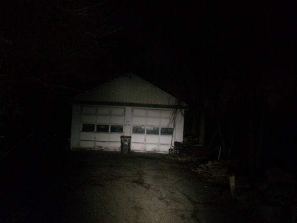

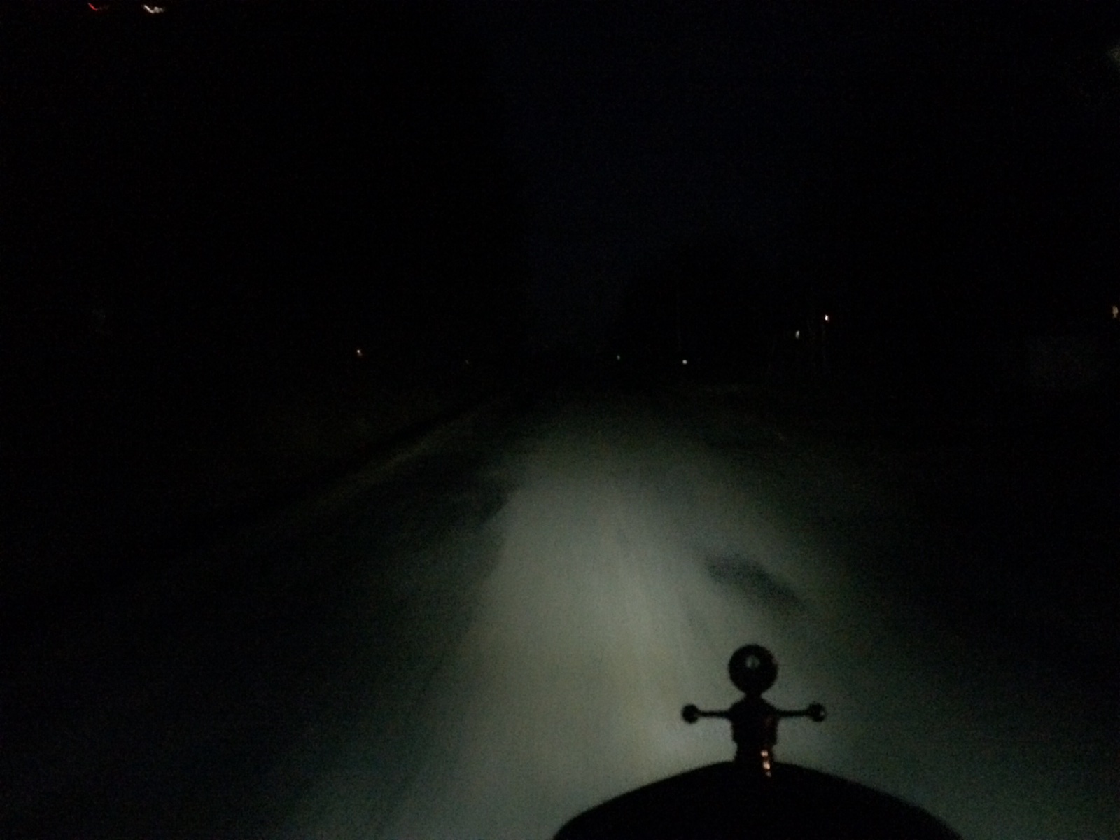

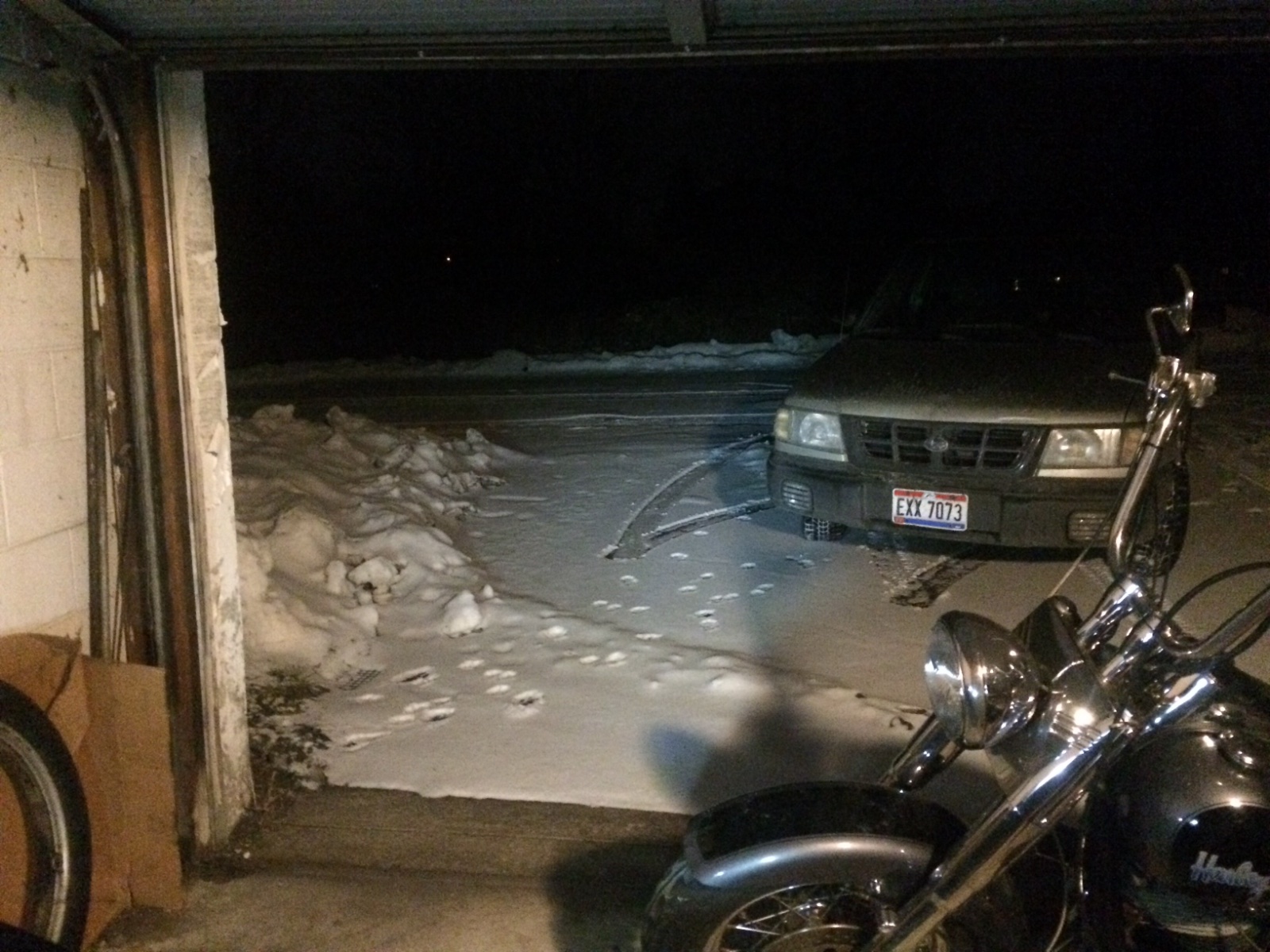

I couldn't contain myself...
Yes, I have the H glass, can't tell here, this is high. And lastly is low. The garage door opener light is all that's on otherwise. The fence is about 25-30 feet away. :D

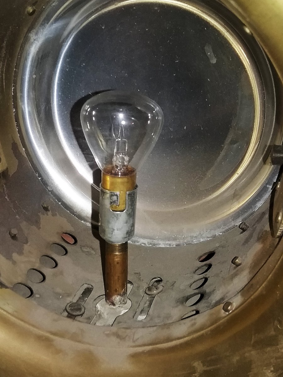

Post by KWTownsend » Sun Feb 03, 2019 10:59 pm

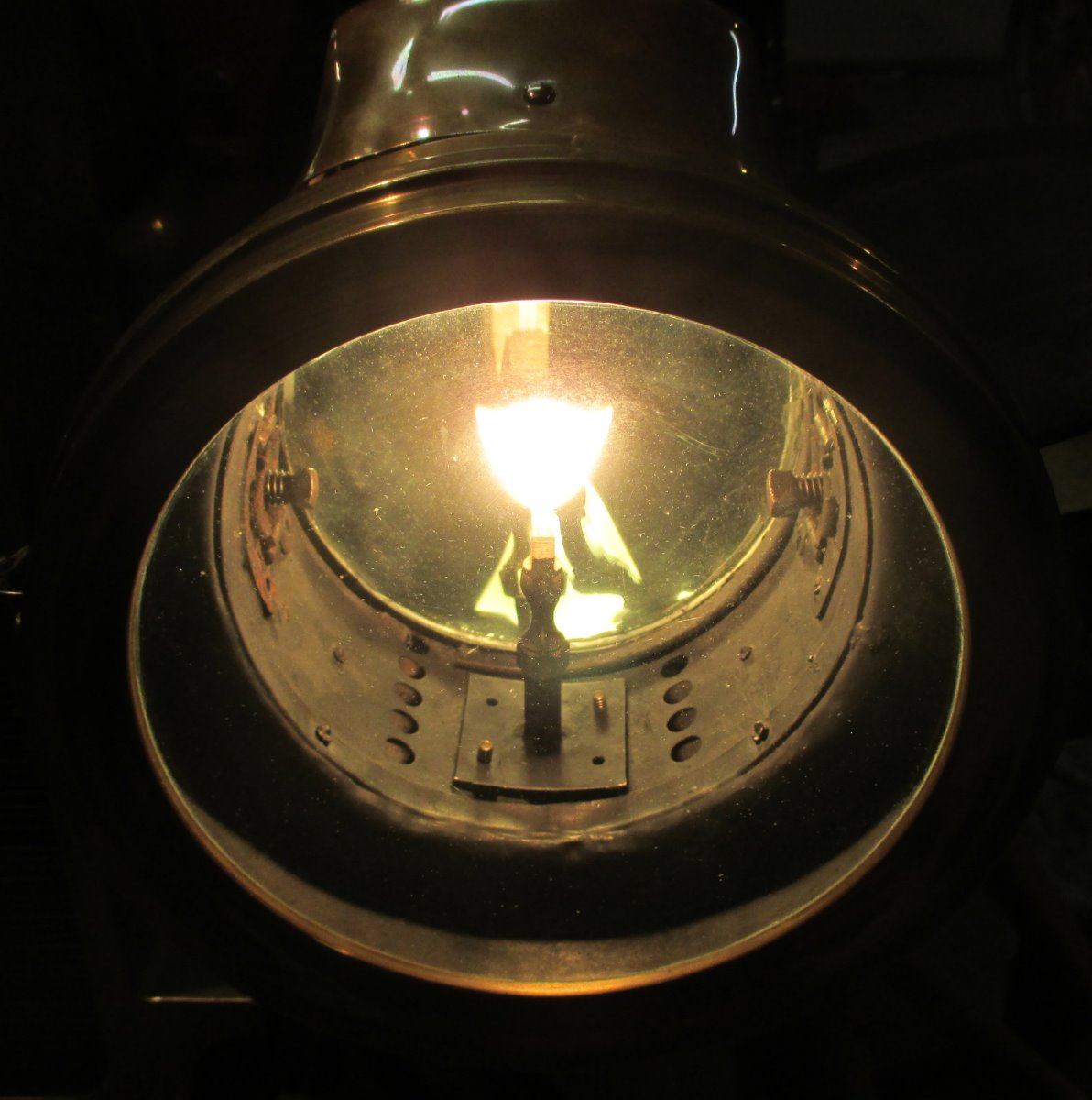

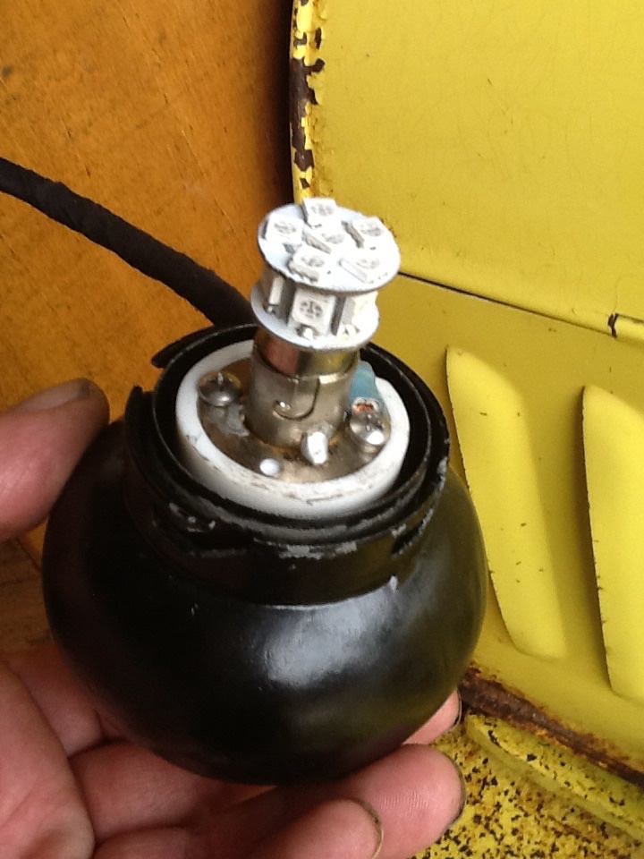

Here is an option, showing an incandescent bulb, but you could certainly use an LED bulb...

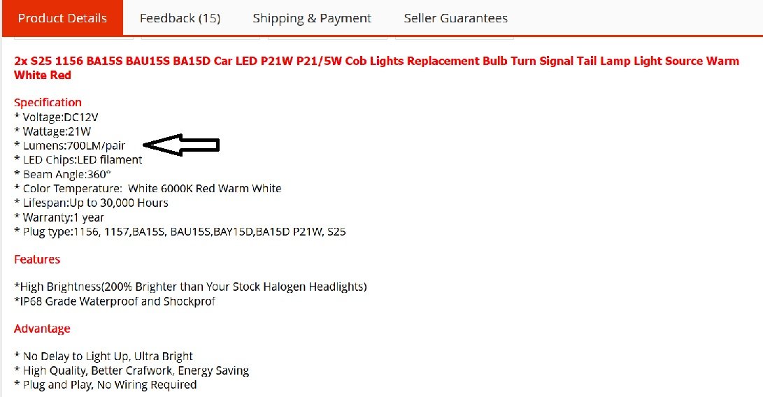

Here is another option I found:
https://www.aliexpress.com/item/MAXGTRS ... a9b2ac9484
It is available in warm white that has 650 lumens, or about 51 CP.
I'm thinking these might work to use in place of my old 1196 incandescent bulbs (37 watts 50 cp) which together draw 6+ amps!

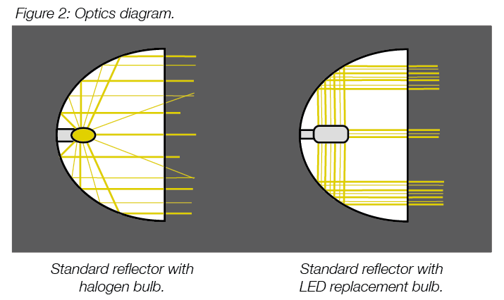

Excuse the Tech Bit... Some LED replacement bulbs may have their filament in front of the focal point of the reflector and while they may have more LED chips in them they may project a blurred beam. The MAXGTRS bulbs look to be the same shape as the standard size bulb so I would expect them to perform very well. The attached image is a simple example of how the bulb geometry might get reflected refl
Standard vs Long Neck LED Bulb

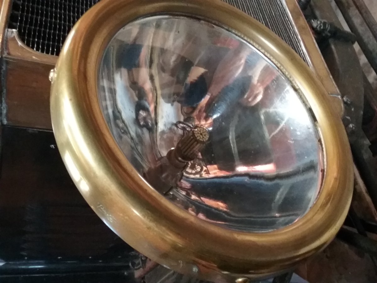

Following up with Gonenorth's question, has anyone installed LED bulbs in a gas headlamp? It would be nice to have a proven alternative to the 55W halogens that are available from our regular suppliers.

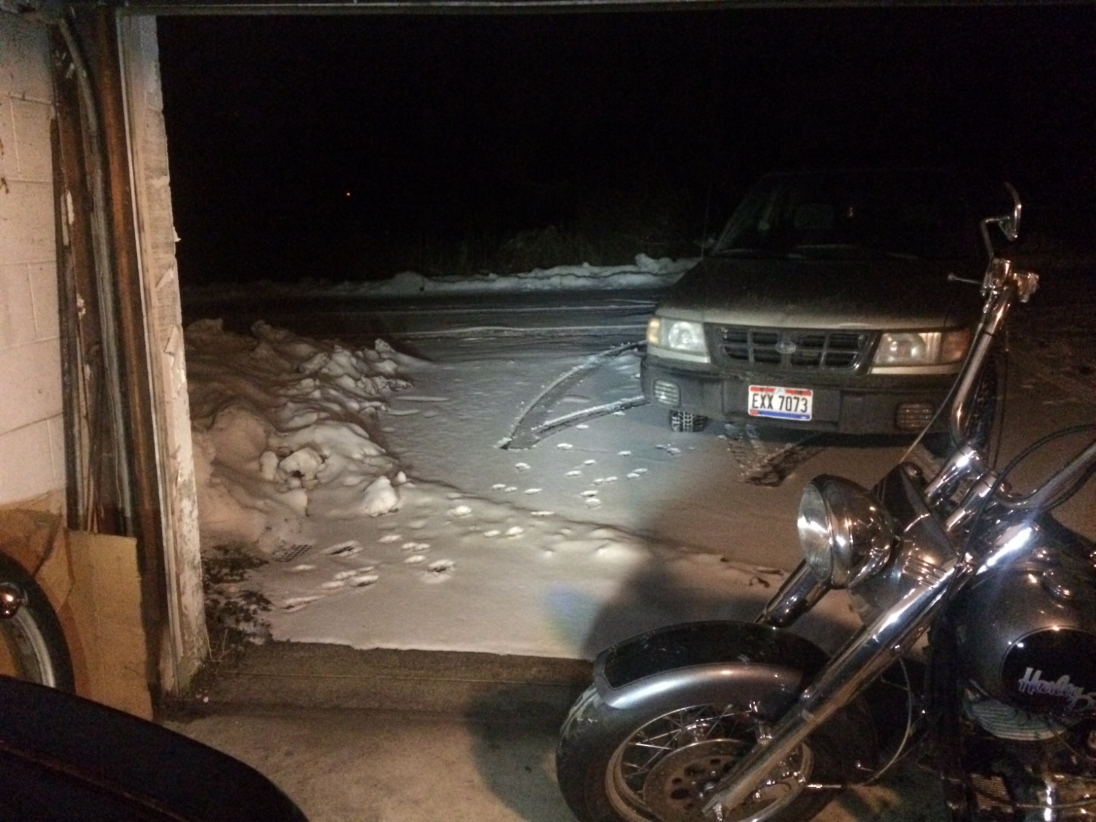

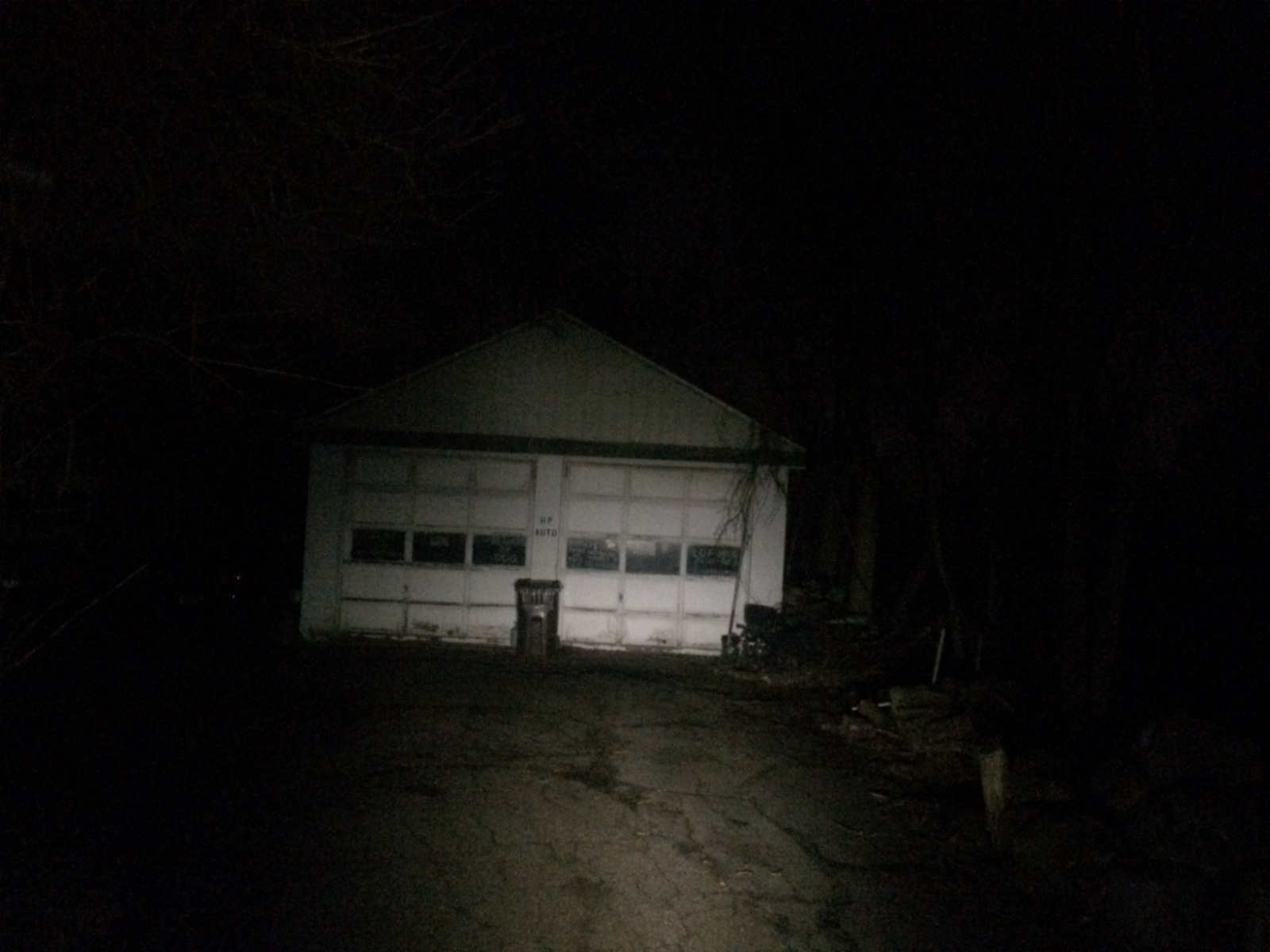

Here's a couple shots of my new bulbs last night...
It was a little cold for the road with the top down after dark !!
High and low from about 40'

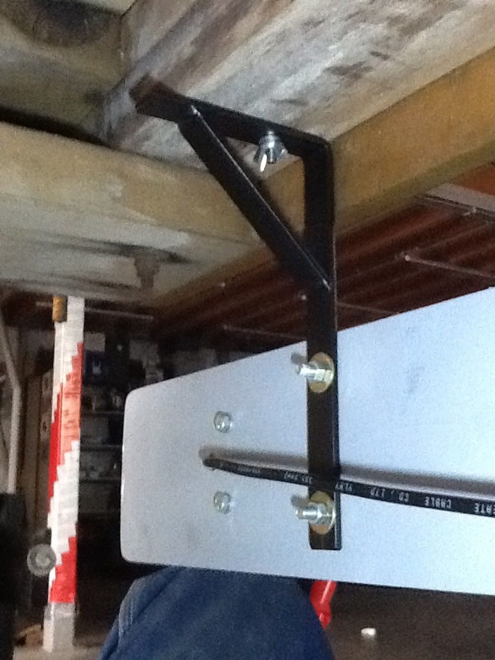

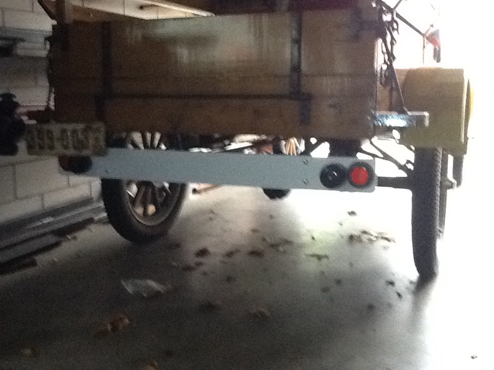

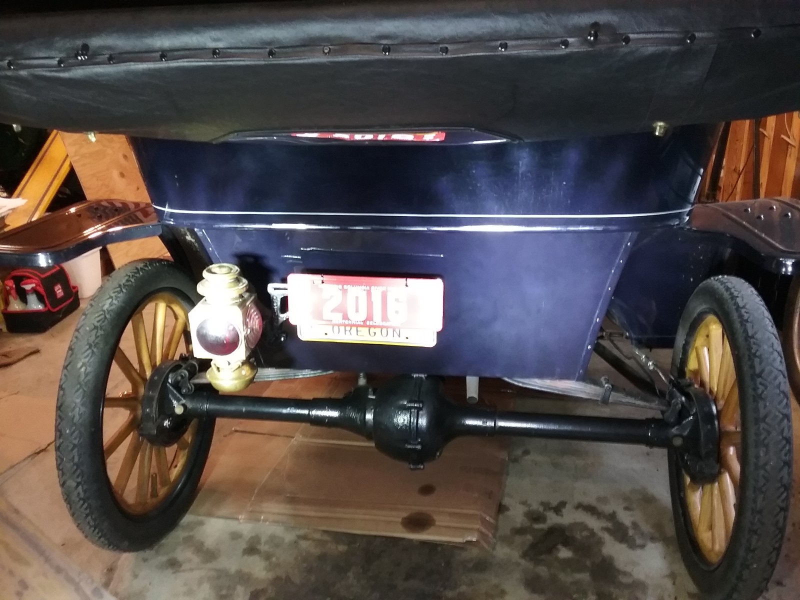

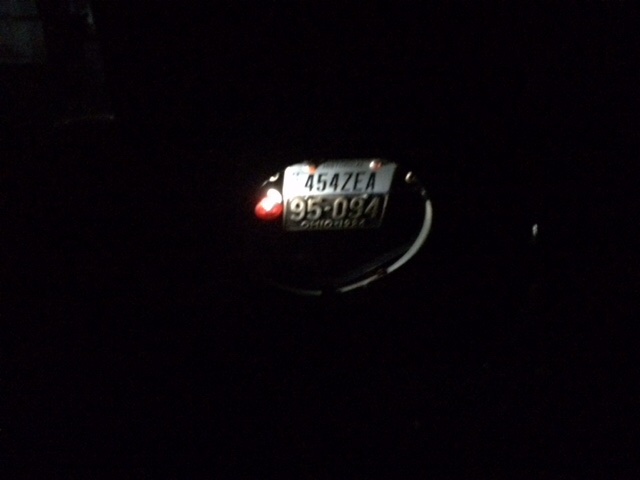

For safety reasons i wanted turn signals, no one understands hand signals anymore so took the loose burners out of the side lights, made a block of nylon with the same height and mounted a bulbholder on it, the wires go out the way the adjuster for the pit goes out. can be converted back to parafin burner in two seconds flat.
For the rear i made a board that is mounted with two wing nuts under the floor of the bed and plugs into a hidden trailer connector socket, it also can be taken off in no time at all.
Both help 'the communication' with other road users and can be taken off if original looks are important and safety is not an issue.

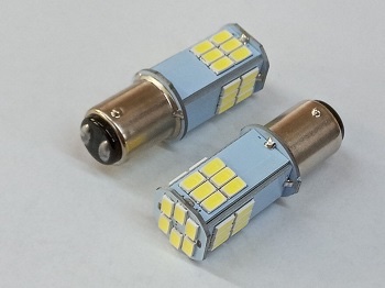

My bulbs arrived for my 1915
Previously I used 1196, a double contact bulb. The single contact is 1195, a 50 cp 37 watt bulb that draws about 3 amps each.
LED incandescent.jpg (8.79 KiB) Viewed 25791 times
https://www.replacementlightbulbs.com/lamp1195.html
These bulbs flood the road with light! But for a car with no charging circuit, and an 18 ah battery, that is only 3 hours of driving with headlights on. I switched out the sockets to use the single contact bulbs.
In my 1919 I have these:
LED bulb Superbright LEDS 1156-WW3W-G.jpg (14.43 KiB) Viewed 25791 times
https://www.superbrightleds.com/moreinf ... -car/1686/
Let's call these LED #1 Warm white, rated at 290 lumens.
I put in these. We'll call then LED #2:
and was pretty disappointed. Warm white, rated at 650 lumens but they are not as bright as LED #1 rated at 290 lumens (hmmm?)
Then I put in LED #3:
https://www.aliexpress.com/item/2x-S25- ... 24914408-5
These are about as bright as LED #1. Warm white. Rather disappointing as they claim 1400 lumens.
Overall I am rather disappointed. I wonder if the regular white would put out more light as opposed to the warm white? The specifications still list it as 1400 lumens whether white or warm white.

Looking further down for the "Specifications" for the link on Bulb #2 - there is some confusion on the math. Below where they say 1400 lumens they have a second spec for 2X.......(see attached) in which they say the output is 700lumens/pair so is that 700/2 = 350 ? Perhaps their Abacus was missing a bead.
Posts: 6577
Re: LED Bulbs.
Post by TRDxB2 » Thu Mar 14, 2019 1:14 pm
Correction to the above reference - I meant the link for Bulb #3

These are the ones I have, reposted since it was so long ago.
https://www.ledlight.com/a-13007-d-a-13 ... round.aspx
Description:
"Headlight bulb 6 Volt Positive Ground or 6 Volt Negative Ground. 6V AC or DC. Up to 700 Lumen. The candle power is up to 50 CP. Dual filament design. Designed for reflector headlights since most of the leds are side firing directly into the reflector. The bulb has some forward firing leds to make it brighter. This LED bulb is designed for early vintage Ford Model T and Ford Model A. Long life up to 30,000 hours. Plug and play remove the old incandescent bulb and replace with LED bulb. The LED uses less power than a incandescent bulb so it is easier on the wiring of the older vehicles. The bulb comes in White 6000K and Warm white 3000K. The Warm White simulates the original color of a incandescent light bulb. How ever the Warm White is about 5% less output than the 6000K bulb. CE and Rohs certified. The original light bulb was 21 CP/21 CP, then you could upgrade to 21 CP / 32 CP and then finally 32 CP / 32 CP or 32 CP / 50 CP. These original bulbs decline in Lumen output compared to a slow Lumen decline with LEDs. This LED bulb is 55 CP brighter than all original headlight bulbs. Since these bulbs are non polarity sensitive they work in both positive chassis and negative chassis. The maximum overall length is 1.944 inches. The maximum diameter is .760 inches. This led bulb is 6 volt and 360 degree illumination. Compatible with: Model A Head Light Bulbs A-13007-C 1919-1931 A-13007-D 1919-1931 1946 Air coup 1919-1931 Ford 1926, 1927 Ford Model T 1928, 1929, 1930, 1931, 1932 Model A A-13007-C Snyders A-13007-D Snyders 6572BX Langs"
The phone lines were closed last night, but here's the number. Zack has been very helpful for me. 1 877 283-5060
And yes they do flicker at idle, apparently as the points open and close in my distributor. I imagine a timer would be similar. You don't see it unless you're looking at them, I don't notice at all driving and the flickering is almost nill once the cutout closes.
This is also not a bad thing, people notice you more. There's a kit available for MCs to make the light flicker as a safety feature...
I will have to adjust my generator to about a 2-3 amp charge. I am at 7-8 amps now, with the lights on. Before was about 2-3 amps discharge with the lights on.

Post by Ruxstel24 » Wed Mar 27, 2019 8:50 pm
Finally got out on the road after dark, very pleased :D
One car came towards me and didn't seem like any problem.
I was alone trying to drive and snap pics, sorry bout the shakey shots :roll:
The oncoming car in the picture is maybe 1/2 mile away...
This is back up my road with no lines.

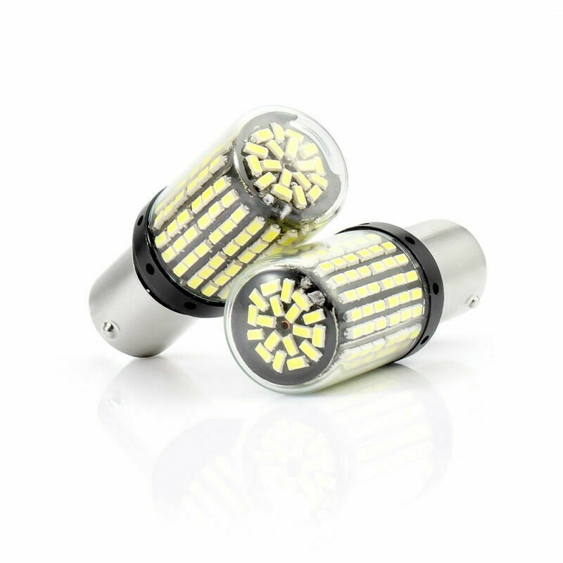

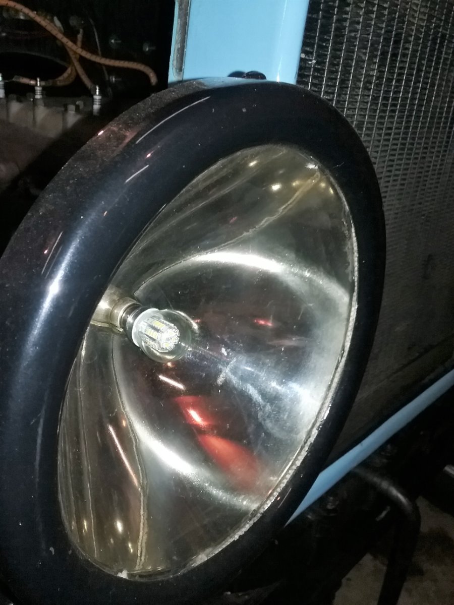

These are my latest bulbs:
Take a look at the right side with old bulbs:
And here it is with the new bulb in place:
The new is a much whiter and brighter light. I look forward to trying them at night.

Post by KWTownsend » Mon Apr 08, 2019 10:30 pm
They are these:
And I got them here:
https://www.ebay.com/itm/254165334252
Ruxstel24
Posts: 2406
Last Name: Hanlon
Location: NE Ohio
Re: LED Bulbs.
Post by Ruxstel24 » Mon Apr 08, 2019 11:09 pm
They are these:
Those look bright !!
I see they are single pole, are you running 6V or mag ?
Posts: 1520
First Name: Keith
Last Name: Townsend
Location: Gresham, Orygun
Re: LED Bulbs.
Post by KWTownsend » Tue Apr 09, 2019 12:27 am
I'm running them off a 12v motorcycle battery that is tucked under the seat.

Wife went with me tonight and we got better pics. :)

A word to those replacing turn and brake lights with LEDs...
Assuming a red filter is on your brake light, you will want to replace the incandescent bulb with a red LED, not a white LED.
All of the red light emitted from a red LED will pass through.
Only the red part of the white light spectrum will pass through from a white LED. The rest is absorbed as heat.
So, a red LED will be brighter with a red filter.
Use an orange/amber LED with orange/amber filters.
Vern (Vieux Carre)
Ruxstel24
Posts: 2406
Last Name: Hanlon
Location: NE Ohio
Re: LED Bulbs.
Post by Ruxstel24 » Wed Apr 17, 2019 11:25 pm
Vernon, I put a lower CP white bulb in the tail, it's a little brighter through the red lens, but it really lights up the white hysterical plate. I want to be seen, so good.
I left the original bulb in the brake, it just seems brighter in the daylight.

Post by KWTownsend » Sat May 04, 2019 12:00 pm
I put my new LED bulbs in last night and went for a drive.
I like 'em.
They are not a warm white. They are white light, but for night driving I would rather have the light than the ambiance!
Keith
Keep crankin'
Eric
Still wondering. Has anyone installed led bulbs in an acetylene head lamp?
