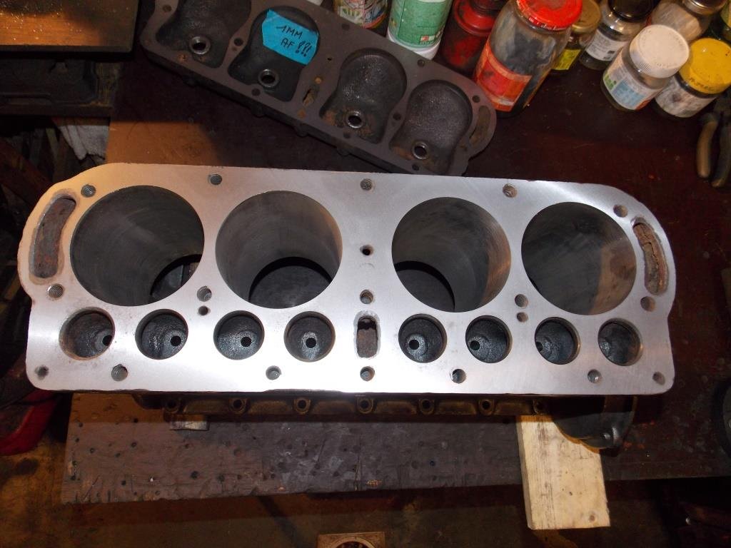

I just finished a 1912 engine.
Here is what I did with the block and the head.
Took off: - 0.1mm on the bottom.
- 0.4mm on the top
- 1.0mm on the head
Redone the valve seats for the new valves and adjustable tappets.
At the same time I looked after three bolt holes with stripped tread and installed V-coils.
Andre
Belgium
- 0.4mm on the top
- 1.0mm on the head
Andre
Belgium

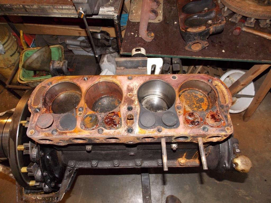

Steve,
I looked your other tread about that engine.
On the photo you posted, there is a change in color at the rear section of the engine.
Your problem is there.
If it should be mine, I should take the engine out, disassembled it, grind all the surfaces flat and do a valve job.
After grinding watch and look for cracks, sometimes they are the reason for the start of your problem.
Just what I should do.
Andre
Belgium
It's a model T, it will keep you busy.
Andre
Belgium
