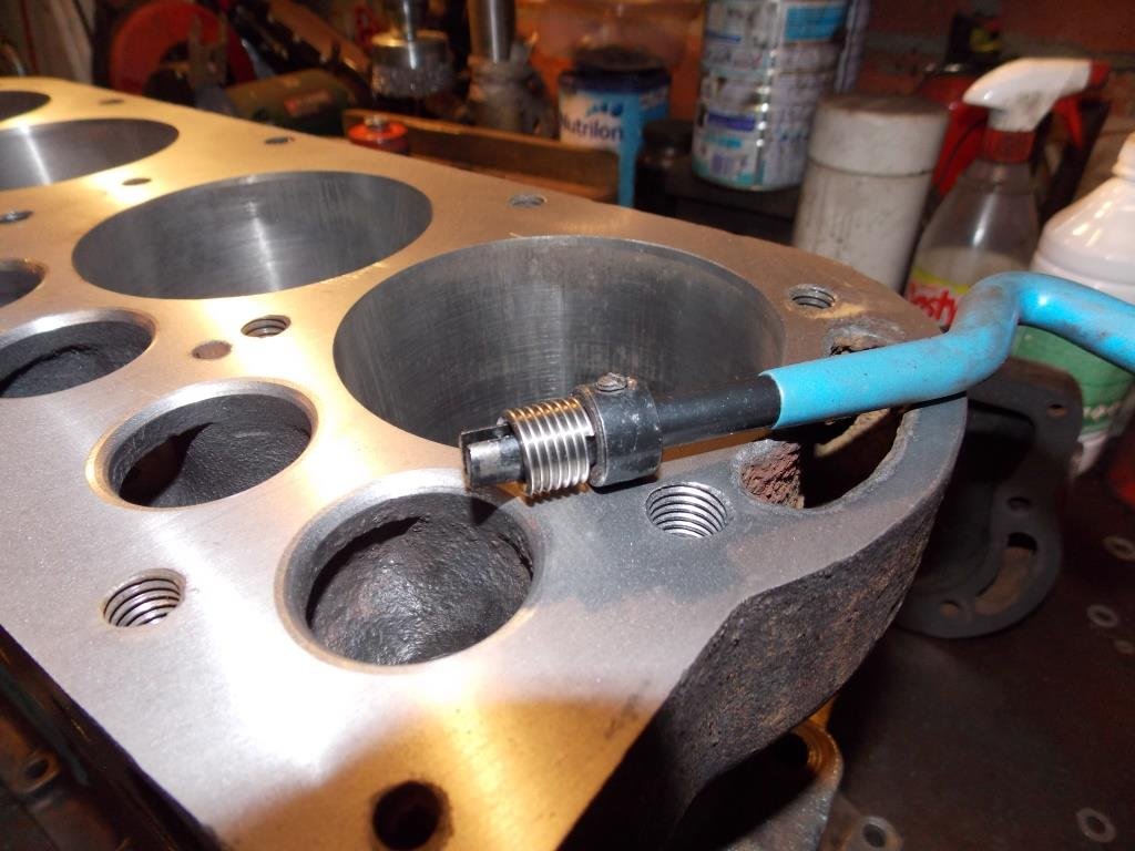

I just finished a 1912 engine.
Here is what I did with the block and the head.
Took off: - 0.1mm on the bottom.
- 0.4mm on the top
- 1.0mm on the head
Redone the valve seats for the new valves and adjustable tappets.
At the same time I looked after three bolt holes with stripped tread and installed V-coils.
Andre
