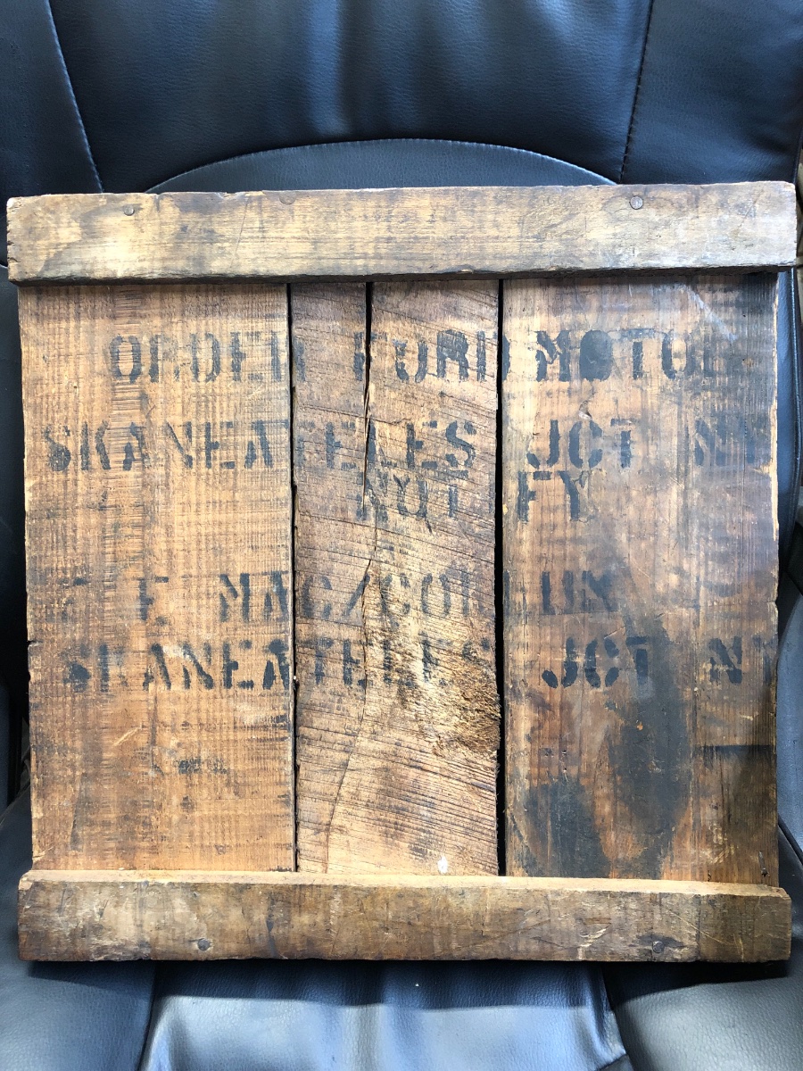

I’ve got an original with a shipping address on it if you want a pic of that.

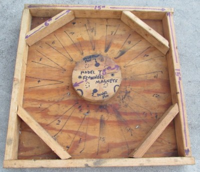

Here is the simple box I made for holding a set of flywheel magnets.
Use some scrap 1/2" plywood as the base. The sides are 3/4" x 1 1/2" pine trim pieces.
Dimensions are noted on the box, 15" x 15" square inside. The angle corners are approx. 6" long. Fastened with dry wall screws of course!
Got fancy and cut out a round piece from a 6" wide pine, and made it approx. 5" in diameter.
The magnet set will nestle in this box, with a lid could be shipped.
The center round I marked to indicate the location of the flywheel dowels, as just wanted to take off and replace these magnets in the same relation of each other they had been fitted so many decades ago

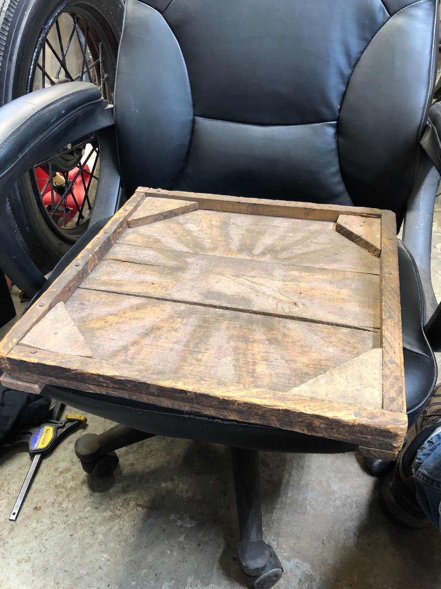

Thank you Ken, that is exactly what I am looking for. It looks like a "shadow" line from a square piece in the center to hold the magnets in place. It looks as though the 2 slats on the bottom are the same thickness as the boards with the address on them? Any dimensions that you may be able to offer would be greatly appreciated. Thank you for your time and help.

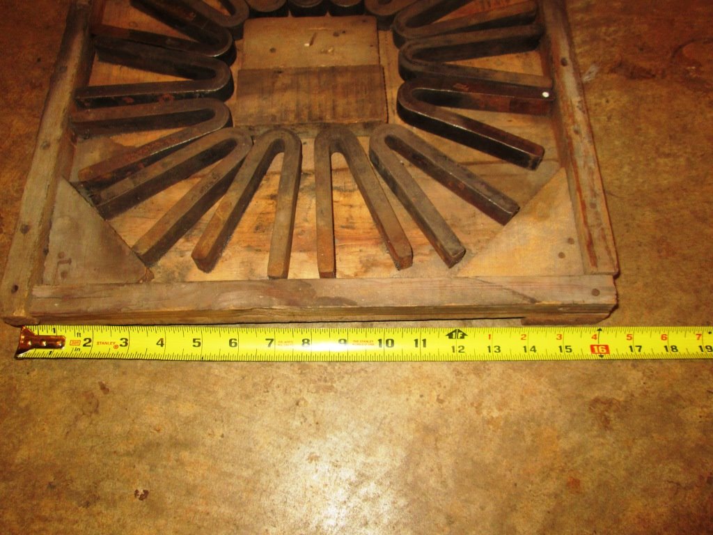

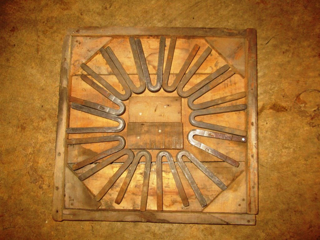

James still has that box up in the attic.
There is a possibility that I can photograph the other side.
A friend told me he had several of them.
I will visit him on Monday and I may be able to get some better photos.
