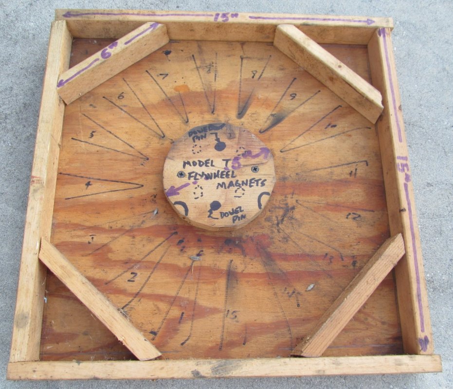

Here is the simple box I made for holding a set of flywheel magnets.
Use some scrap 1/2" plywood as the base. The sides are 3/4" x 1 1/2" pine trim pieces.
Dimensions are noted on the box, 15" x 15" square inside. The angle corners are approx. 6" long. Fastened with dry wall screws of course!
Got fancy and cut out a round piece from a 6" wide pine, and made it approx. 5" in diameter.
The magnet set will nestle in this box, with a lid could be shipped.
The center round I marked to indicate the location of the flywheel dowels, as just wanted to take off and replace these magnets in the same relation of each other they had been fitted so many decades ago :lol:
