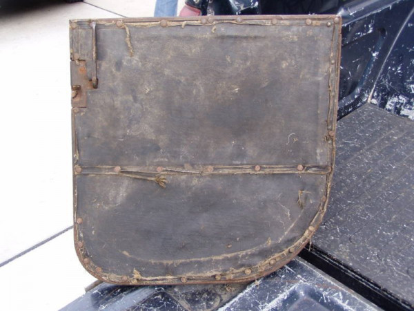

Here it is around a 1915 door. Curtain trim. Yes. Not reproduced.
I created one out of aluminum trim for my 1919 until I found the real deal.

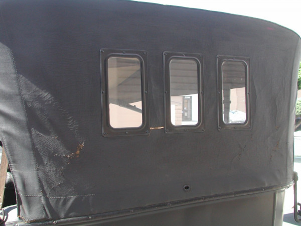

I have seen, and driven that car. Two things I failed to observe. First, it has Hastings rear windows in it. Certainly the original owner didn't install them! Another observation, I'd sure like to know the diameter of the upholstery nail on the binding for the rear bow. I think it should be 9/16". Can anyone clarify that?

The Hastings window frames were added within the past 40 years. I surmise that the rear windows were damaged or torn sometime during that period so the fix was to add those accessory frames.
Someone also added modern muffler wrap with stainless steel bands and an oil can holder to the steering column.
The car also has reproduction front top straps.
The correct, oversize upholstery nails for the top are not readily available. Eight are required on a touring. The work-around is to use black snap buttons (snap fastener). You screw the male portion of the snap into the top material and bow and then snap the female portion over it.

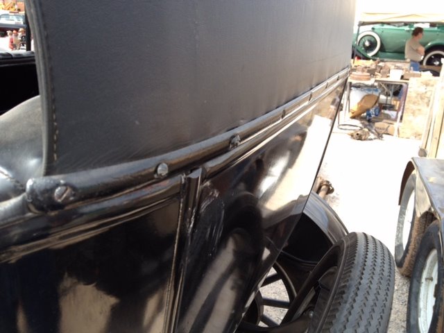

Your photos and comments have been very helpful. If I can't find an original steel strip I may try a strip of half oval SS marine rub strip.

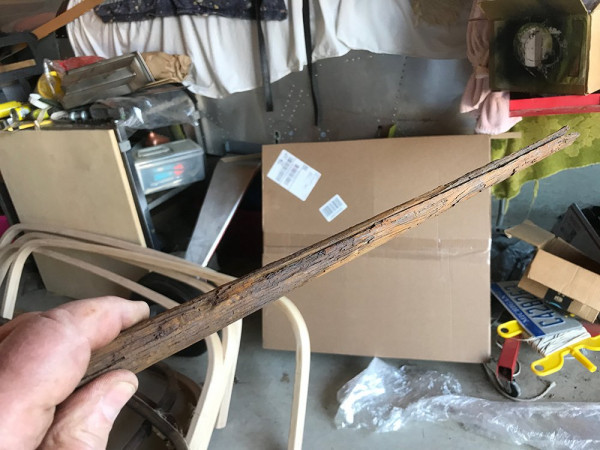

1.) Looking inside the oval top sockets I see they have wood in them. I was able to remove the wood from the longest sockets but one was pretty rotten. (Photo 1) How important is it to have wood inserts in the sockets? Anybody use something else? What about protecting the inside of the sockets from corrosion?
2.) In photo 2 you'll see some holes in the top of the sockets. Would these have been used to put in tacks or something to attach the top?

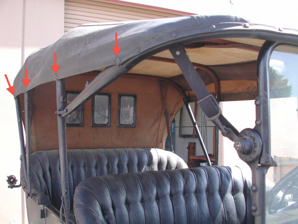

Originally the wood was put in there to add strength and support to the section of top sockets' tubing between the castings at the bottom and the end of the wood bows at the top end. The wood usually rotted, and the wet wood swelled, causing rust and opening the folded seams of the steel tubing. I know that John Boorinakis replaces the wood with pourable epoxy in his new sockets. This will not only prevent rust but provides a decent anchorage for the little machine screw that holds the key straps' upper end.

From the factory, there a single nail hole on the outboard side of each socket. These are from the large head, upholstery nails that were used to fasten the top material to the socket. As previously posted, eight large head upholstery nails were used on a touring - one upholstery nail per socket.
See photo below with arrows pointing out the upholstery nail on each socket.
Your top sockets have holes that were added by someone at a later date.
Also, I recently posted 1917 roadster top sockets in another thread. Click on the link below. You can see the single nail hole on the outboard side of each socket from the upholstery nail. I also show the single nail in each socket that used to keep the wood bow in place (that was the original reason for posting the photos).
viewtopic.php?f=2&t=11380

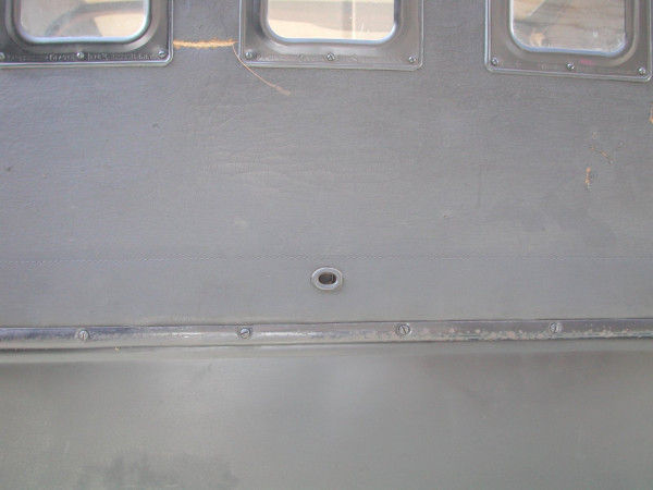

The metal piece along the back is not round, I don't think you can make it from a piece of conduit. It is basically an "L" shape, but the tall (vertical) part is curved slightly, not much though.

Here's a photo of the 1917 Rip Van Winkle touring showing what David Dewey described. Click on the photo to enlarge.
Note that the car was wearing its side curtains when this photo was taken.
As he said, it is L or J shaped on the bottom.
My father and I also have the original trim piece on our 17's.
The trim was used from the 1915 model year until, I believe, 1922. Hidem welt was used with the one man tops (1923 and forward).

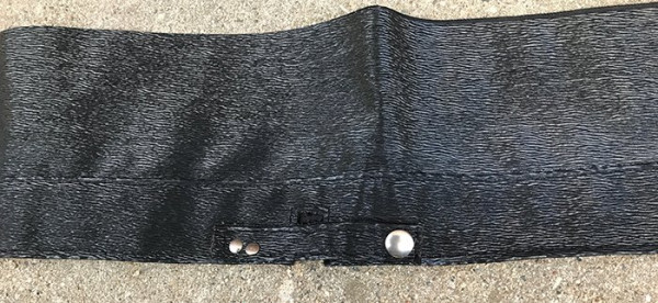

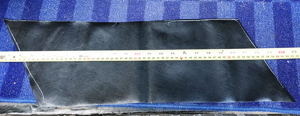

Tom solved one problem - now to another. The top kit I found boxed up in my car had some items I haven't been able to figure out. In the box were eight pieces of vinyl (see photo) that measure about 24 inches on the diagonal. The instructions that came with the kit (such as they were) make no mention of them and I can't see where anything similar is used in other kits. My only guess is because there are eight, maybe they're meant to wrap the corners of the bows or something.
If anybody has seen these or has an idea of their function I'd love to hear it
Erik Johnson
- Posts: 1143
- First Name: Erik
- Last Name: Johnson
- Location: Minneapolis, MN
Re: 1917 Top question
I thought I had answered that in private message.
As posted before, the first bow is covered with a single piece of leatherette. The leatherette is cut on the bias (cut diagonally to the weave) so it doesn't pucker at the corners.
Because you have eight pieces that are cut on the bias , I can only surmise that their purpose is to wrap the two corners of each of the four bows. HOWEVER, that is not correct because the cars did not come from the factory that way.
Contact Mike at Classtique to obtain leatherette for the first bow and cotton drill for the second, third and fourth bow.

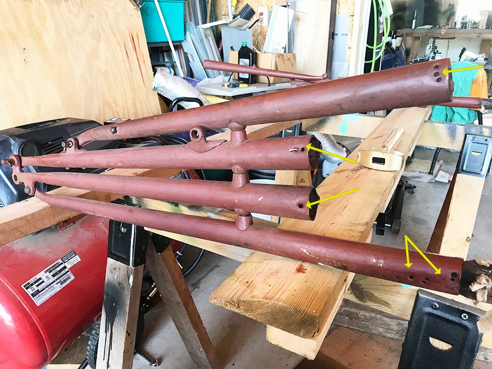

Tim
Now the question comes up, did you also receive the bow drill for the 3 rear bows and the leatherette for the front bow?
If so, then we still have no clear answer as to why these pieces are in your kit.

Dave,
Yes - I did receive the drill for the three rear bows and the leatherette for the front. The front is one long piece and another piece that has a snap and strap over a hole I think is designed to accommodate a windshield wiper when one is installed. I'll try to remember to takes some pics tomorrow.

Topic author - Posts: 2329
- Last Name: Juhl
- Location: Thumb of Michigan

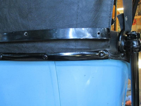

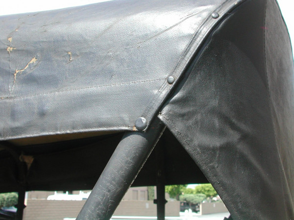

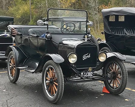

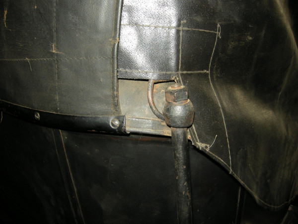

Erik - My kit pieces have "1917 Touring" scrawled on them in fabric chalk and that's what the box said. As to the car, I'm told the windshield frame is typical of a early 1917 model year (was built 9/23/16) photo 1. It has a small hole in the top tube in front of the driver which I assumed was for a manual wiper. Photo 2 is a lousy picture taken in the rain during last year's Covered Bridge Tour but you can just see the little hole in the picture. Photo 3 shows the leatherette strip with the notch and snap. It measures a little under five feet long. I don't have access to some of the references guys often refer to so I ask questions and make educated guesses... I appreciate it when fellows chime in with more info.
Photo 1 Photo 2 - a top might have helped a little
Photo 3
Erik Johnson
- Posts: 1143
- First Name: Erik
That hole in your windshield frame is not factory so it could have been drilled any time in the last 113 years.
Also, the rain flap you show appears to be what is known as cobra grain. Cobra grain was not used on Model T roadster or touring tops from the factory although through the years vendors did offer cobra grain top kits for restorers. Don't know if any of the vendors currently offer cobra grain kits but you could probably get one special order from Classtique.
Turf grain from Haartz Corporation which is available through Classtique is considered a close match to factory. Colonial grain, available from Classtique as well as vendors such as Lang's, was considered a good match until Turf became available.
- Last Name: Juhl
Erik,
The grain on the flap is the same as is on the top material that I have. I don't know who made the kit but I plan to install it. It represents almost $500 I won't have to spend. It's not new but appears to be in great condition.
