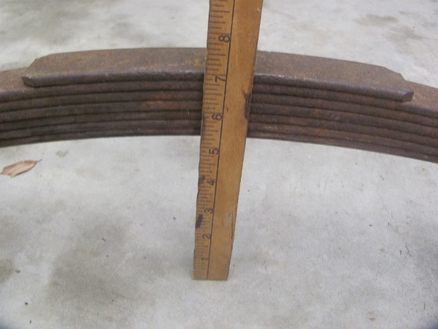

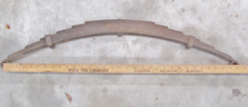

All '09-'25 front 7 leaf assembled spring stacks, main leaf eye to eye are the same. 31 1/2" between the eyes.
What can make the sag is the stack, where the others are fatigued.
Should be about 7' high, un -sprung, with spring assembly resting on the eyes on a flat surface.

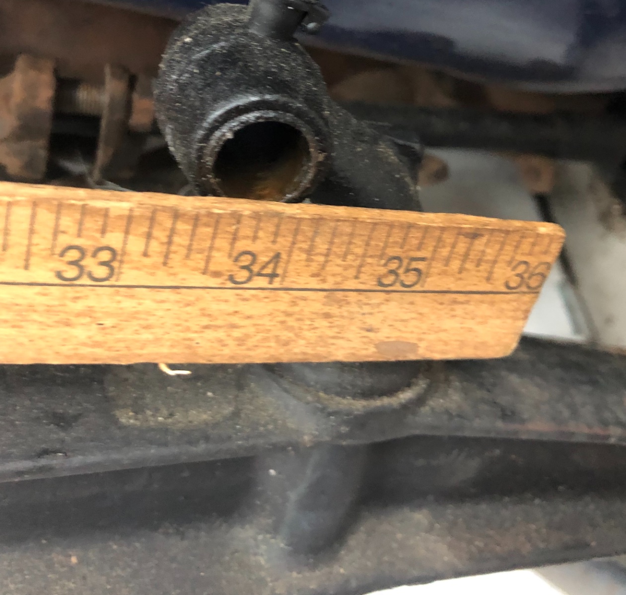

JIM, THIS IS IN THE CAR--33 INCH BETWEEN EYE TO EYE, FROM THE CROSS MEMBER TO AXEL IS 4 INCH, GREG.

Correct Richard, when front spring is loaded with car weight:
This is a rather old spring on the '23 cutoff, sags some. A well worn one can let the knuckle ride on the axle
