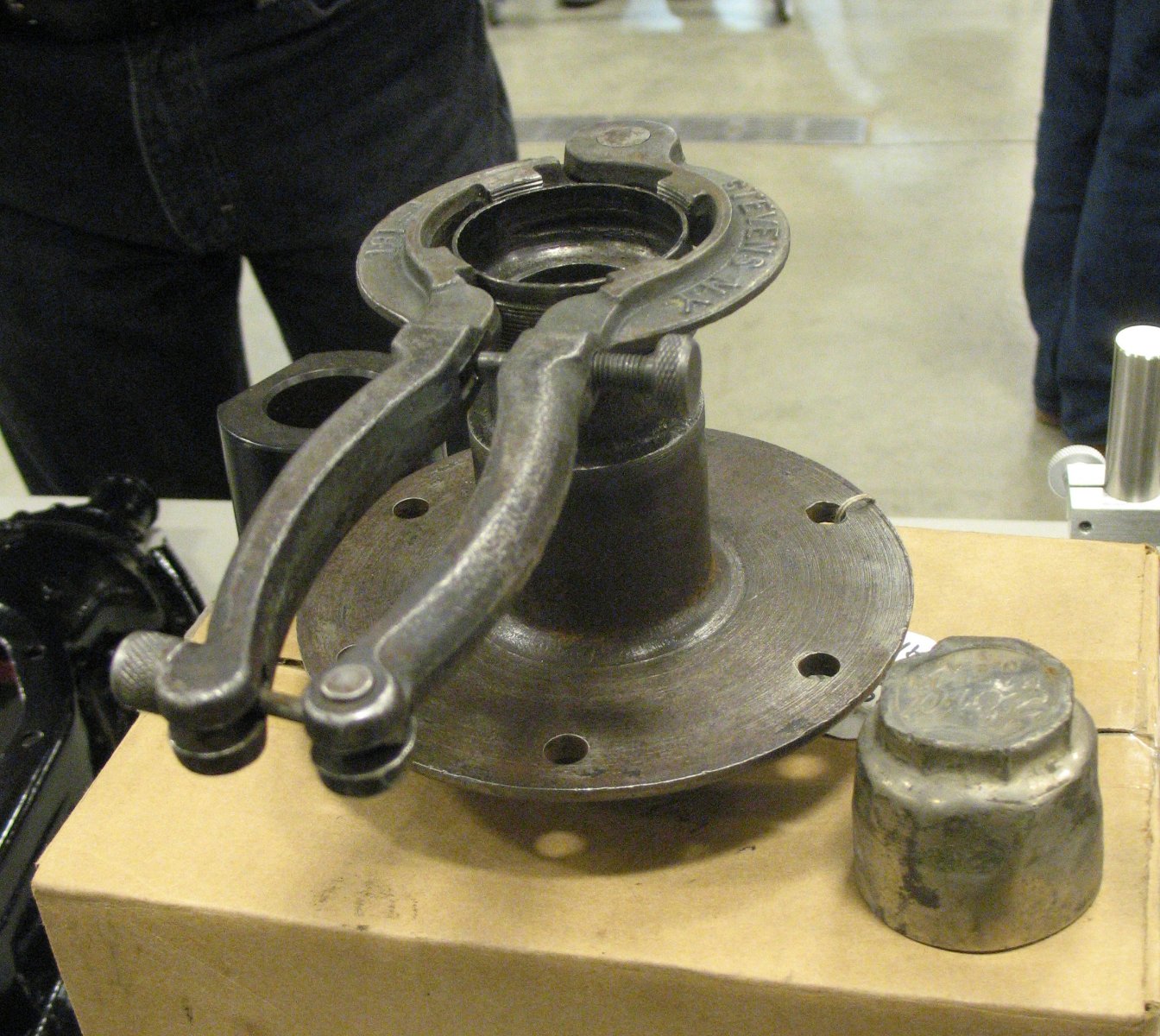

- Posts: 7293
Re: Hub Cap threads
This may be the occasion where the special Stevens tool for chasing the hubcap threads would come in handy. This tool can be started on the threads to clean them up. It does not rely on having good threads of the correct size to start onto the hub. The tools are scarce, but if one can be borrowed, with its owner/operator if needs be, it may be the easiest way around the problem.
- Posts: 7411
Re: Hub Cap threads
The Stevens 181 thread tool is rare and expensive, but it can be copied. Awhile back Andre in Belgium posted photos of his very nice home made version. I intend to make one someday when I get a round tuit.

- Posts: 7411
Re: Hub Cap threads
I misremembered. It was Toon who made the tool, not Andre. Photo is here, and pictues of the Stevens 181.
https://www.mtfca.com/phpBB3/viewtopic.php?f=2&t=4649
Here's another picture of the 181:
