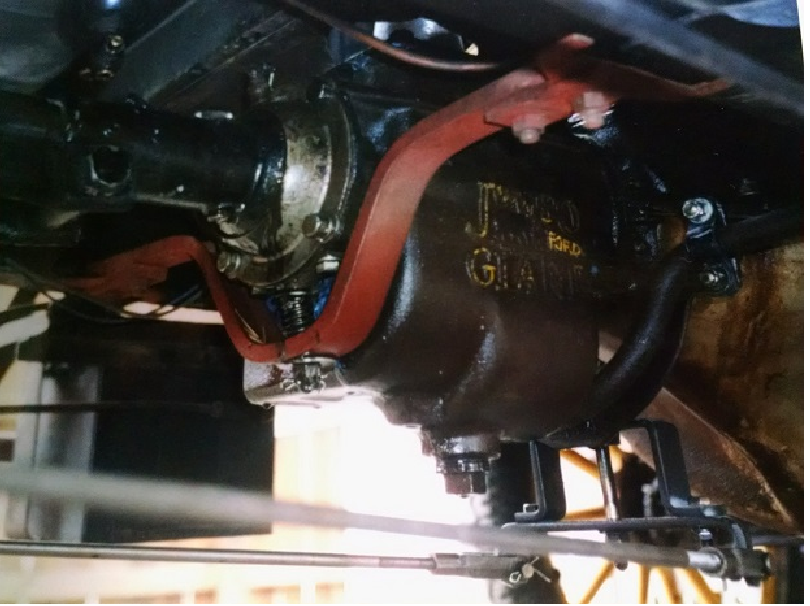

Found a discussion with picture of a mount http://www.mtfca.com/discus/messages/70 ... 1507814284
Here are a couple of links with pictures and more info that may help
http://www.mtfca.com/discus/messages/50 ... 1420996116
http://www.mtfca.com/discus/messages/41 ... 1409244609

That picture looked familiar, that is the Jumbo Giant in my 24 TT. Sold that 12 plus years ago.

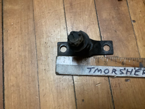

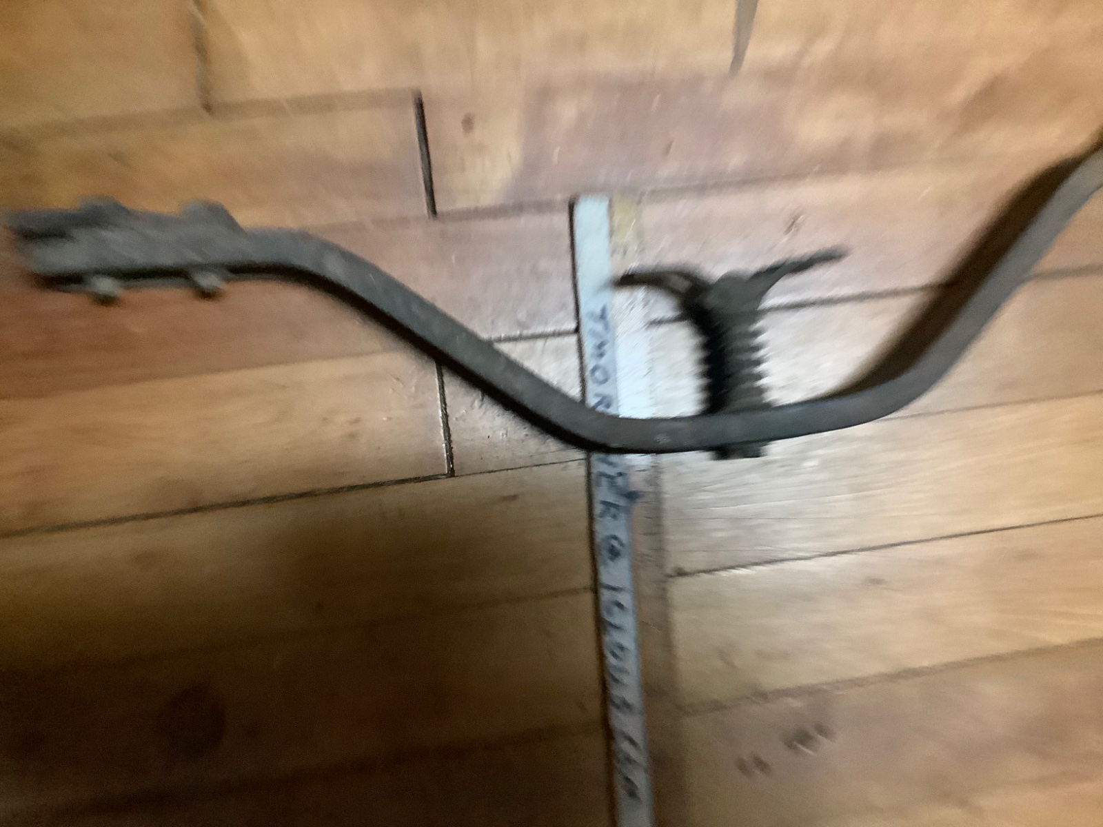

Bill, I have a loose one here. Unless I’m confused, it came with the nice transmission I sent to you. I have procrastinated sending pics and dimensions to another friend, but will do so tomorrow and post here. It’s pretty simple but might as well do it right, if you are doing it. T
Dropacent
Posts: 3384
Last Name: Morsher
Location: Norwalk Ohio
Re: Jumbo Giant frame mount
Post by Dropacent » Wed May 20, 2020 4:46 pm

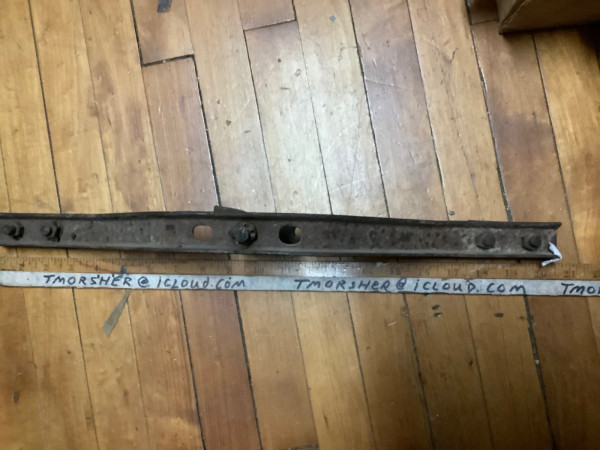

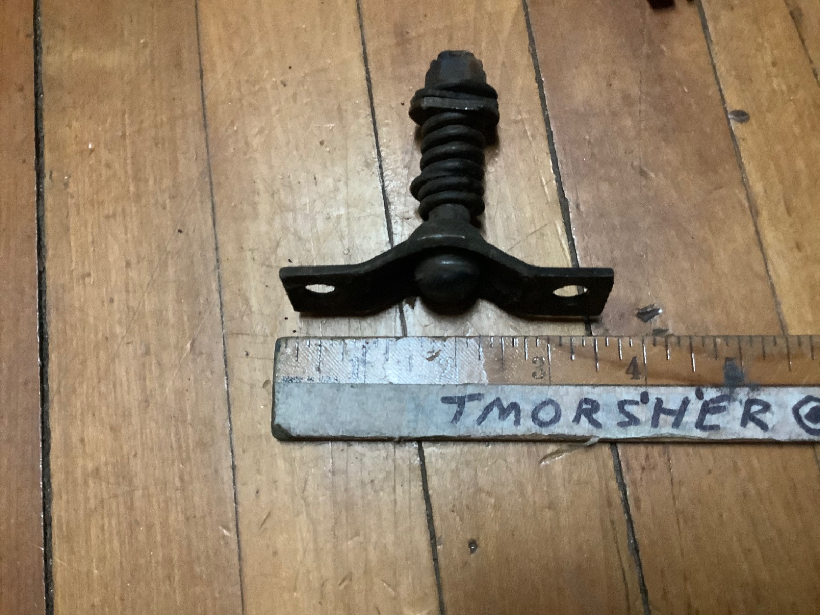

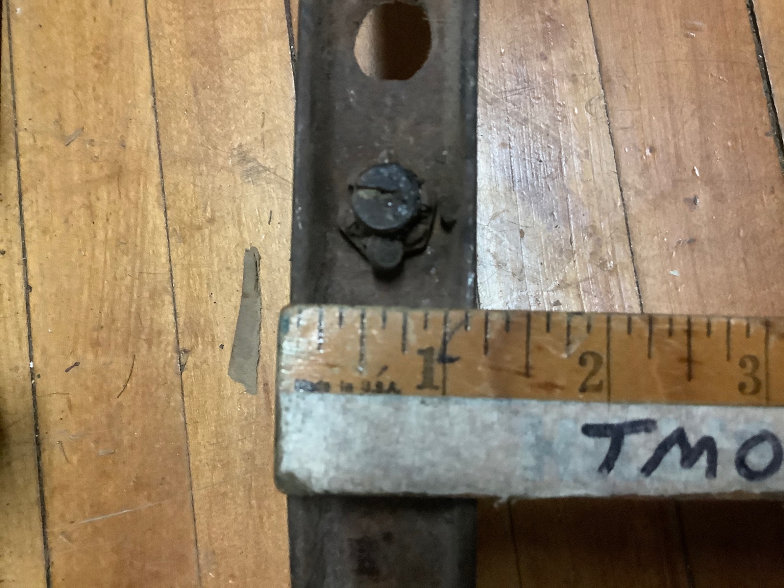

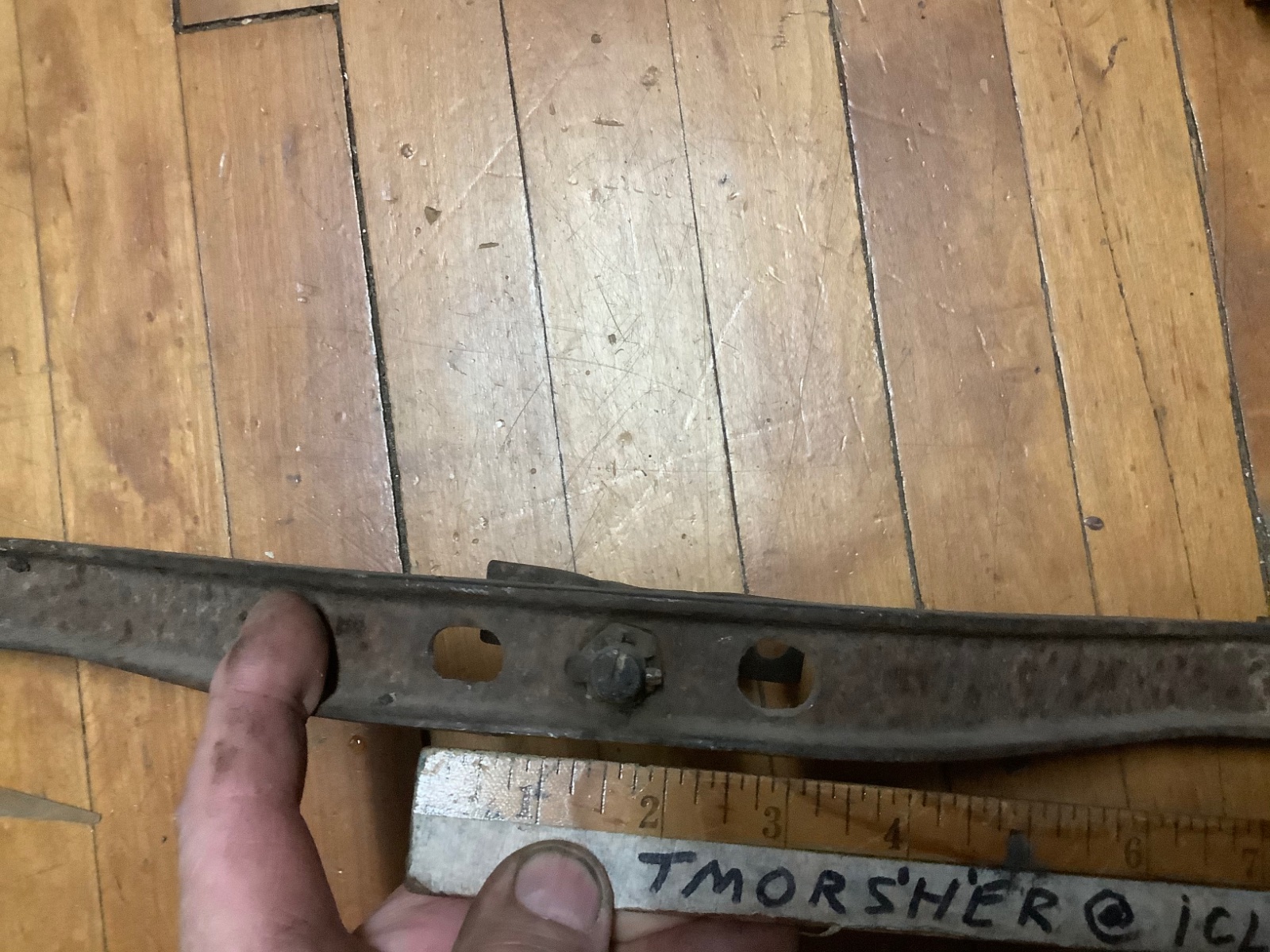

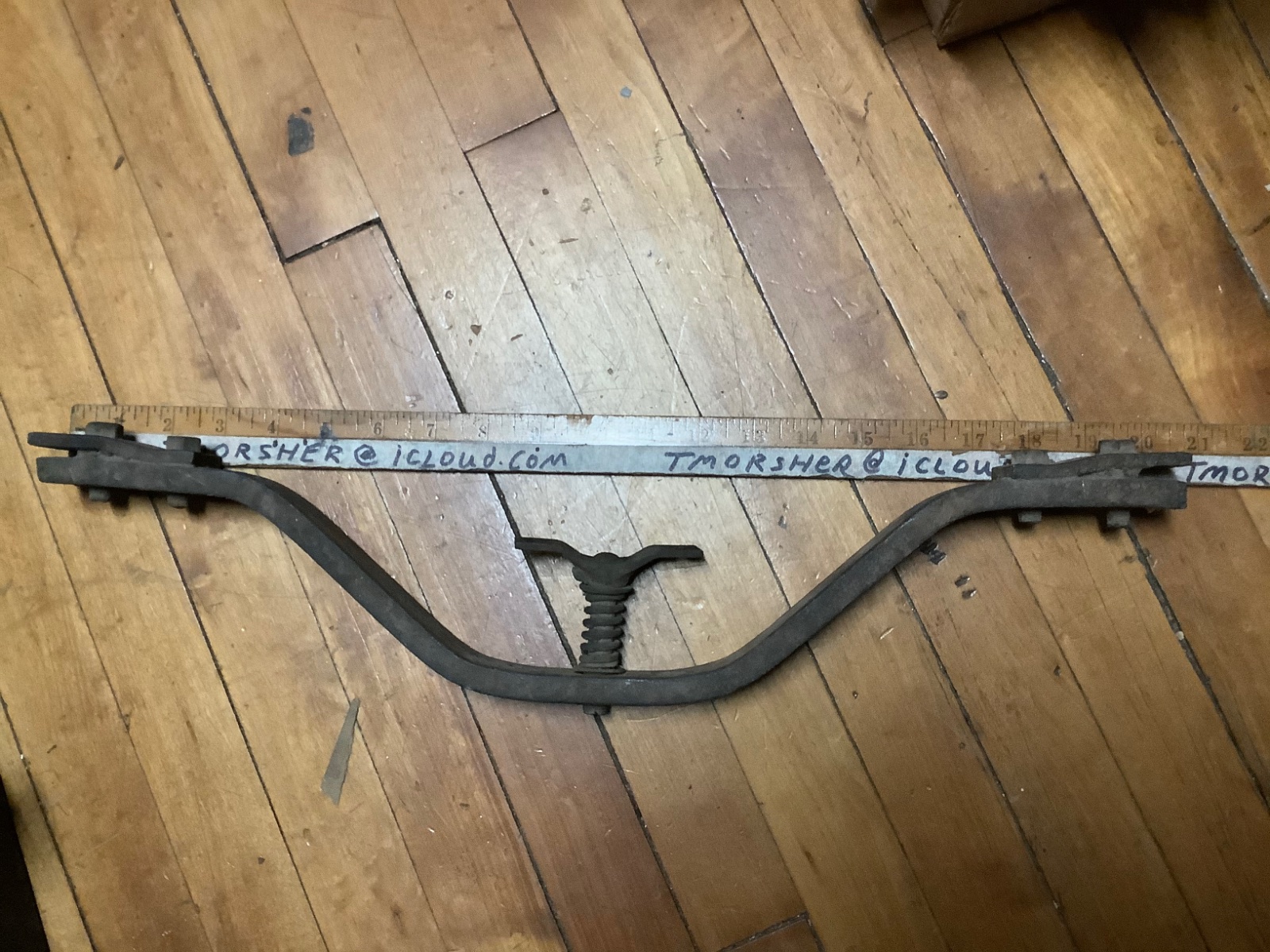

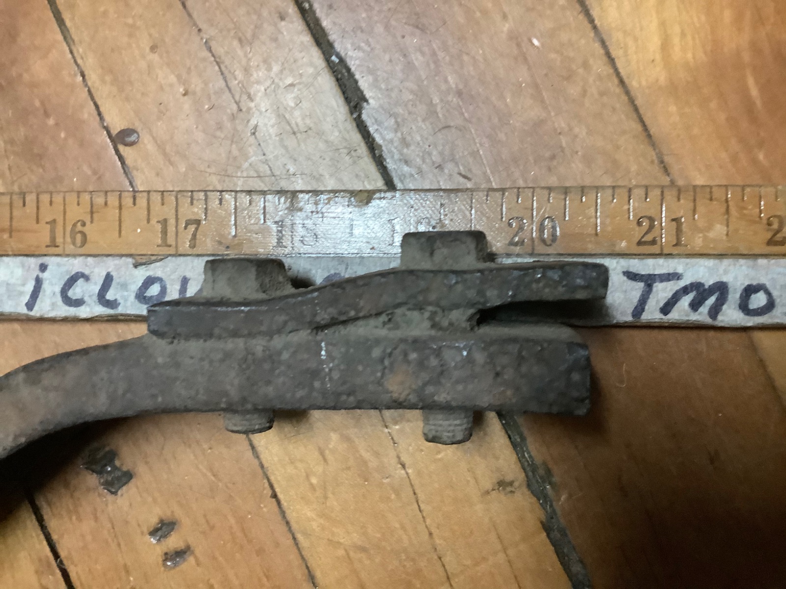

Bill, I think this is for the Jumbo. I kept it to modify for my chicago trans. If you need further info, just ask. The channel is 1/2” x 1 1/8” It’s an uncommon size, so probably 1/2x 1 1/4 or 1 1/2”would be Aok, IMHO
Dropacent
Posts: 3384
Last Name: Morsher

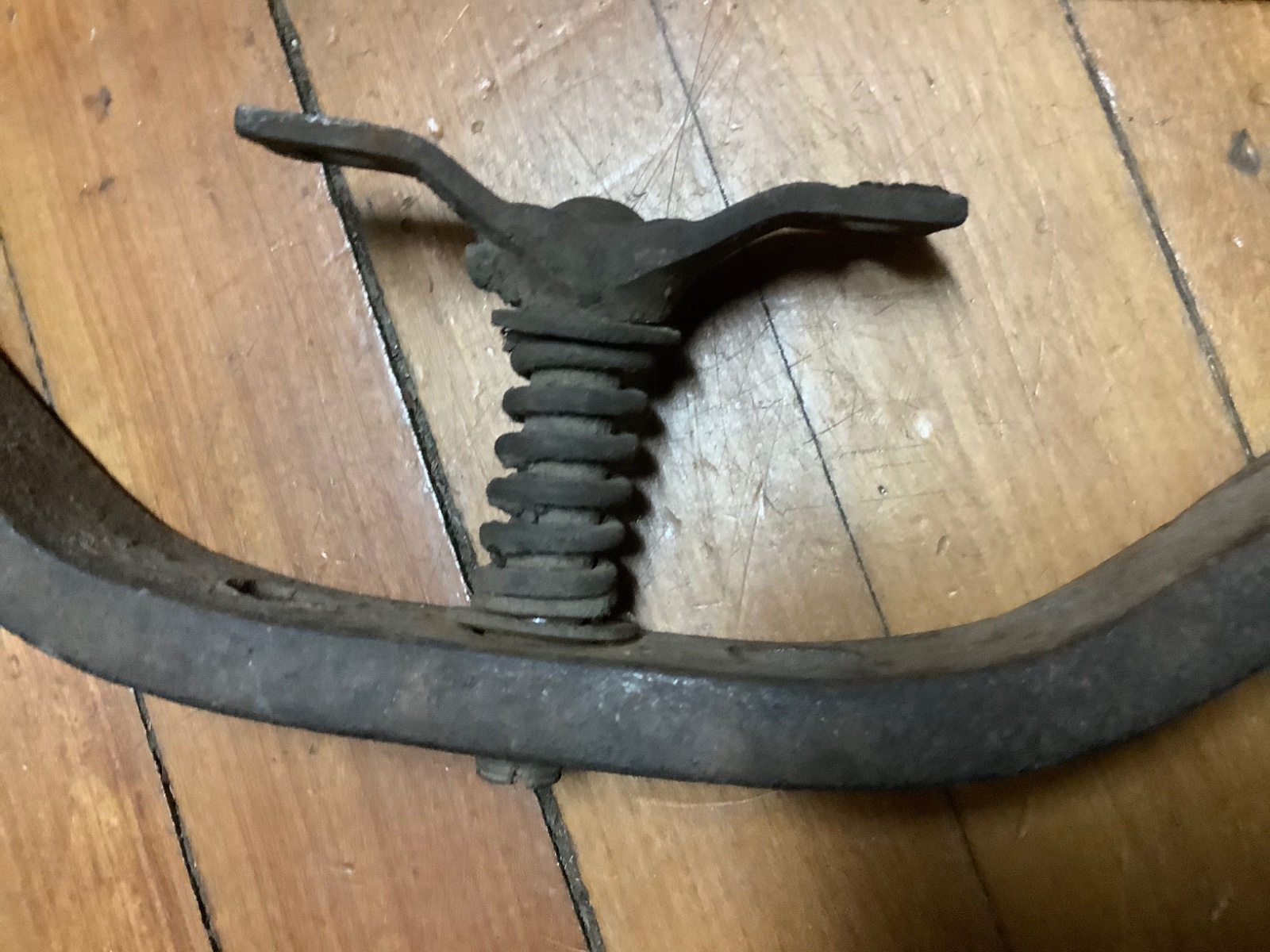

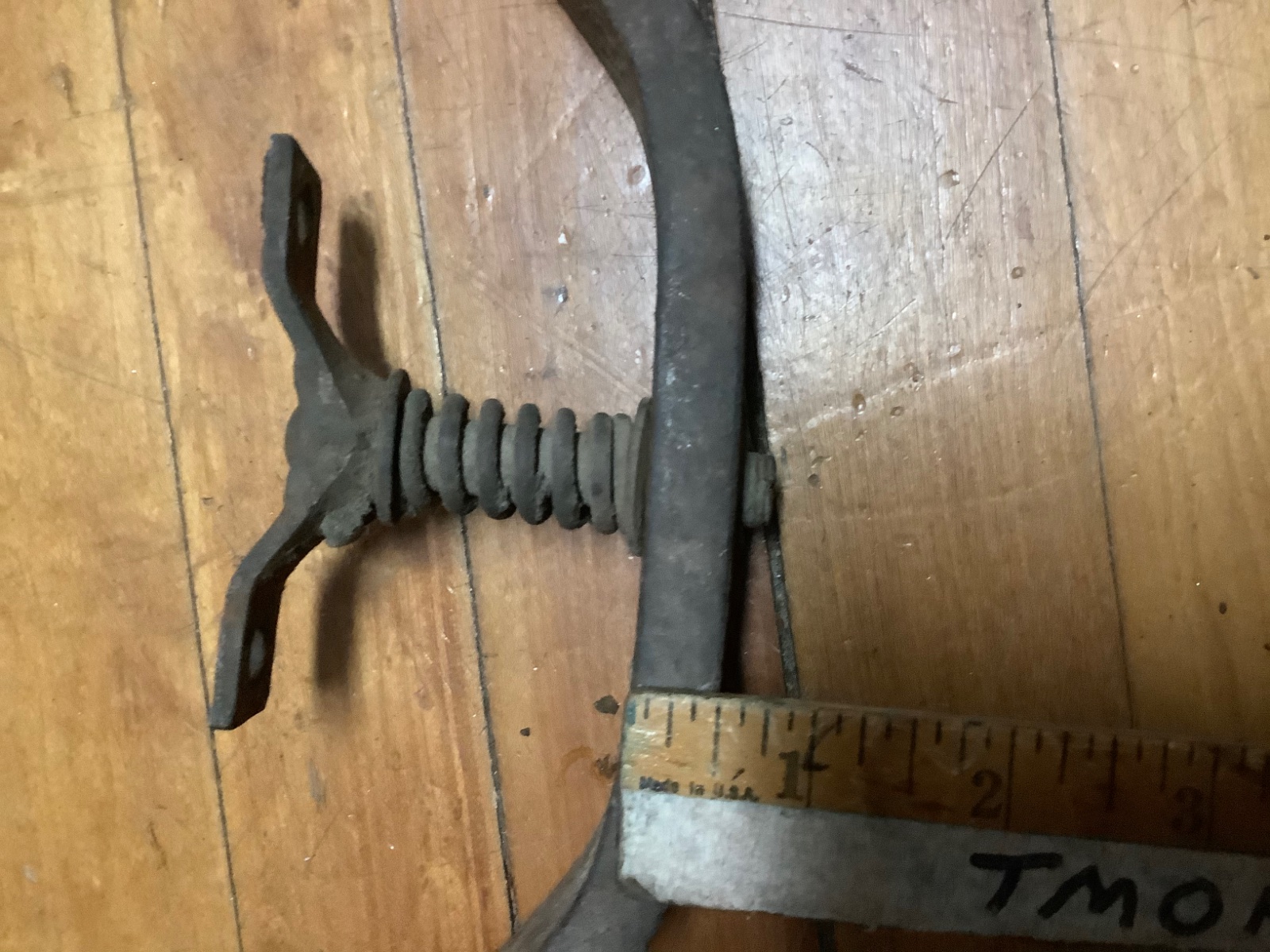

Post by Dropacent » Wed May 20, 2020 4:47 pm

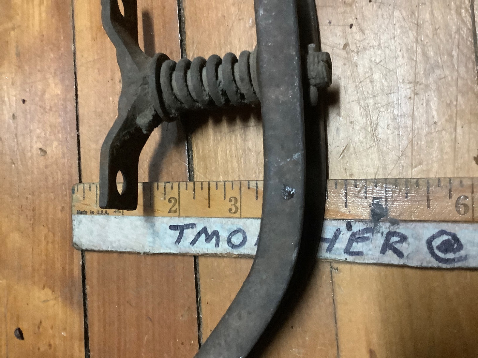

More pics
Dropacent
Posts: 3384
Last Name: Morsher

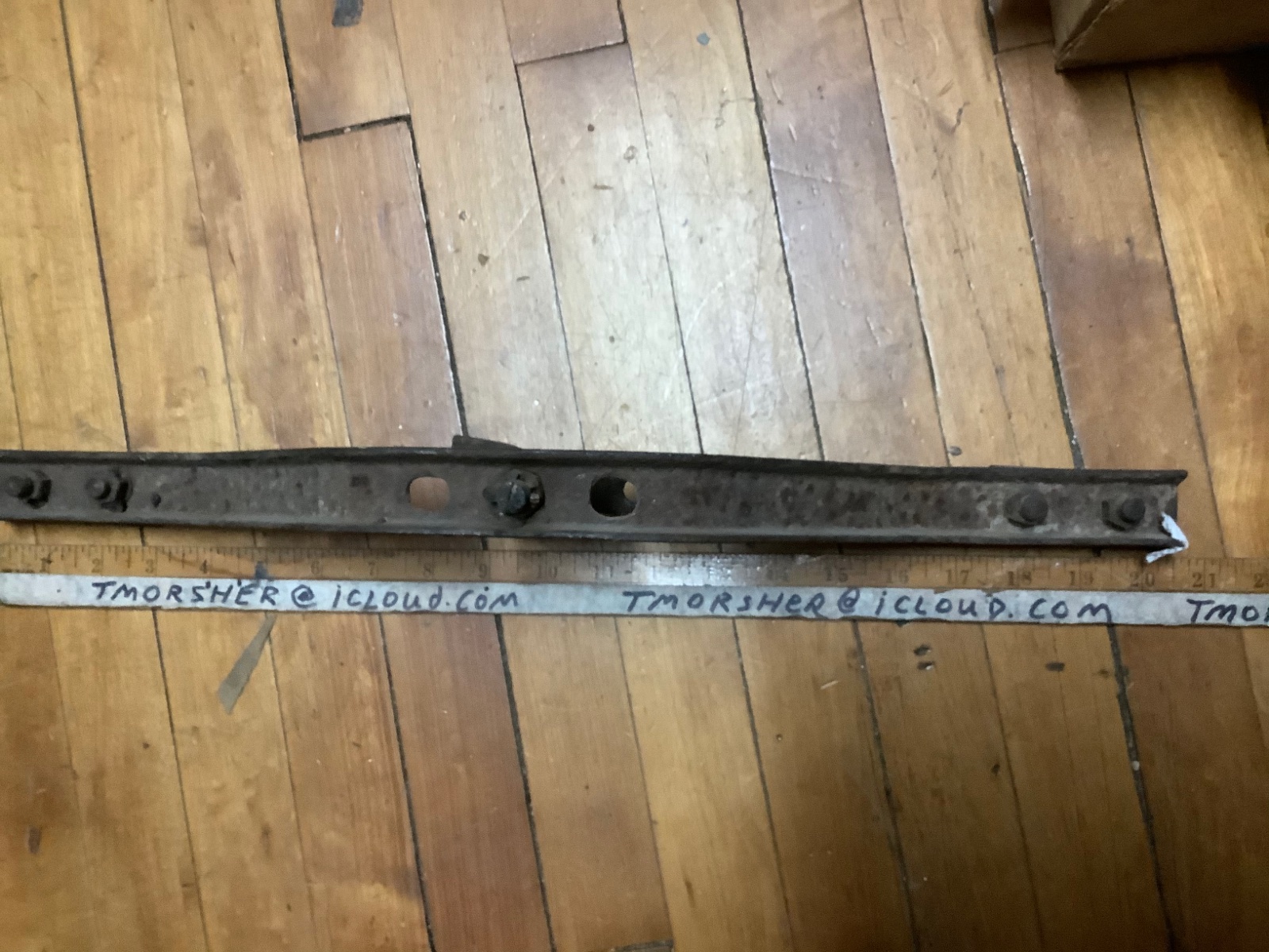

Post by Dropacent » Wed May 20, 2020 4:48 pm

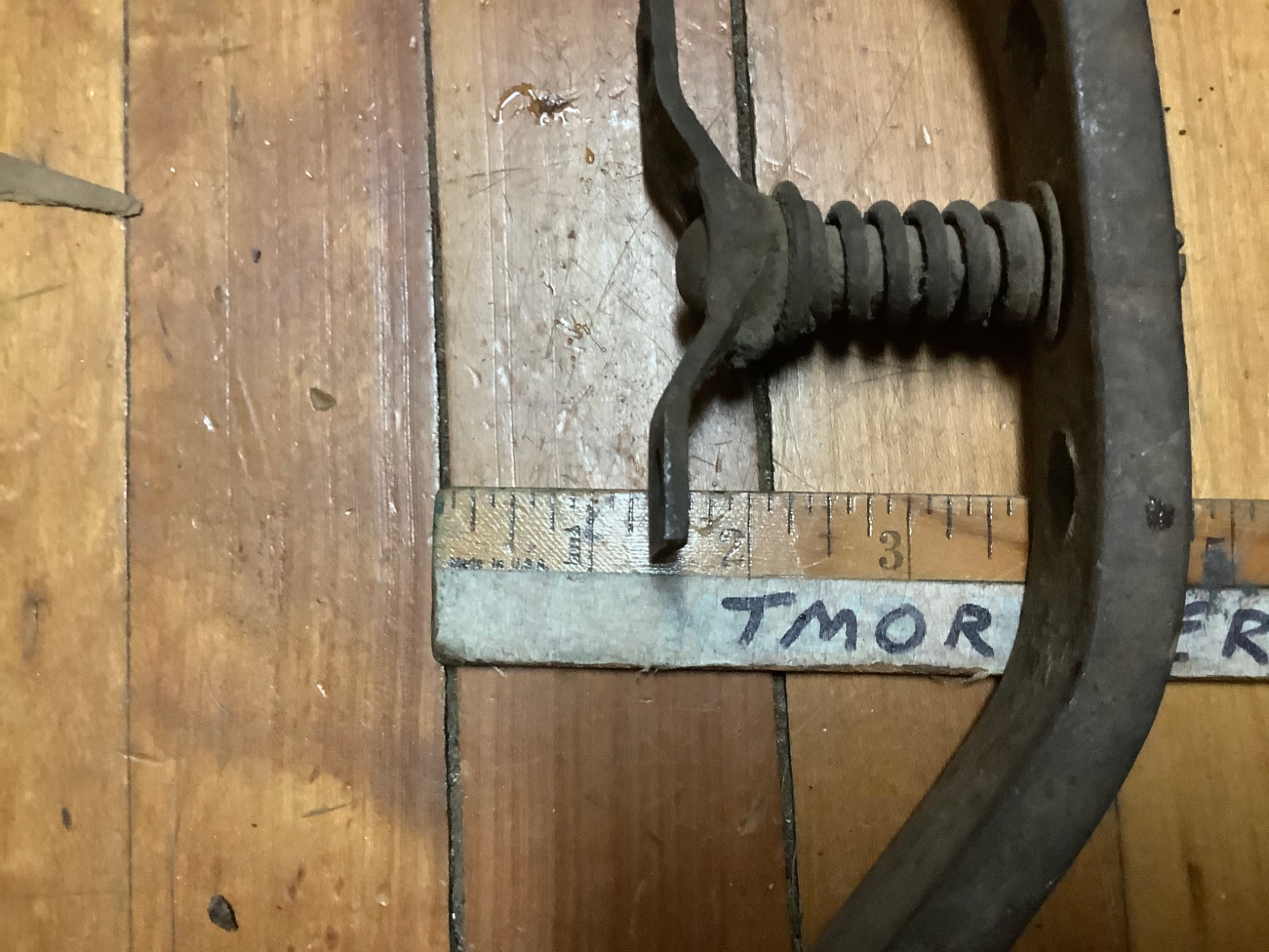

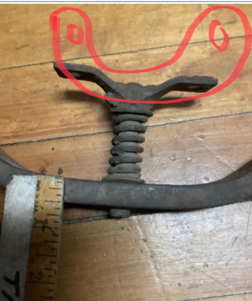

Remember , Steve. I think the one I’m showing is for Jumbo. I snagged this picture of a Chicago Mark E brace.

I think a simple mod like this will get us Chicago owners in the ballpark.
