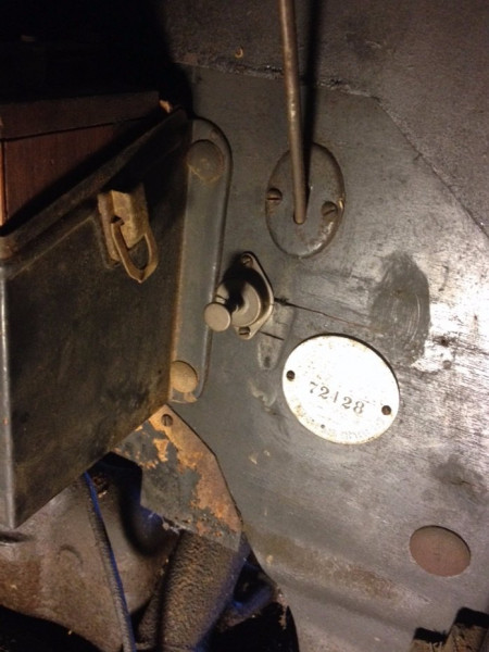

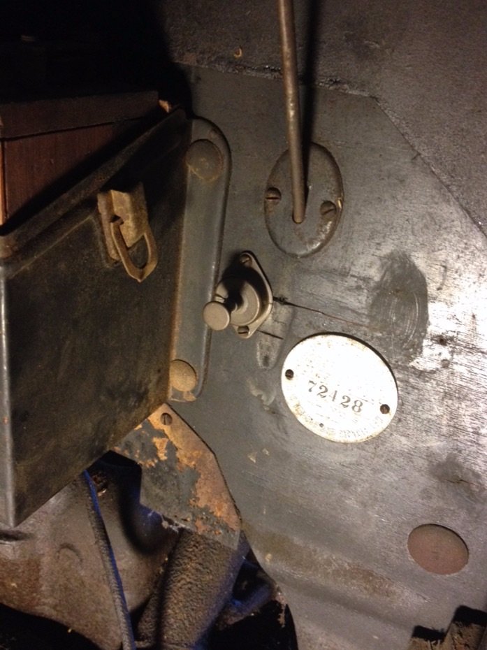

Here’s a photo of the firewall put back together. The cab control rod was much closer to the switch than the drawing. The cover plate had a flat cut into it and it now lines up nicely with the switch. I’m thinking it was built this way. Car build based on engine sn is dec 1914.

Sorry, but one more question. Should the brass plate on the coil box be black paint with brass letters? I’m thinking someone polished the paint off.
Thanks for the help.
Jeff
Jeff
- Posts: 5608
Re: 1915 headlight switch hole size
No paint on switch cover.

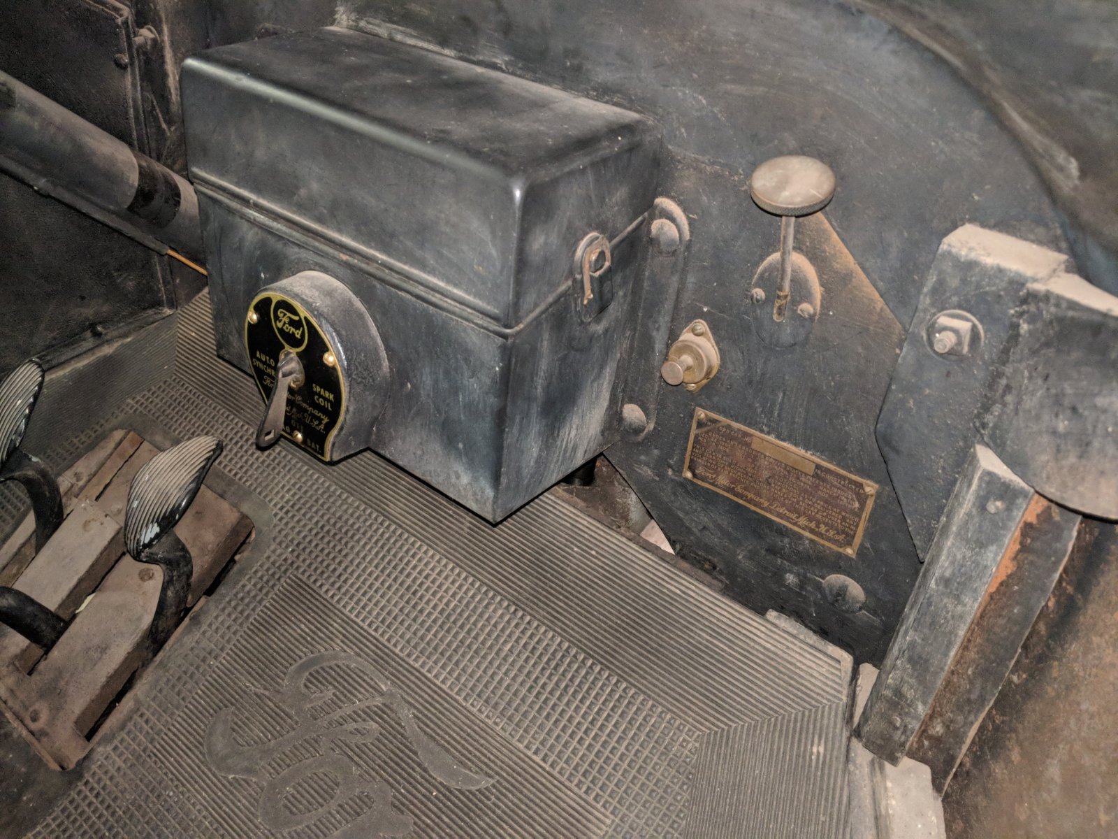

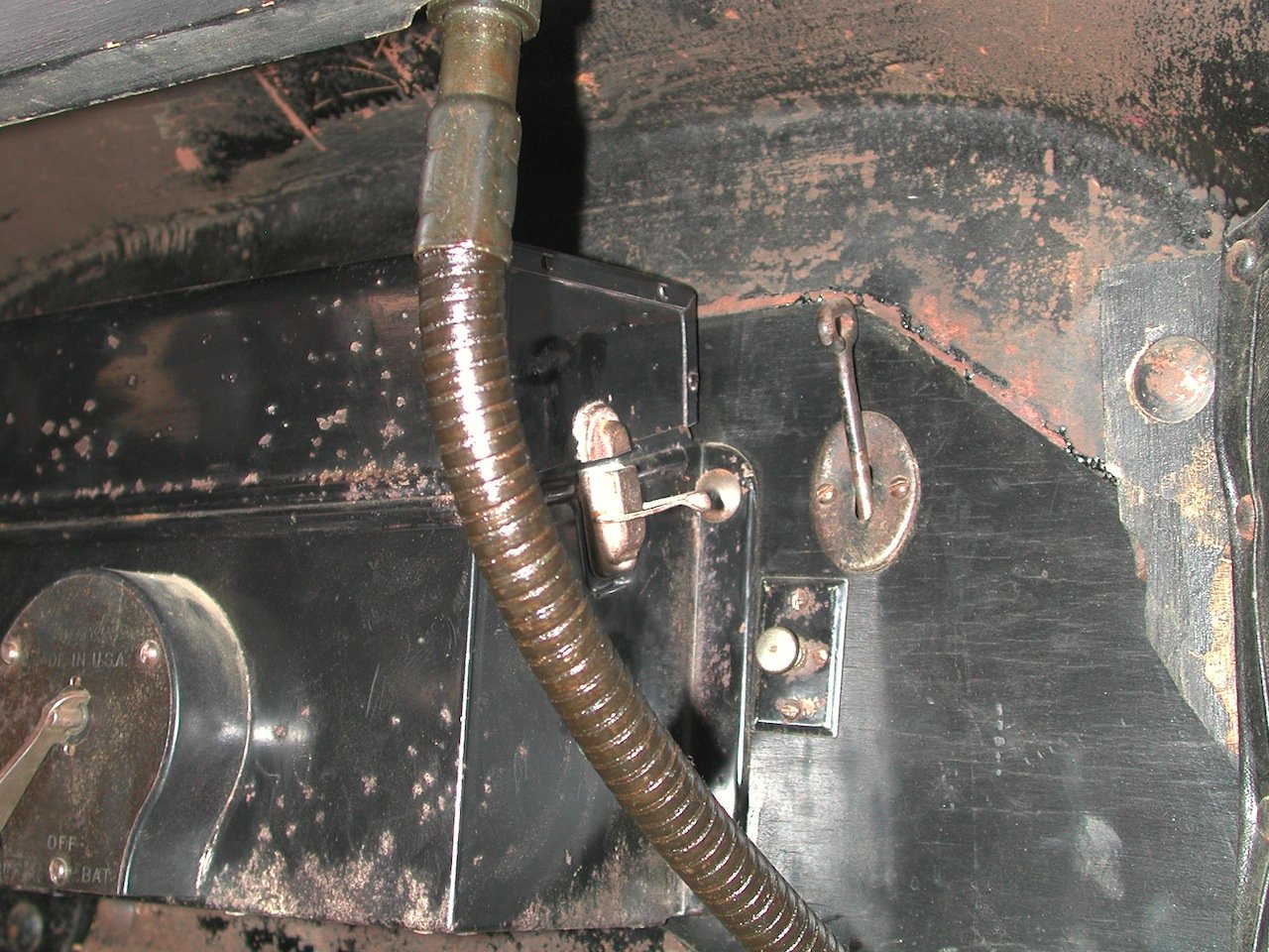

There should have been no need to cut anything. If that firewall is original to the car, if you strip the paint you may find the correct locations.
First photo is of Paul Iverson's unrestored 1916 touring. It is a very good example of a complete and unrestored car. Note that it has the "round" light switch but the location is the same as if it were the rectangular switch.
The second is of the unrestored 1917 "Rip Van Winkle" touring. The measurements/locations for the light switch and choke rod should be the same as 1915 and 1916. I have an unrestored 1917 roadster and the locations of the switch and carb rod plate are the same.
