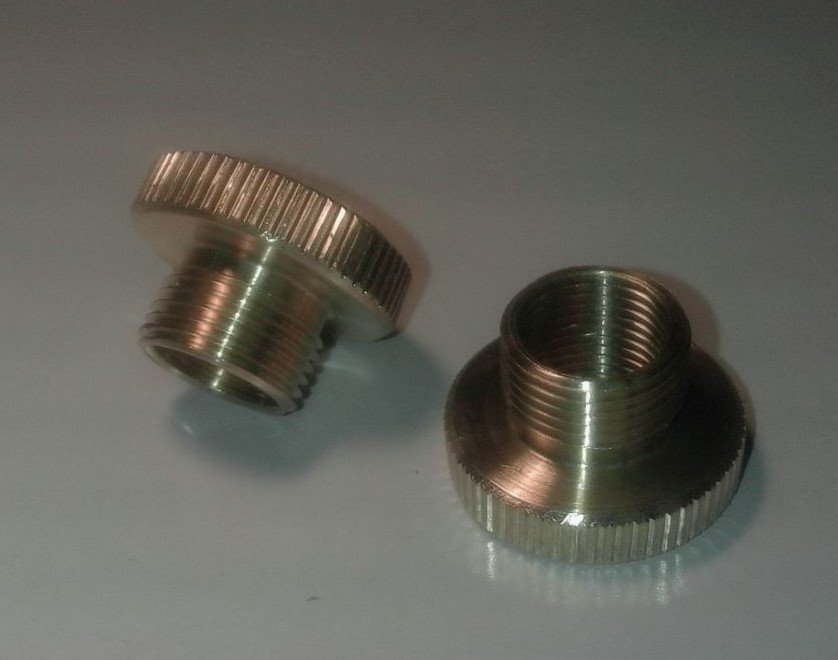

This is for those who really care about authentic parts. The early round serrated rim nuts are now being made by Dan McEachern in Alameda. He sells them for $20 each. He went to a lot of work to make them for us.

Thanks Larry! And of course RV for making the dies. Here is a picture of the early rim nut.

Post by CudaMan » Tue Aug 04, 2020 1:15 pm
Neat rim nuts! Are they solid on the bottom, or do they have a pocket for a leather washer like the hex ones have?

Post by Dan McEachern » Tue Aug 04, 2020 1:21 pm
These are exactly like the originals in every feature. Larry has even blessed them as being correct!

Thanks for the kind words Dan. Dan doesn't include the leather washer. As I recall, I had to find an 11/16" punch to make them, and used a 3/8" for the center. I don't see how anyone that is familiar with Dan's work would even think they would be solid on the bottom!
