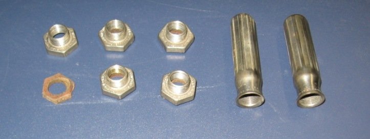

This is for those who really care about authentic parts. The early round serrated rim nuts are now being made by Dan McEachern in Alameda. He sells them for $20 each. He went to a lot of work to make them for us.

Thanks Larry! And of course RV for making the dies. Here is a picture of the early rim nut.

Neat rim nuts! Are they solid on the bottom, or do they have a pocket for a leather washer like the hex ones have?

These are exactly like the originals in every feature. Larry has even blessed them as being correct!

Thanks for the kind words Dan. Dan doesn't include the leather washer. As I recall, I had to find an 11/16" punch to make them, and used a 3/8" for the center. I don't see how anyone that is familiar with Dan's work would even think they would be solid on the bottom!
